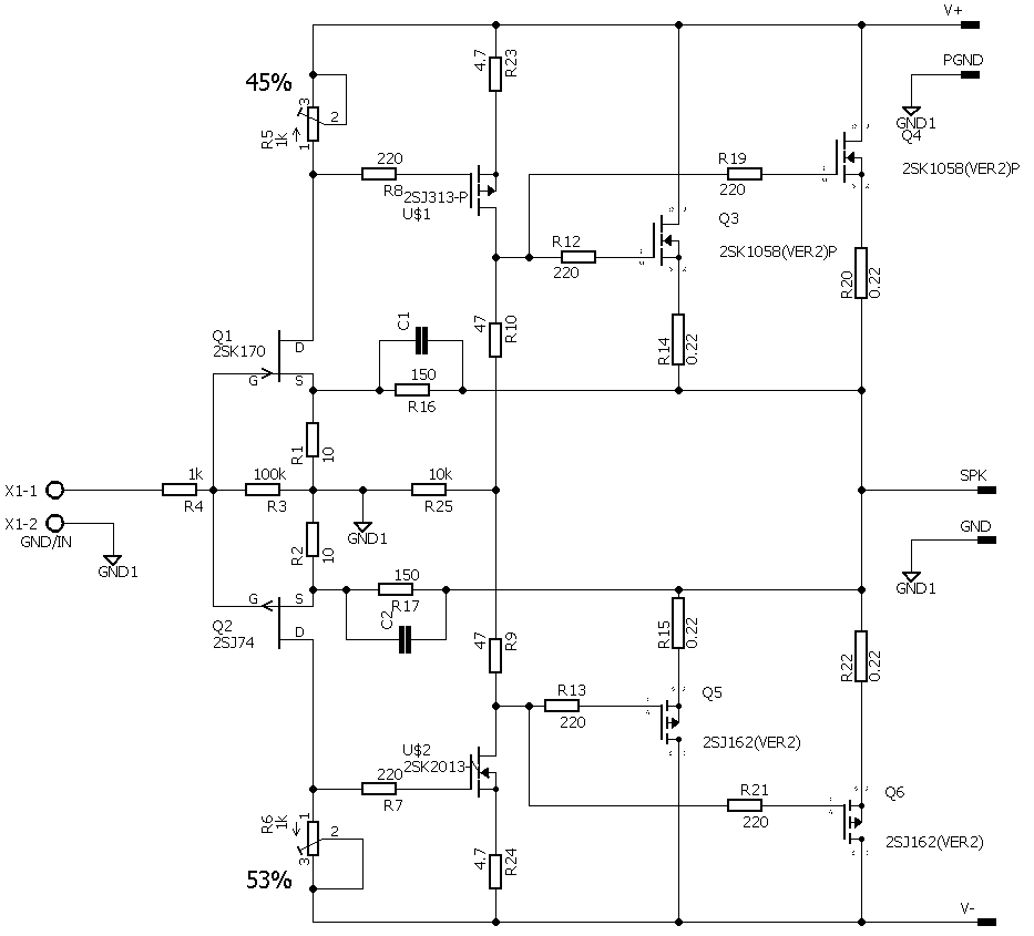

I am drawing this in Sprint6 and notice that the schematic says +24/+24. Is this an error? Is the lower rail -24?
Thanks, Terry
Thanks, Terry
Terry, where did you see such a schematic (post#)?I am drawing this in Sprint6 and notice that the schematic says +24/+24. Is this an error? Is the lower rail -24?
Thanks, Terry
Terry that is correct, Juma marked those capacitors polarity, nothing wrong with that. Not the usual but still correct!
Happy New Year to all!
Excuse me.+25V/+25V. Post #1
I don't see that. Amp's upper rail is +25V (plus pole of V2) and the lower rail is -25V (minus pole of V3) with minus pole of V2 and plus pole of V3 connected to GND. Nothing unusual there... 😕
Maybe you shouldn't rush into building this one before reading the whole thread, there are couple of things one needs to understand in order to build it properly.
Sorry. I just realised those are voltage sources. I did read the whole thread.
I'm not planning to build this amp. I was just drawing it so I could give him some pdfs for etching.

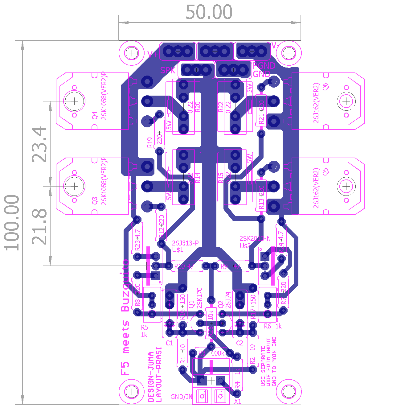

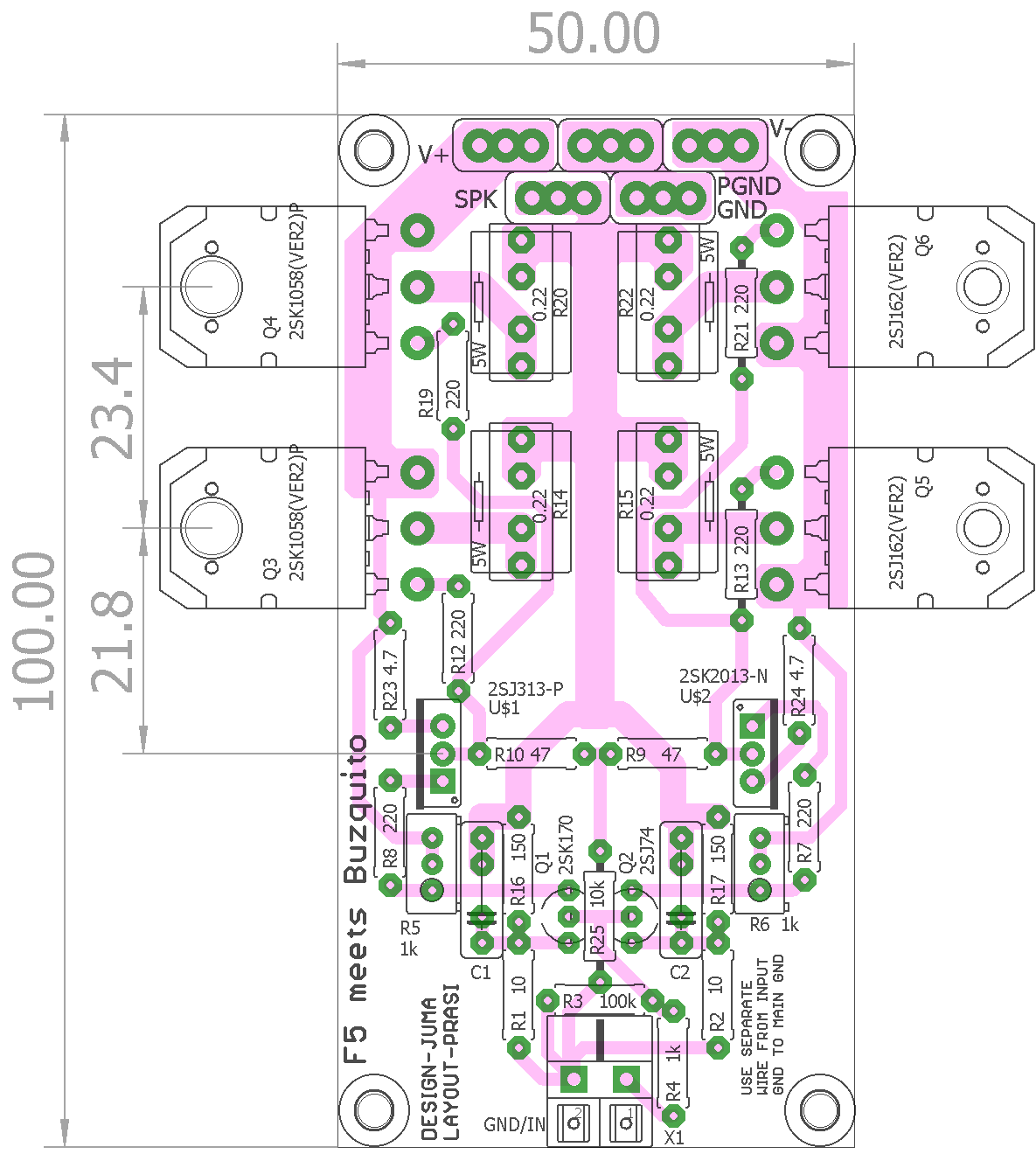

Hi Juma,
here is a layout that i did,
questions
1. is it ok to mount 2sj313 and 2sk2013 on main heat sink?
2. is the distance between o/p mosfets ok for proper dissipation?
3. can one use 0.33 ohm resistors for R14/15/20/22?
the second pic is for people who prefer high contrast.
all views from component side..
questions
1. Yes
2. No, except if you want to make a different amp out of it by biasing the output stage low. The layout in post #1 is better.
3. I would rather use 0R1 and select output mosfets from same batch to avoid current hogging
I would also change the biasing scheme to make it resistant to current changes in second stage
Could you elaborate on this please?

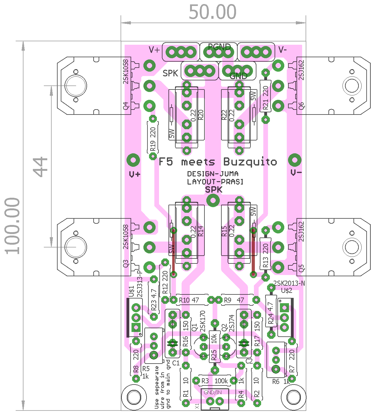

2. i see that you had kept 45mm and 50mm between mosfets, i was able to manage 44mm between o/p mosfets. is it ok now? I agree inline mosfets dissipate heat better, but 100mm PCBs are cheap to make😀.
3. i don't know if i will get the mosfets from same batch, so will stick to the 0.22 ohm source res.
4. if you ever work out a new biasing scheme, i will incorporate the same.
5. Is it important to take individual feedback from the respective source resistors of Q3 and Q5 for R16 and R17 ? shown below.

2. It will work
3. Simple Id vs. Vgs measurement will show if there are big differences between paralleled mosfets. The lower Rs, the better
4. That will have to wait...
5. Ok
5. Ok

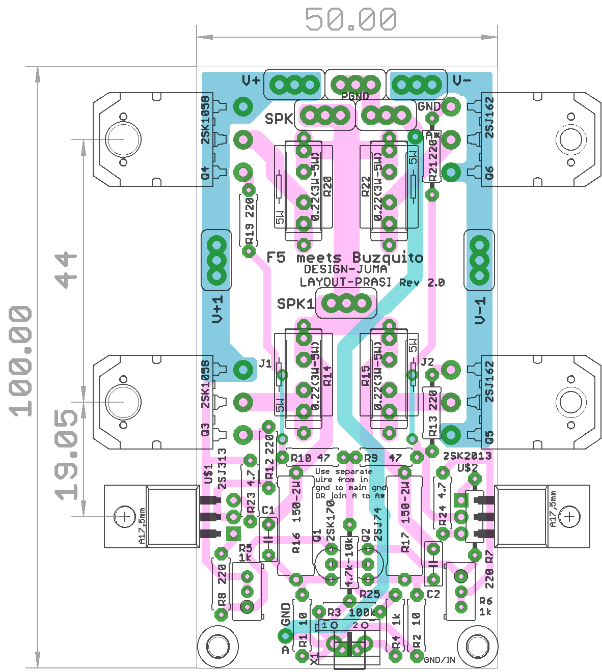

Here is the final layout for anyone willing to build, compatible with single sided home etching or double sided PCB manufacture.
For double sided
1. V+ and V- rails are on both sides.
2. Input ground is connected to PGND. (in case of single sided PCB one may use a separate wire.)
