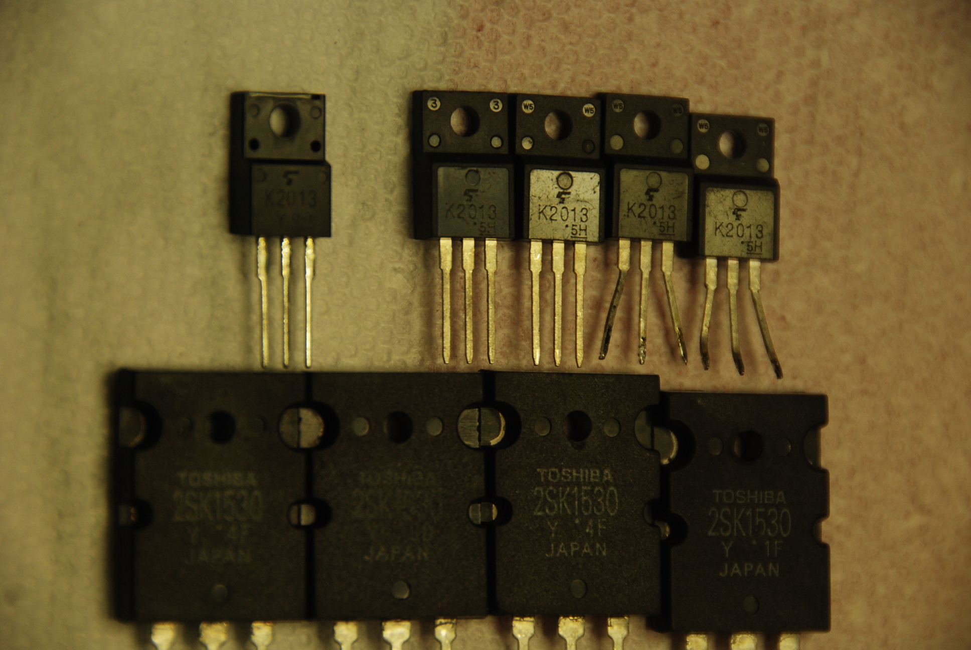

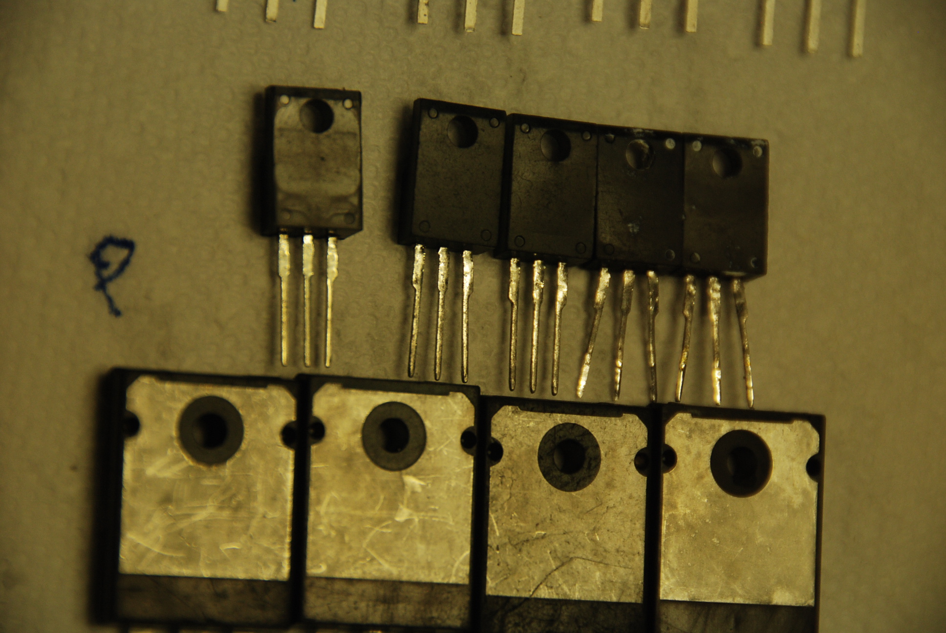

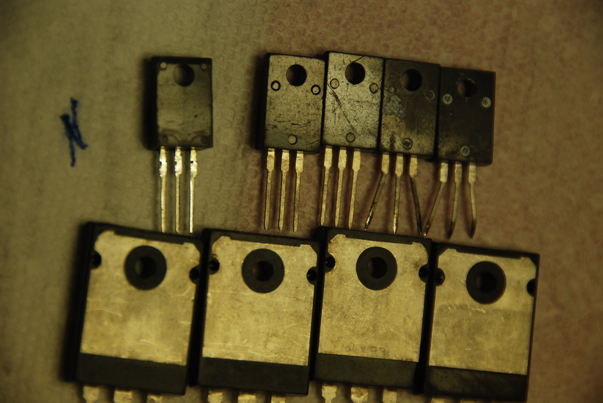

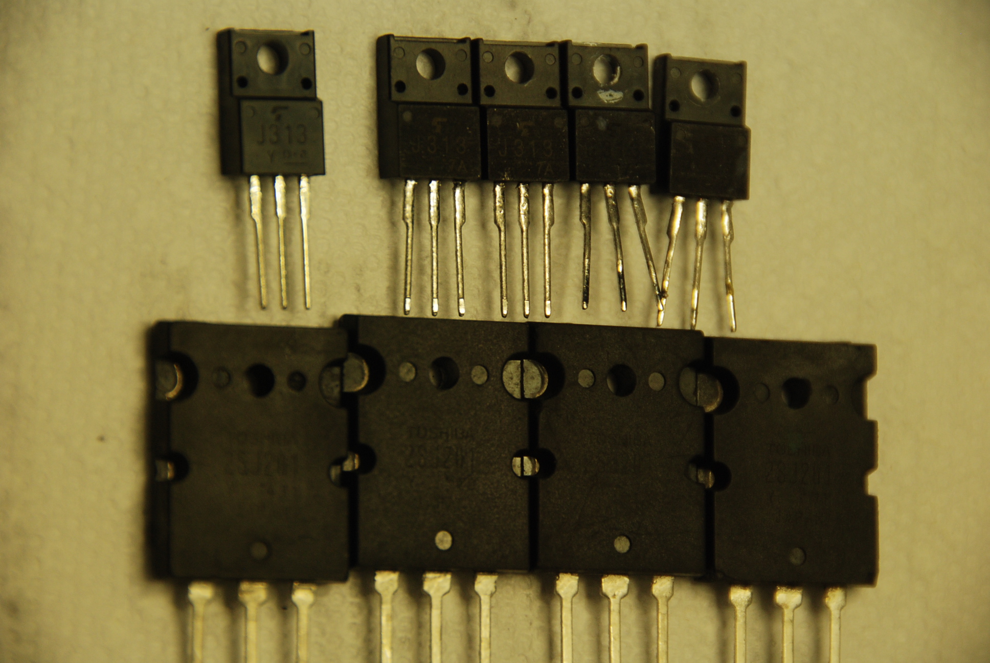

FAKE PARTS
Not the best photos.
The real 2SK2013/2SJ313 from Zhou Fang are the single on the left.
I don't have any real 2SK1530/2SJ201 to compare.
The "P" are sanded and restenciled, can't tell what they did to the "N".
utsource offered me $8 refund on the $67 order. $2 each for the 2SK2013/2SJ313 and $5 each for the 2SK1530/2SJ201 plus $3 PayPal.
