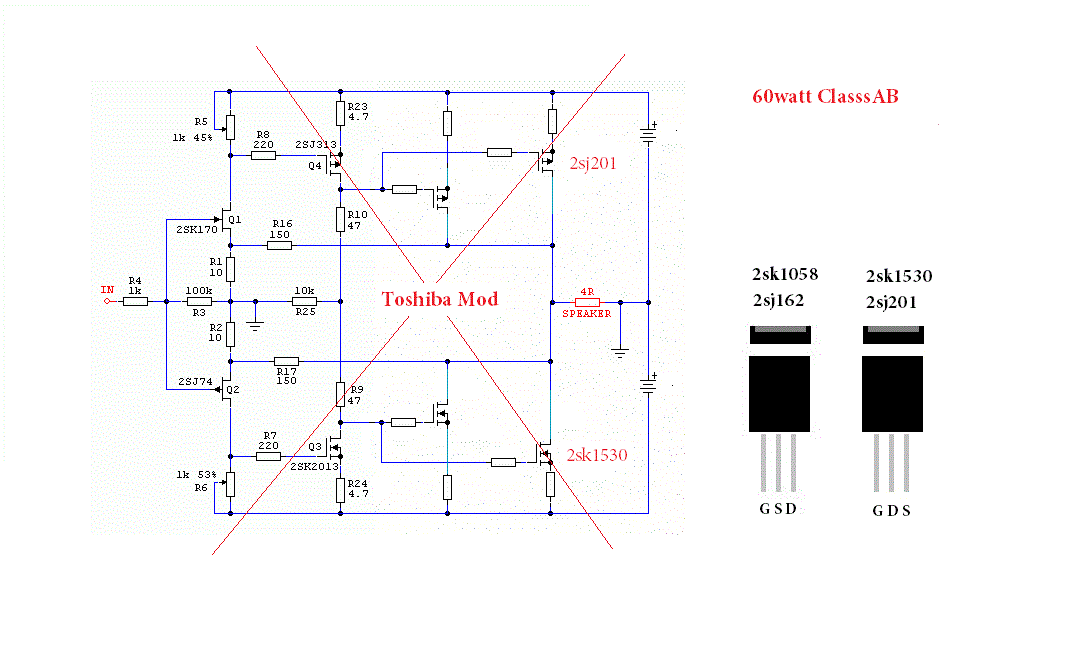

Greetings. I was searching for a power amp to build. I like JFET input stage and I want to use Lateral Mosfet for output. I found Zenquito then this one using K2013/J313 as VAS. Everything fits the bill. This seems like another gem of yours. 🙂 Hard to believe this thread was buried this deep.

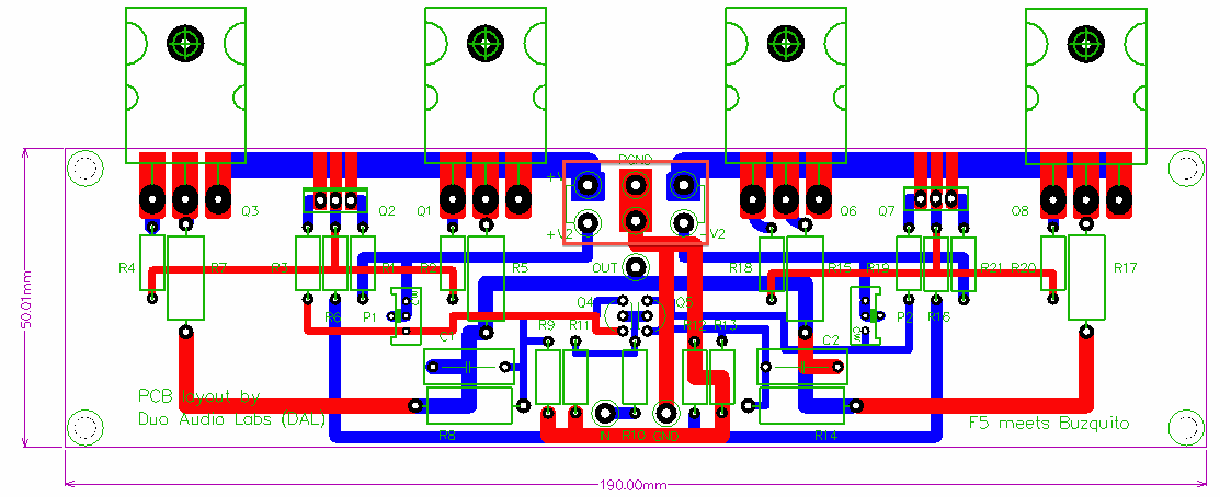

My diy buddy helps draw a pcb for this version of F5 as the attachment. Do you think it worth using regulated ps for input and VAS stages?

Built the amp. Worked very well, sounded very nice I've asked my friend to rework the pcb layout for 3 pr of output devices, cascode the input stage, balanced operation, and etc. 😀

Sorry, forgot the attachment

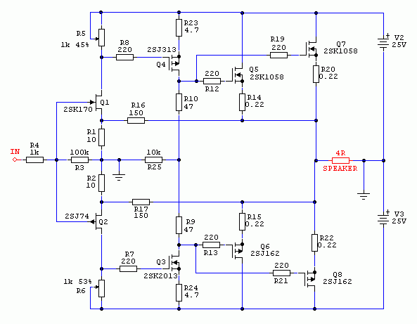

is that a cascoded input for higher voltage/output ?
while you're fresh with it - will you try it in B class ?
...... with small bias current the amp sounds a bit "thin". With 0.5A it's really good and marginally better with 1A per MOSFET.
if lower bias current, maybe it would help with higher voltage
Yes, it's so that I can use higher voltage supply for higher output with 1.2A~1.5A bias.
would it work in high biased class AB
it will
remember original Hitachi schematics , and all other derivatives .......
it was just a thought i got after i decided to invest in some of those lovely 'leftovers' from the big F5X project
nice jfet input, the finest drivers, and the great Toshiba outputs
beware of output mosfets polarity !
(sources to out )

ahh, completely forgot the higher +/-40V means cascoded jfets
but lots of info available on that
