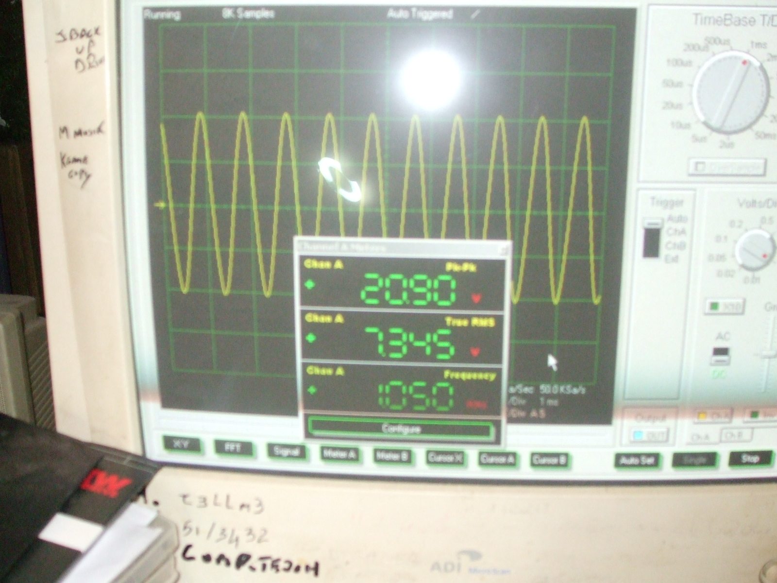

If you have a scope put it on the output of the amps while the speakers are on and notice if you are clipping on peaks?
To determine the clip point you'd merely have to put the scope on DC and touch the rails, the point that the scope moves to is "peak". After that you can put the scope back on AC if you wish (assuming a centered trace to start with) and watch.
If you are clipping then you will get somewhat different sound depending on bias point, and lower bias point is closer to class B, so there is more total swing available, slightly more headroom...

I realy apreciate your imput and I am working on the same line you suggested.
I have taken a quick mesurament with a cheap and nasty USB scope
and had same results on cheap and nasty normal scope.
The F5 is connected to a pair of Gale Monitor Gold (my near field loft monitors)
Those are 4 homs speakers as the Polks.
I have pushed the F5 up to 20 V peack on a 1Khz sine and from what I can see is not clipping.
I believe Papa said the F5 will go at about 2 volts to the rails before clipping.
I am quite nutral in the camp of mesurament against listening and think that both are quite valuable.
I was Just wandering what the consensus is in "pure listening" as Papa opinion is quite clear>Quote (as I remember so don't shoot)

Ok I supose I could try that.
but is a bit difficoult to see musick signal clipping unless the output get to about 2 V from the rails.
As real listening goes I think that with the knob set at neigbours and Her out and me having a party say 12 maybe 14 V peacks IMO I am still in a preaty clip free area.
Same maths
Which is most probably wrong so please ceck me out
W = VXV/R 14X14/4=49
I = W/V=3.5
As bias is set at 2.4 and current to speakers is 2 times Bias I am still safe from class B not that I could distinguish any difference in class B at that level
You only have to note the where the amp's max swing on the scope is.
One can also increase the gain of the vertical input then offset the position and then you will only be looking at the area where peaks occur... 😀
It is sufficient for the most part to watch only one rail, or one rail at a time, if that makes it easier to see the peaks...
Then play at normal listening levels and see where the peaks go.
It's imperfect, but you can swing the timebase around and see what the lows and then the highs are doing.
It's where the peaks are at levels that you actually listen at that counts.
But having said that, the amp seems sonically sensitive to almost everything you do, including resistor choice, so there may not be one single "F5" at all - we all may be listening to a completely different amp!! 😀
