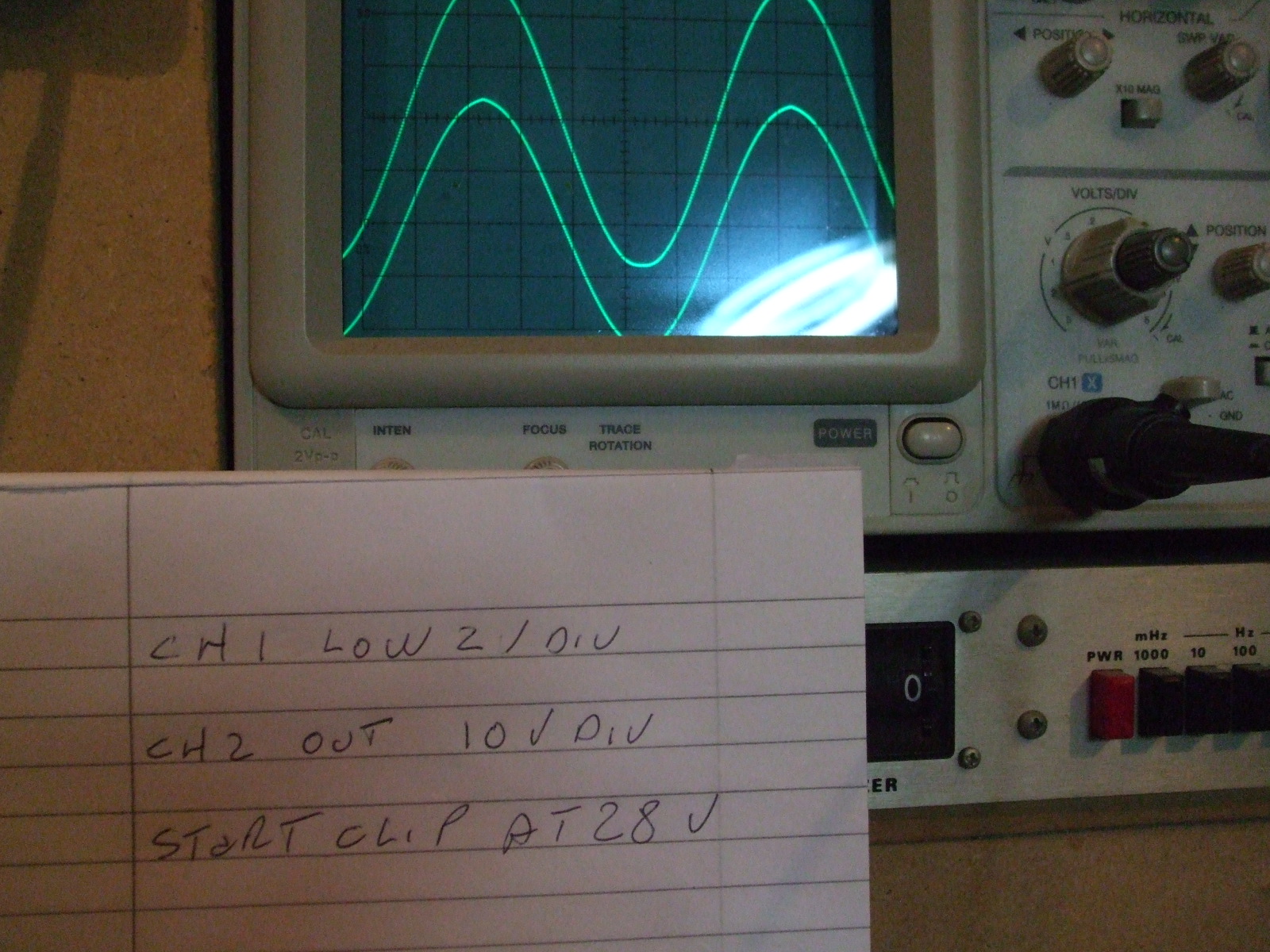

I just connected my amp up to my scope for the first time.
This amp does not have either the 10pf or 1nf caps suggested for stability and overshoot yet.
It seems pretty smooth sailing until it gets in the vicinity of the clipping voltage, then it rings like mad.

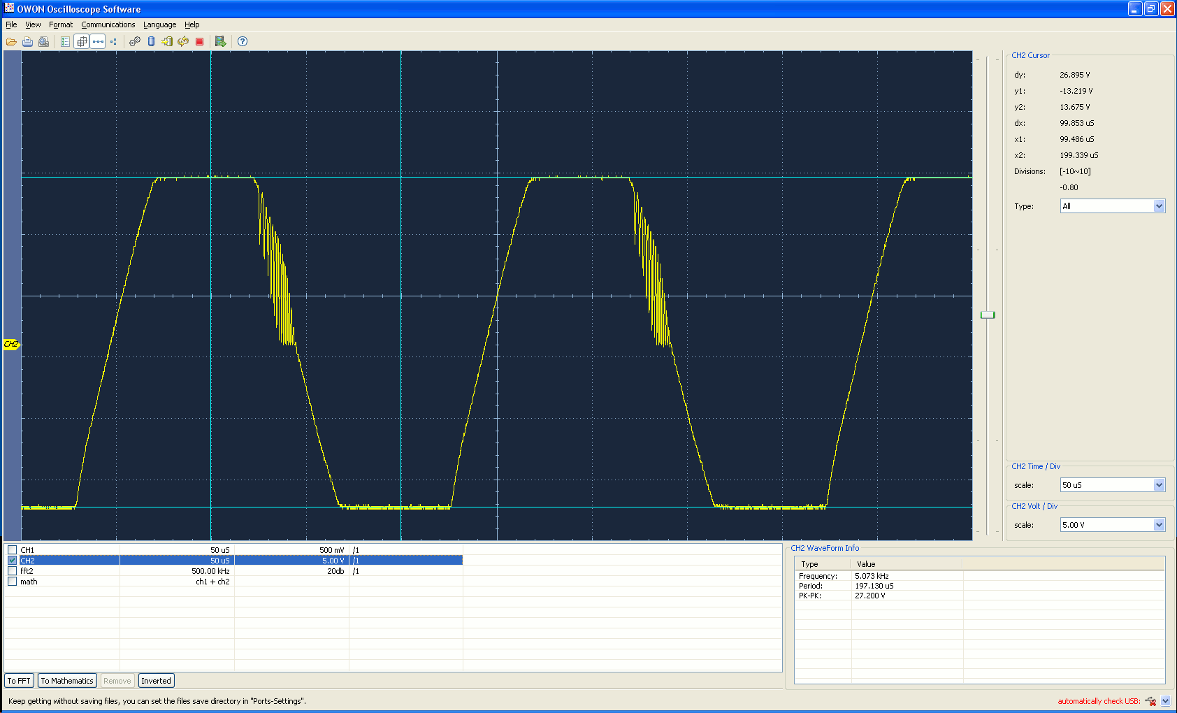

Square wave is problematic as I don't have the proper lead for my sig gen, just useing some lampcord. The signal and output overshoots, but the sqare looks ok if I test it at the output plug on the sig gen...
Anyway here is 26.895V into 8.2ohms (10W?)

Digits, that is parasitic oscillation.
Best to find the cause and fix it. Start with all the parts that NP suggests, then remove things you think might "help" the sound.
