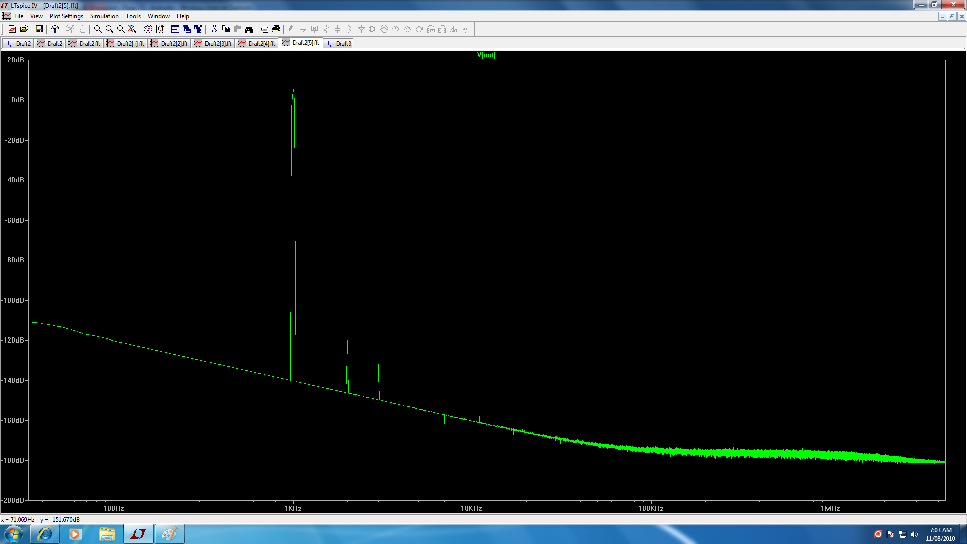

Just in case anyone is interested, here is fft of the first one.

The fft looks fantastic, 2nd ~-125dB and 3rd ~-135dB and no other detected harmonics.
I wonder what the real circuit does?
I will definitely take that as a compliment from you.
Yes it does look good.
I haven't built it so can't comment on the real world performance, but it is definitely one of the better circuits I have managed to put together (more luck than anything else, and I suppose a lot of persistance helps).

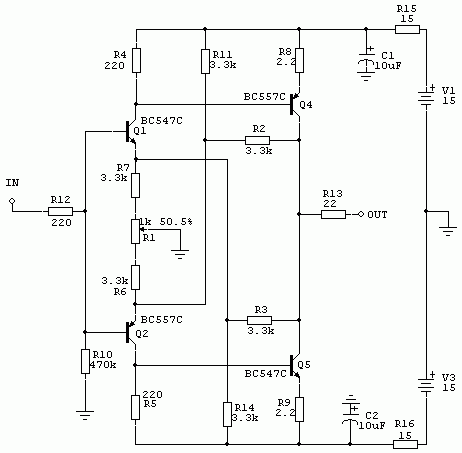

The first one simulates better, but who knows which one sounds better without actually building them.

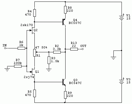

It looks interesting!
But it is not very far away from a JC-2, isn't it?
the j49 in the schematic should be j74.But it is not very far away from a JC-2,
j49 is a high power Lateral mosFET.
Depends, JC-2 Old or JC-2 New ?
I haven't built or tried to simulate that one. Do you feel it is a much better solution?

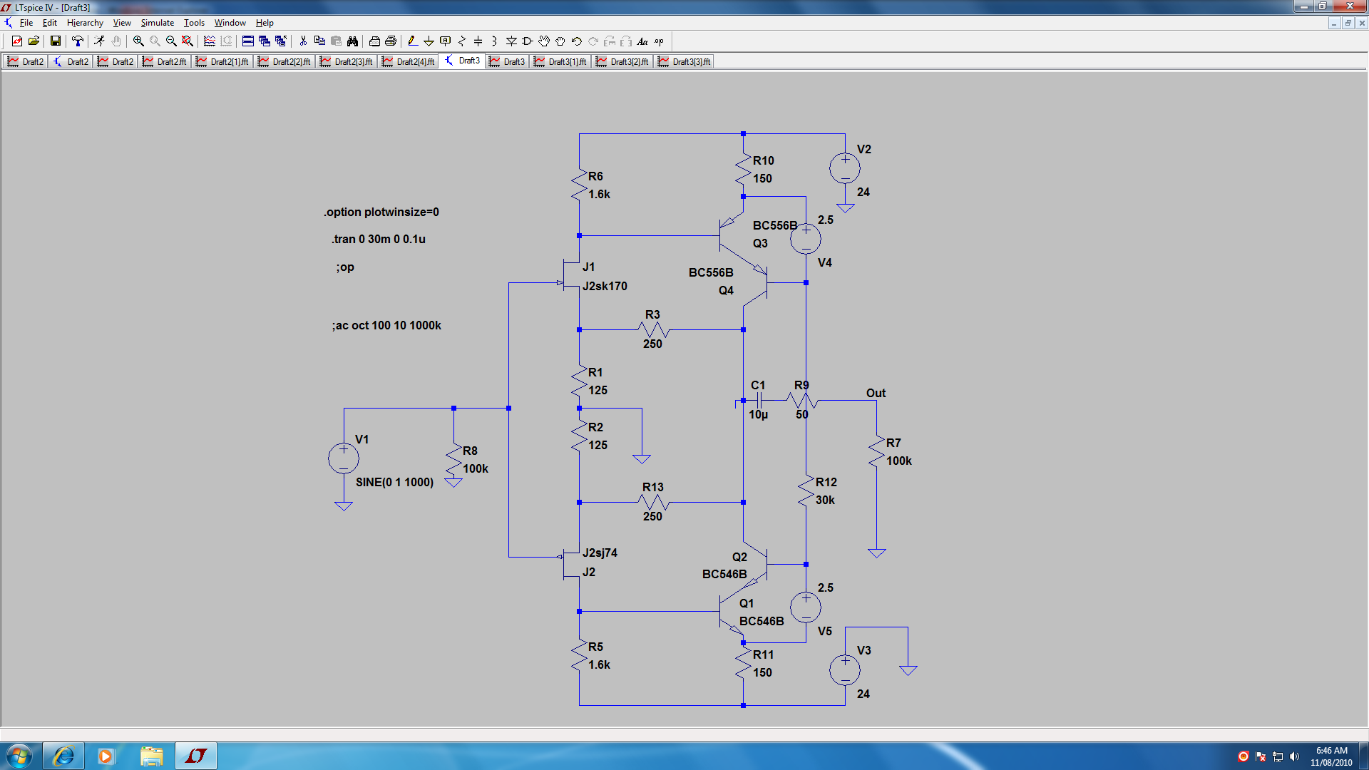

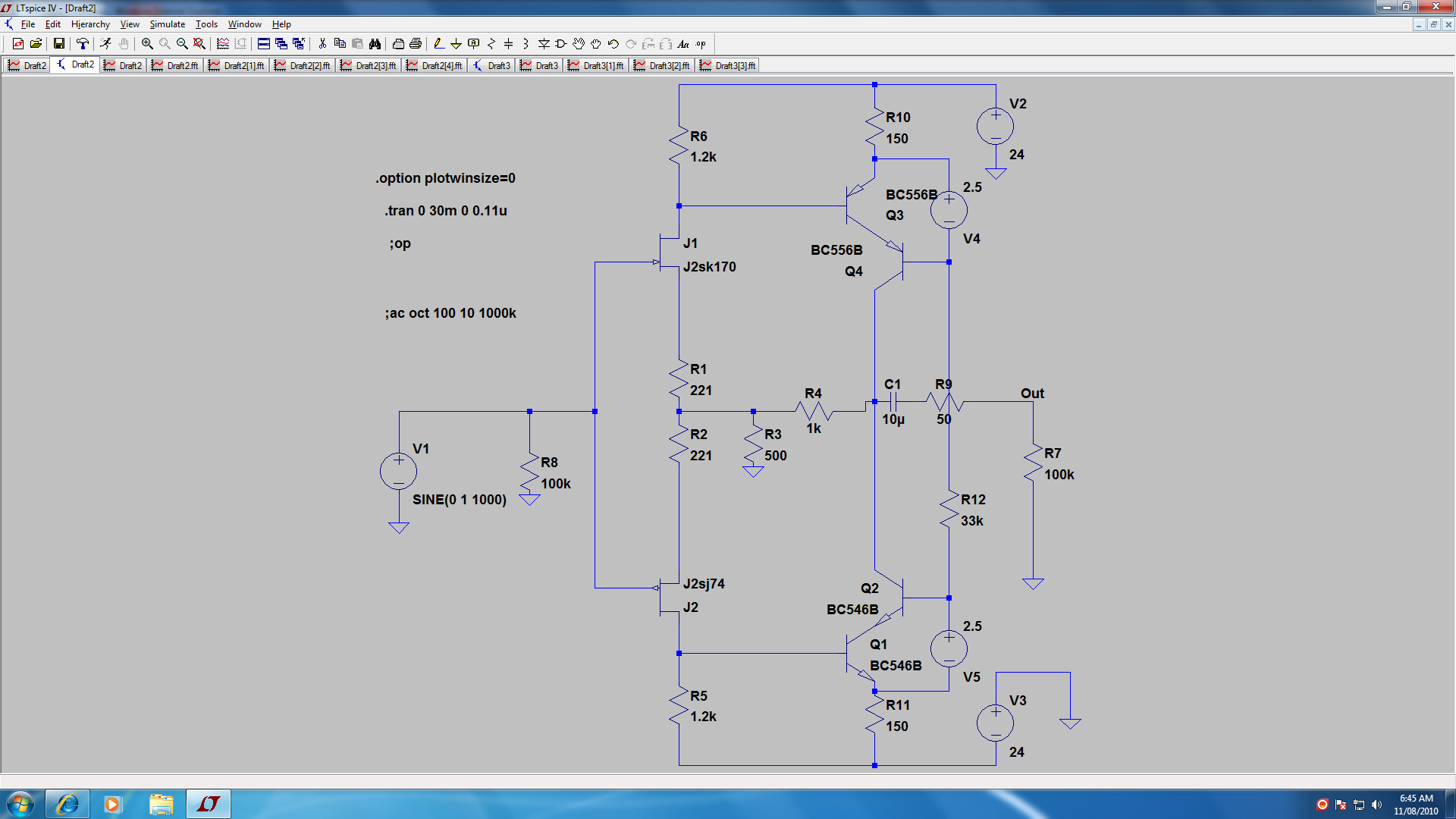

Umut wanted something that more closely represented the F5 topology in a preamp, but he asked for bipolars at the output, so that is what I tried to do. So the inspiration comes from Nelson's F5 and his paper on Cascode Amplifier Design http://www.firstwatt.com/pdf/art_cas_amp.pdf
... F5 topology in a preamp, but he asked for bipolars at the output...[/url]
Here you go - two versions, I like the second one more, but it's subjective. Both are easy and unexpensive to try...
