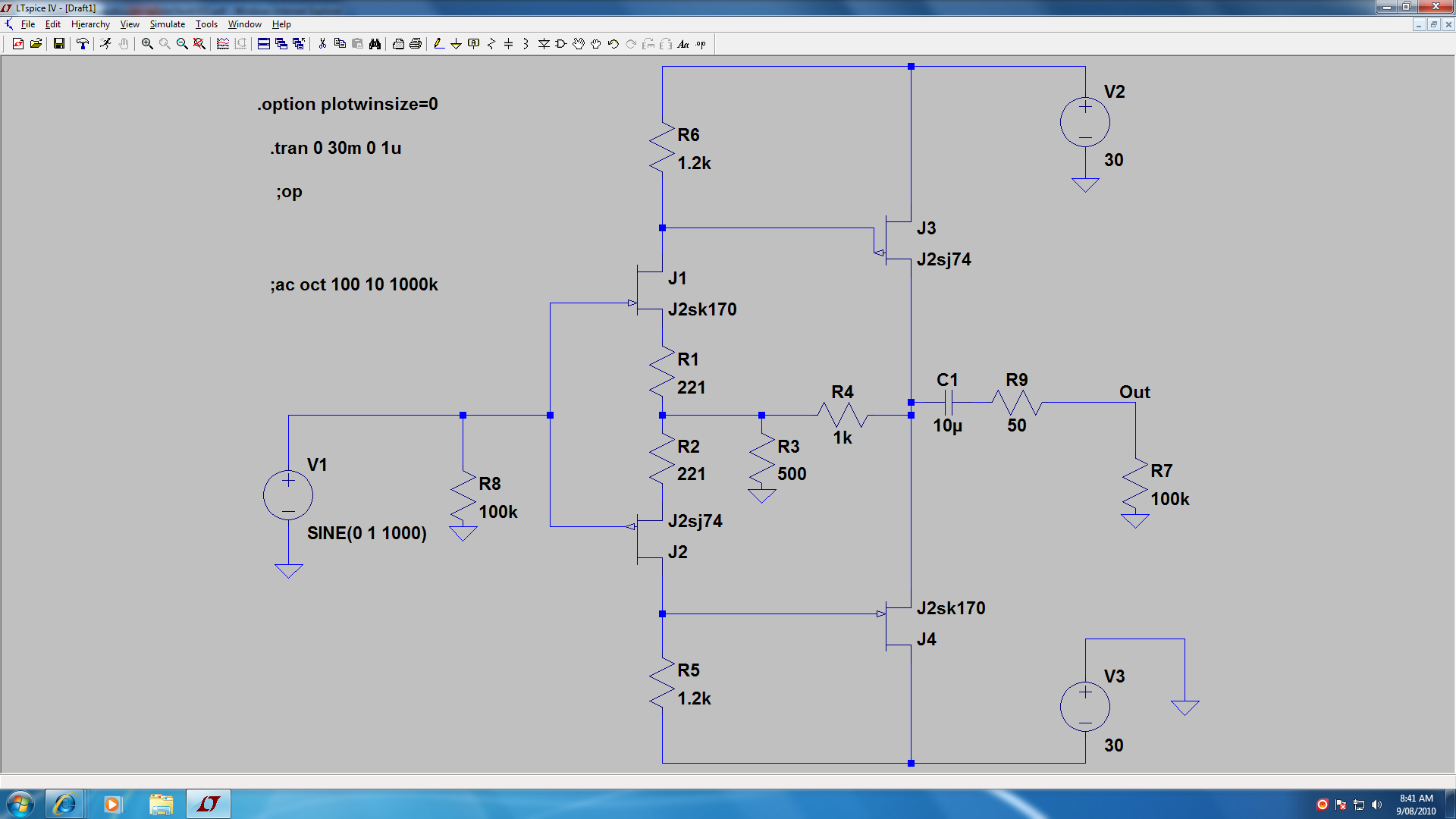

Now i am thinking to build a preamp to use with F5.With toshiba 2sk170/2sj74 jfets and irf510/9510 mosfets.What do you think about it?
You could also try something like this
yup ;
numerous times ..... each time changing at least 2 dead bug jfets/channel
It definitely wasn't intended to be a definitive solution. Just a quick mock up, of what might be possible.
What else would you add to remedy that?
Obviously you might need to add gate resistors, but is there anything else you would add?
How about lower rail voltage ? (for starters)
mucho lower .........
