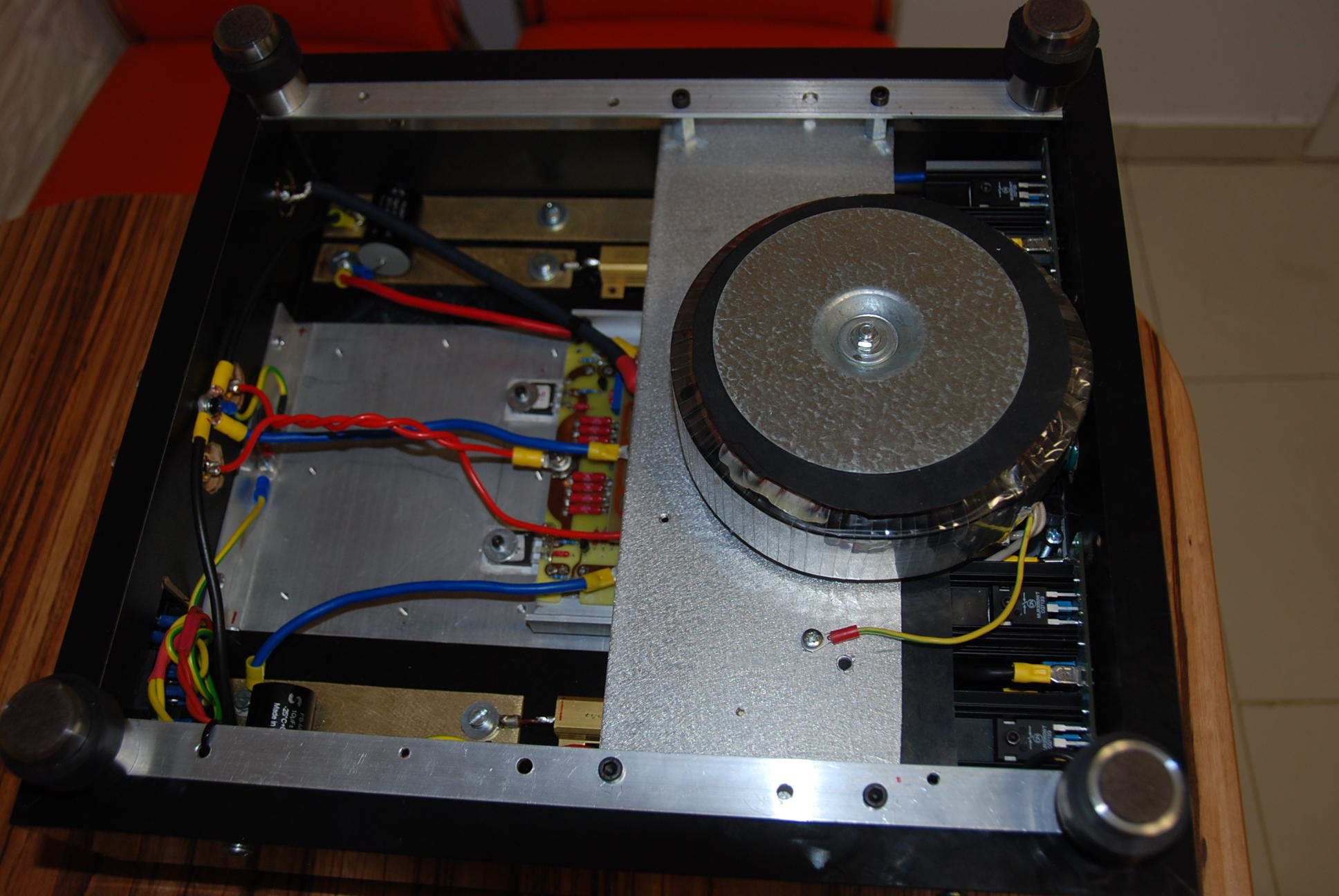

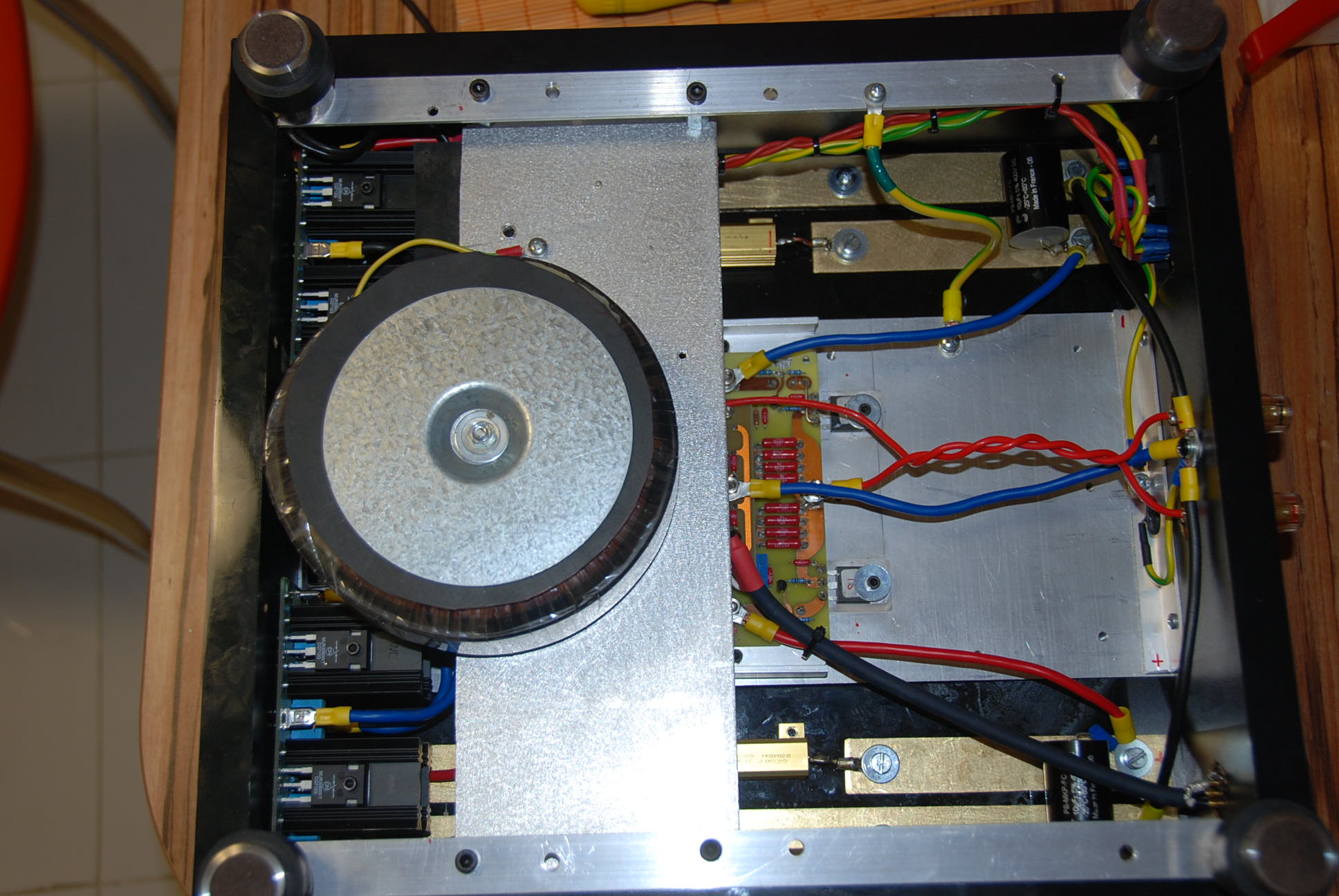

After several days, I finished two F5 balanced monoblock.
I am very very happy sound!
We compared with F5, 5 Aleph, Aleph X.
F5 balanced - is my favorite!
I very much Nelson Pass and Patrick (EUVL) for everything!
Sorry for my English🙂🙂

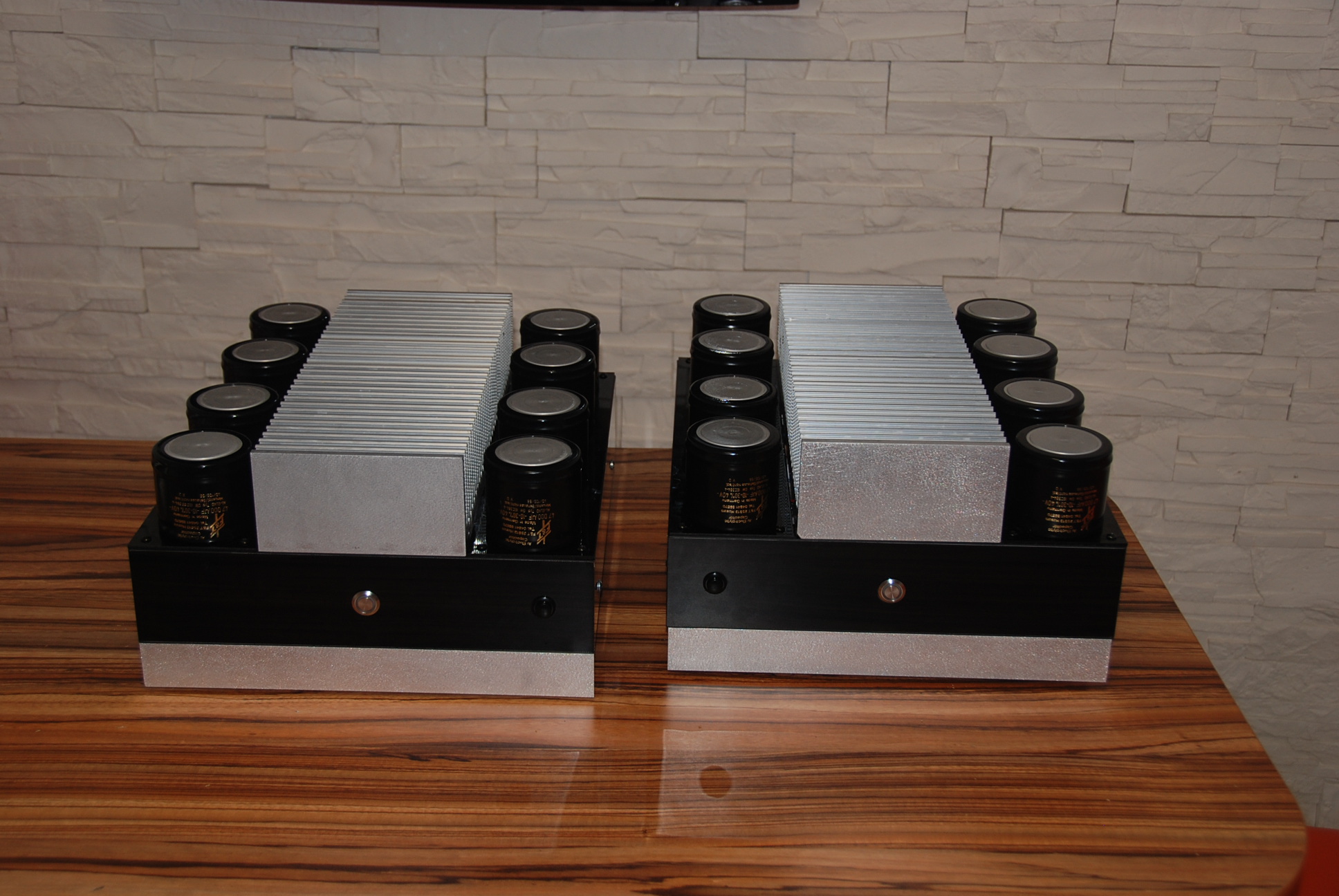

yo man !
that's Fugly!!!
all 4 pictures !
At first, I thought it was a commercial product. I was like "Where's the F5?"
The heatsink looks undersized. Are you running lower bias?

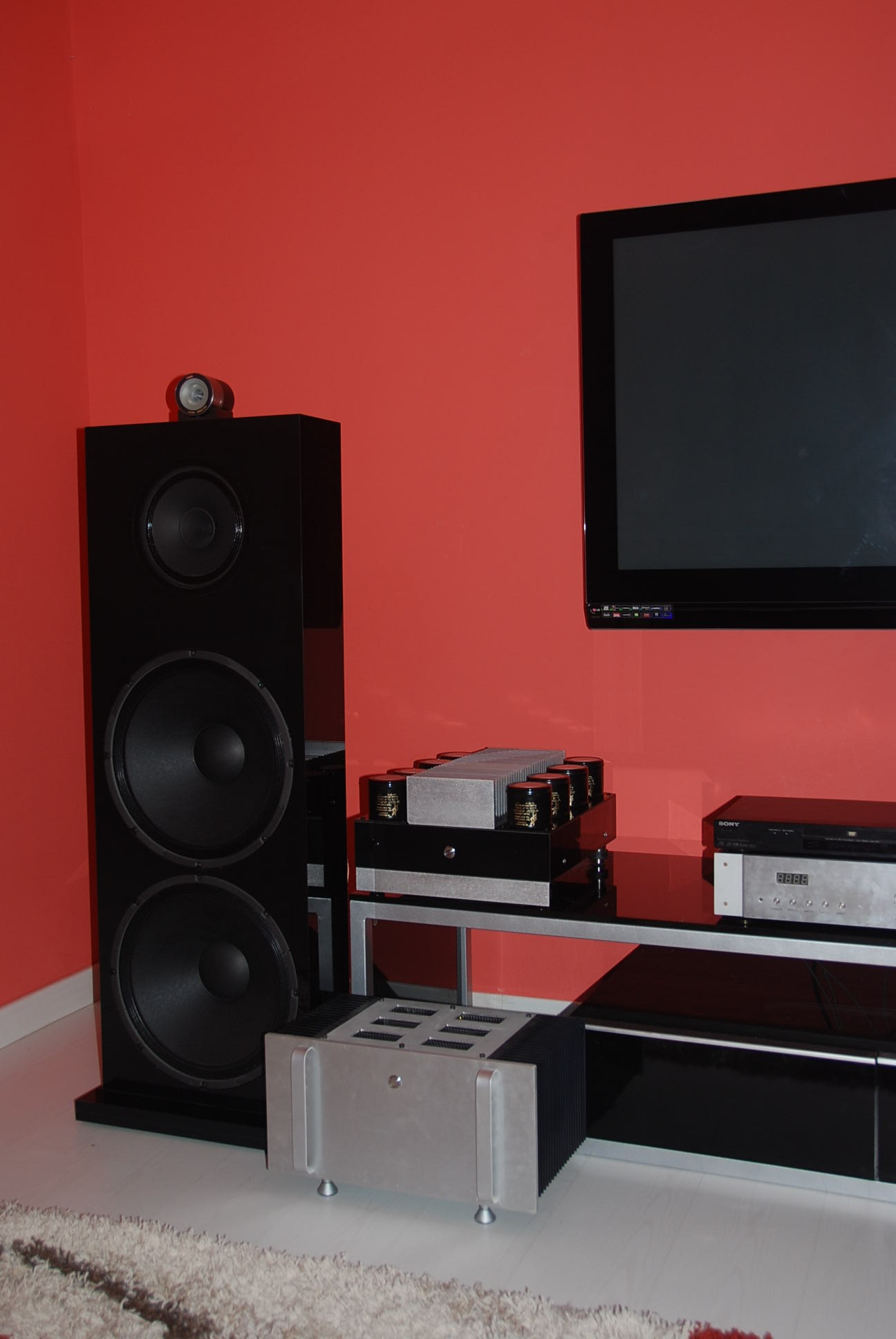

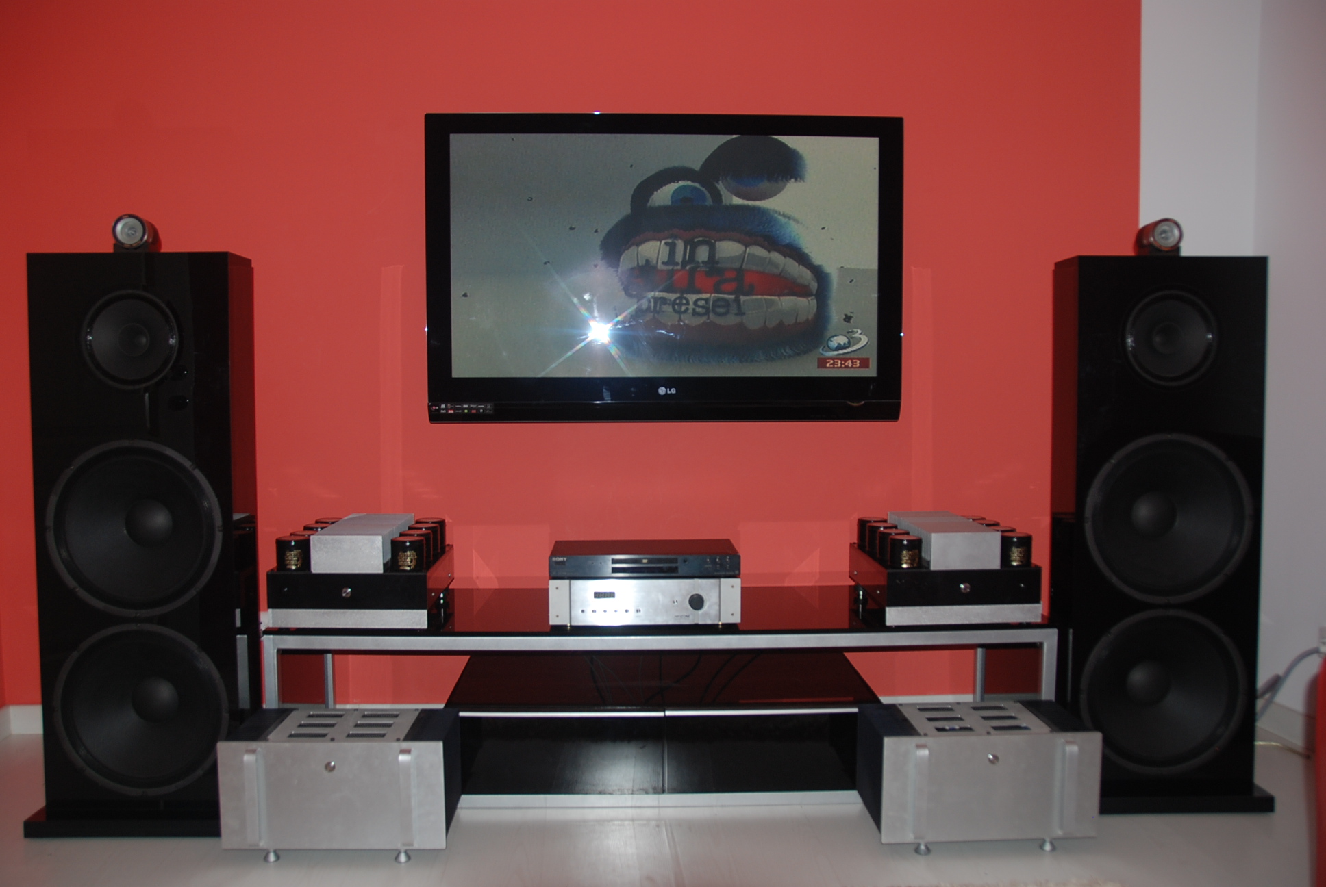

Vitali,
very nice amplifiers!
Nice speakers also. Could you give us more details about them?
Thanks for the feedback🙂
OB speakers:
Fostex and Supravox go with XF5;
2xEminence Alpha 15 "- Active filter with Aleph5.
Vitali
The heatkins is 400x160x83mm.
U = 15V, Bias = 2A (4A total)
Maximum temperature heatkins -48...50 degrees (room is 26 degrees)
Vitali

Very nice Vitali. I see your using those new invisible transformers -- saves a lot of space that way. Just kidding -- where did you put the trannys - in the case -- or outboard?
What amps do you have on the bottom?
Thanks,
Steve

vitalica,
I was wondering a few things...
what do you hear as the difference in the sound between the balanced and regular?
what did you use for the resistors in series with the Mosfets?
which mosfets did you use?
whose balance schematic did you use?
what are those three pin devices that are in the front on the bottom??
and finally, after how long did you measure the temperature of the heatsinks??
I too thought they might not be large enough and/or perhaps in that orientation they would not work so well...
Oh, you said "2A" bias - measured how?
_-_-bear
Forgot to mention - very nice looking job! 😀
