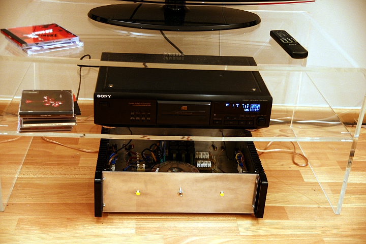

Tonight I connected f5 at 92dB mission m34i speakers - the sound is much more powerfu and dynamic than with my previous 89dB speakers -I keep them for lm3875 gainclone 🙂 . F5 is a very dynamic and nice sounding amp!Some listeners considered that f5 have weak bass, but it seems to me that the bass is very good and fast🙄.
here some pictures of system (very simple - just CD player with line out level control + amp) and some CD`s...

Just a thought-Any reason why you can't bring those speakers out a foot or two? You'll get a much more immerse sound
