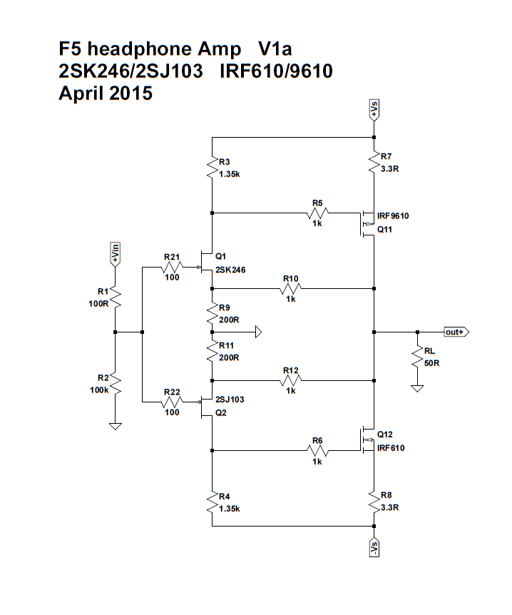

Let's mix it up somewhat and save those Toshiba JFETs, without comprimising SQ.
P1/P2 set the Iq of the output stage to about 50-100mA as well as DC offset at the output (start adjusting with maximum resistance of the pots).
Did anyone build this yet? Seems that maybe 100pF between input and ground might be a good idea for RF suppression as this circuit is very fast and may oscillate with RF induced pickup. Also, would a 100nF and 10R to GND on output also be a good idea as well to ensure stability at HF?
Although looking at this circuit and how simple it would be to make on veroboard, had me intrigued. Can it work as drawn? Also, can it work with 2SK170BL and 2SJ74BL for the inputs?
