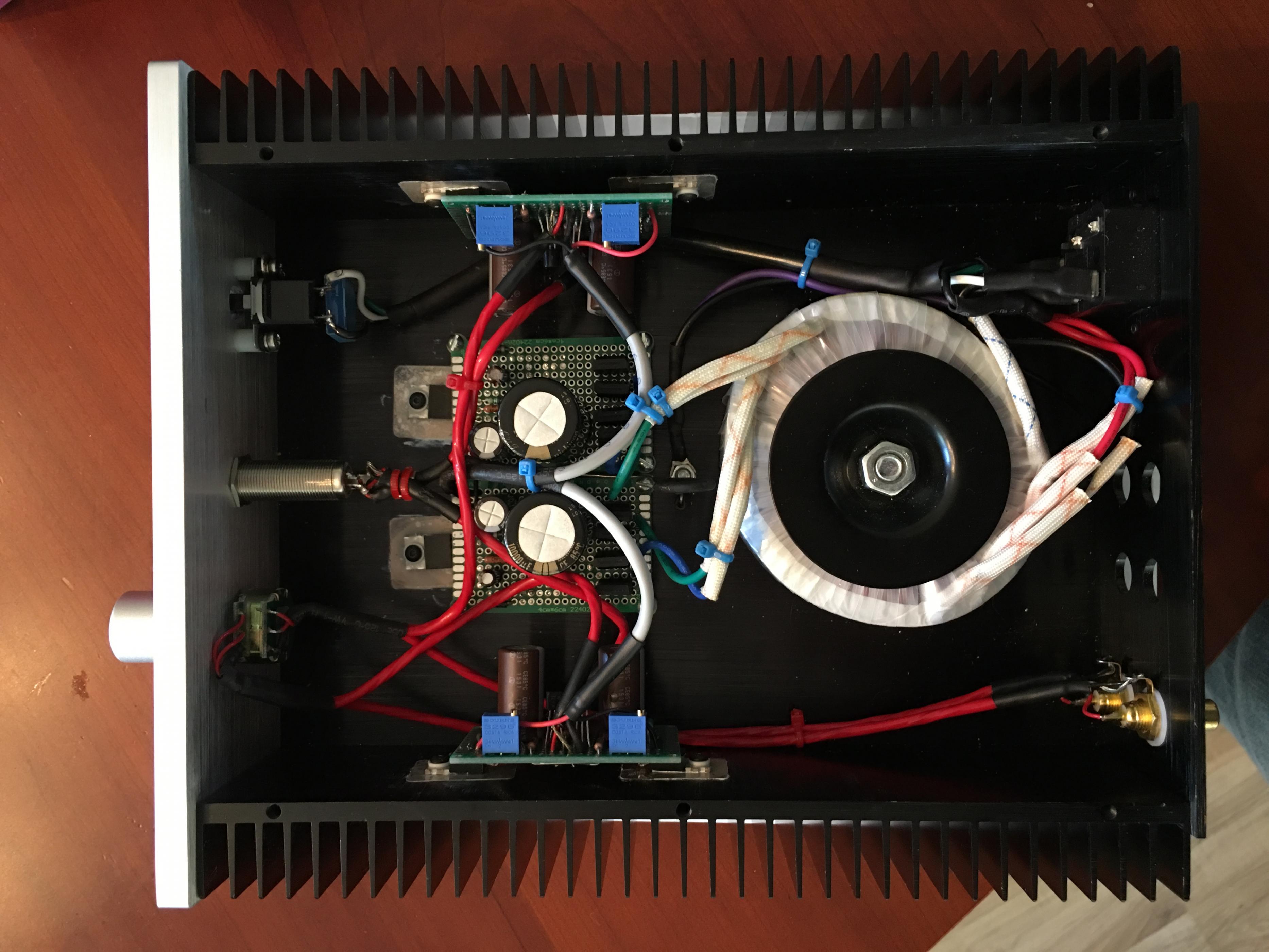

Concerning noise, I listening to one channel only (I am still working on the board for the other channel) last night.
Extremely low levels of background noise with just a 317/337 regulator. Transformer is in the same case as amp. And this was with sensitive Grado headphones. Noise was inaudible until the last click of the stepped attenuator with source connected but not playing.
I have not experienced a headphone amp with such low levels of background noise.

It's done. Biased up fine, offset is very stable and under 5mv.
Regulators are 317/337, all signal and DC lines are shielded. Pot is 10k stepped smd resistor. Bias is 180ma, rails 16v. Amp stays very cool and has very little noise.
Iam going to listen for few days and then let you guys know how it sounds.
Congratulations on a successful build 🙂
You may consider upgrading the power supplies to the one in post #137 later, I used that in a non-standard F5-HA build and there is absolutely no noise even at full volume.
