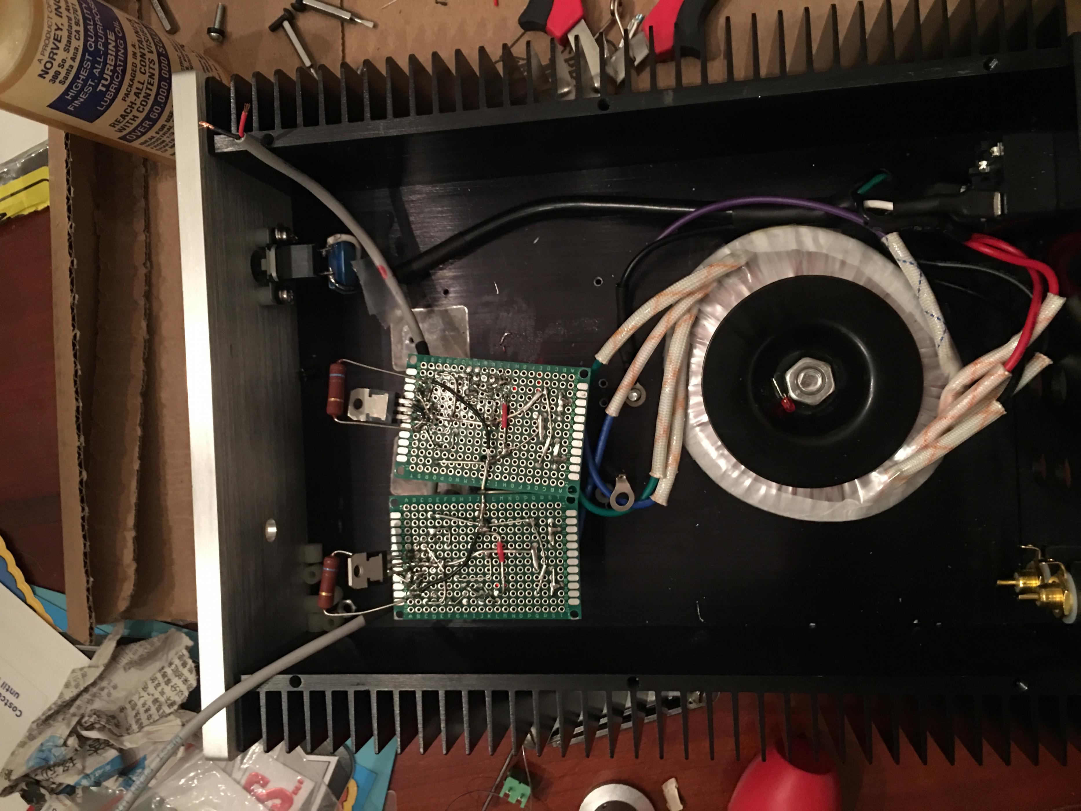

Finally got the regs working (stixx's cap mult) after miswiring the lm329s. Curiously I've got 14.9v on the positive side and -15.4v on the neg side. Same voltage drop across both strings of lm329/led.
Should I be concerned?

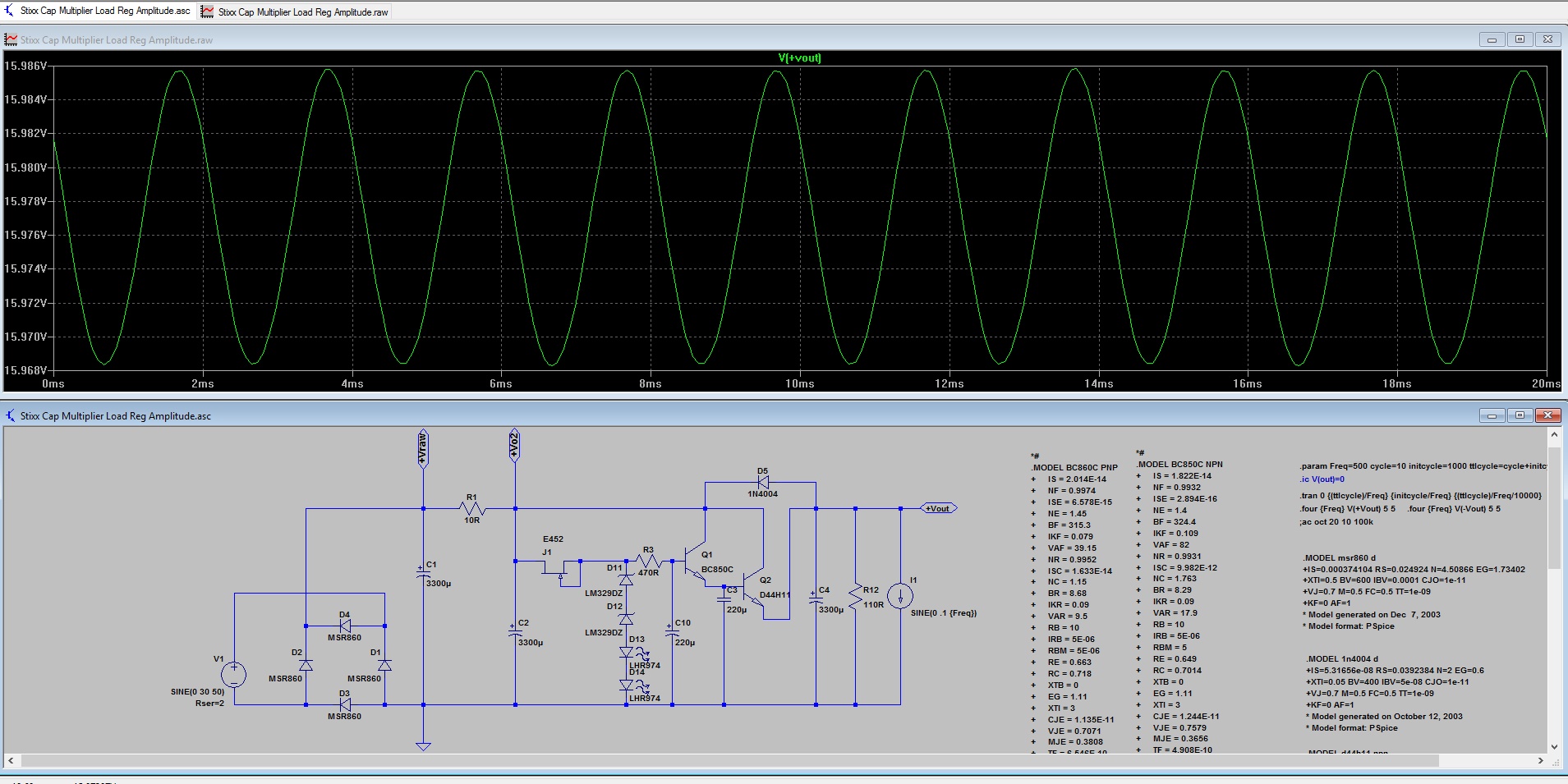

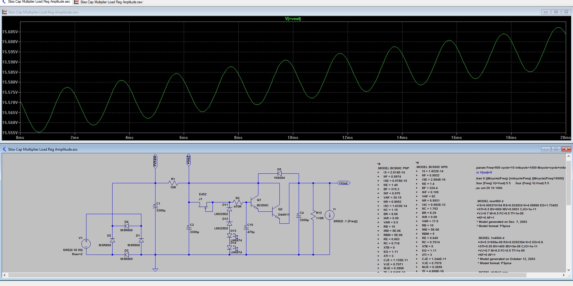

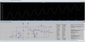

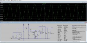

I was exploring Stixx's PS in LTSpice and noticed that increasing C10 cap caused oscillation. Even at 330uF there is a little. Decreasing to 220uF seems to improve it.
I also tried adding a cap between Q1 & Q2 which improved the regulation slightly. I know LTSpice isn't necessarily the same as real life. Is there any problem adding a cap here?
