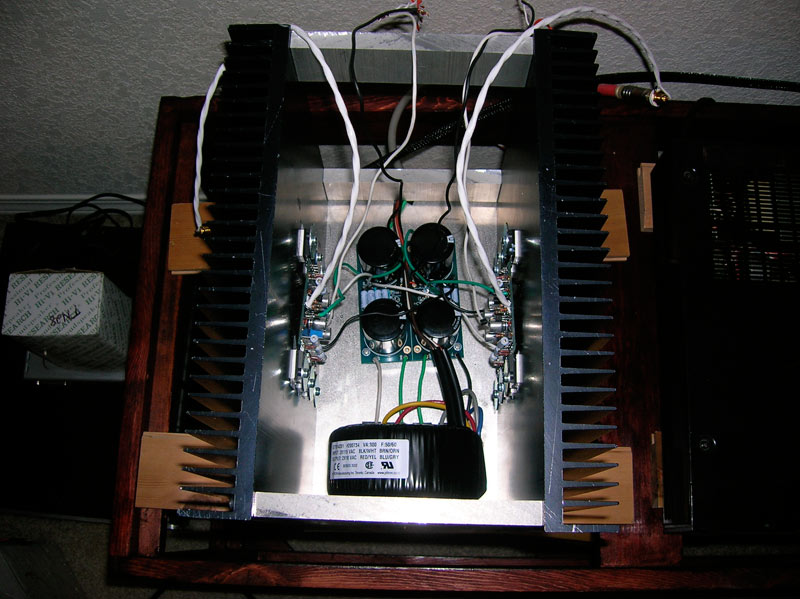

Ok, so after a week of listening then putting al together, I LOVE THIS AMP, very VERY good detail. It is dead A$-$ Quiet, I have to admit it, they are quieter then my aleph mini's ) I'm talking about noise ratio and humms : there is literally NONE!
Pure sound, I should build another.
The one bad thing, DAM THEY GET HOT.

carpenter said:Another reason to try water cooling? 😀 😀
Not going to happen 🙂
i just turned bias to 300mv tho so shes a little cooler
I'm considering the possibility of separating the power rails to the Mosfets from the jfets, and running the Mosfets at higher voltages than the jfets--about twice as much voltage, actually. Water cooling will be useful.
Joined 2002
carpenter said:I'm considering the possibility of separating the power rails to the Mosfets from the jfets, and running the Mosfets at higher voltages than the jfets--about twice as much voltage, actually. Water cooling will be useful.
would be good, however loud and just a pain for me..

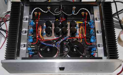

Here is my F4 with Conrad Heatsinks..bias set at 200mV..hot but seems OK for the hot temperature in Singapore.

Handsome amp! 🙂
