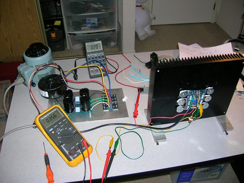

well my maximum Bias is 340mv. It wont go any further 😛 ( the pot starts licking meaning its at the end )
Jase
Here is a pic 😛 U know your life is made easy when you have 2 DMM's 😛
