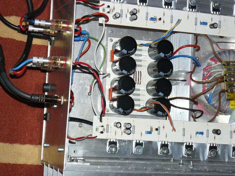

I've been fiddling and I get 50 degrees on the fets which is 42 degrees on the conrad sinks (mf30-151.5)when I run with bias at 0.49 amps(230mv).
Refer to earlier pics for view of the layout on the sink.
Regards
Ed
might be useful info for future builders
