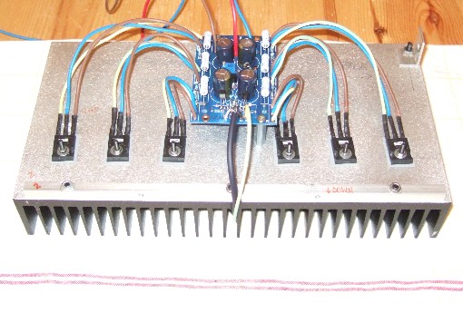

vitalstates said:nearly there......
Pretty. I looked as close as your pic allows, so pardon me if I'm wrong, but it seems to me that your power mosfet gate resistors are supposed to be very close to the gate pin.
They work just fine like this is done.
So no worries.
Magura 🙂
While I've never gone so far as to have a long distance challenge, I have run lengths up to ten or twelve inches from Gate stopper to Gate without problems. There are a lot of variables in play, though, and I prefer to keep it under three inches when I can. That's in bench circuits. Once I get to the PCB stage, I'm generally in the .2 inch realm.

Regarding distance (long leads being acceptable between gate and resistor), is this a general rule, or does it only apply to certain fet amplifiers. I was under the impression that the resistor had to be close to the fet.
I stand corrected.
I stand corrected.
