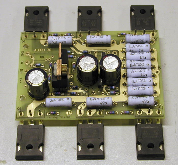

Yunick,
I'm a little concerned that the resistors can't lay flat against the pcb. Not enough room...
I've ordered these boards and hoped to have a professional appearance.
If the resistor leads are bent and tucked under the resistor body, will the adjoining resistor leads clear one another? I see that the resistors are tail-gating (for lack of a better term).
Also, I noticed that your heatsink isn't very polished where the fets make contact. Could this be creating a weak thermal contact?
You've got a pretty clever way of marking your fets...😀 How did you do that?

carpenter said:Yunick,
Hi Carpenter,
The boards are designed with miniature resistors in mind.. I can't remember what they were called but Peter Daniel explained this in the groupbuy thread.. I use regular 0.6w metalfilm resistors from elfa.se..
There is plenty of space under the resistor body so there should not be a problem.. I did this on my A30 with boards from Peter with good results.
The heatsinks are from conrad heatsinks in Australia.. This is how they look when I recived them.. I use them in my babelfish and previous in my A30..
The fets come from Tarasque here on the forum.. He have a automatic matching rig.. don't know how that works but the markings are very handy 🙂
The resistors are Phoenix/Vishay SFR16S, page 1686 in the current Digi-Key catalog. Very nice and not that expensive. I have used them in other items from Peter and in BrianGT's boards for Alephs.

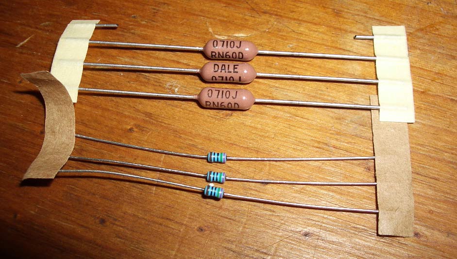

Malotron said:![]()
the Phoenix SFR16S are swell but stuffing a board with them is like training fleas to play dead. 😉
-Mal
well - all you need to do this properly is plastic leads former and few beers ;
after few beers , who cares for resistors and amps?
Resitors
The Panasonic miniature 1/4 watt resistors as shown on Digi-Key catalog page 1678 will fit Peter's boards.
