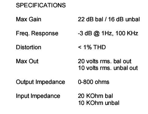

jarthel said:I intend to pair an aleph 1.7 preamp with the F4. I was readin the 6moons and it seems F4 doesn't amplify voltage.
pairing aleph 1.7 and f4: good or bad idea?
Thank you very much
anyone else?
I know that the service manual says pass labs preamp can drive the F4 directly. But I am not sure if that only includes the recent X-series preamps.
The speakers that I will be using will be in between 90 to 95 db/w efficiency.

Is the 1.7 a commercial pre? I don't see it on passlabs.com. How many volts can it make unclipped?
I think it comes down to how much voltage it is capable of swinging at the output - cause I think you'll have the same swing at the F4 output.

Unbalanced, the 1.7 will swing almost 20V peak and twice
that balanced. This is just short of what will clip the F4 in
single-ended or bridged mode.
The X series will do about 28V peak unbalanced, and about
twice that balanced, which is more than enough to clip the F4.

in plain english, is that a "yes, you can safely use an aleph 1.7 with the F4"?

Thats going to be a YES use the Aleph P 1.7, as the F4 needs a-lot of gain.

Safely?
I confess that I don't understand how this amp has caused so much consternation, just by having unity gain.
Let's back up a moment and look at some simple numbers. Nothing kinky. Nothing weird. Just some realistic numbers.
An average power amp has something around 26dB gain. Is there anything sacred about this figure? No. It's just a semi-conventional figure that the industry tends to use. It works out to amplifying the signal by 20x. The Aleph amps have somewhat less gain--20dB if I recall correctly. These days a preamplifier generally has something between 10dB and 20dB of gain. Just to keep things simple, let's assume you're using a CD player (which generally has a fairly hot output) and that your preamp has 14dB gain (5x). Now rouse a few brain cells and do the math: 26dB plus 14dB equals 40dB total available gain.
But--being possessed of super powers--I happen to know that you never use that much. You'd have to crank the volume knob all the way clockwise, something few people ever do. Actually, it's likely that you end up in the 10 to 12 o'clock position...and that's on loud days.
Now, here's your homework: Put a known signal into your preamp and set your volume knob so that the output equals the input. For example, if you put in one volt, then set the volume knob so that you're getting one volt out. Put a piece of masking tape next to the volume knob and make a little hash mark at that point. This is 0dB gain. Your volume knob is now calibrated. Kinda sorta. For extra credit and since you've already got the masking tape in hand, go ahead and mark a few more useful places, such as +3dB, -3dB, +10dB, -10dB...etc.
If your preamp is at -6dB gain at what you regard as a reasonable listening level and you use an Aleph amp (20dB gain), then you're using around 14dB overall gain in your system. This tells you that you'll need a preamp with that much gain and with enough voltage swing so that it doesn't clip when driving the F4 rail to rail. In reality, it wouldn't hurt to have a little extra.
Okay, time for a reality check. The Aleph 1.7 preamp specs show 22dB gain balanced/16dB unbalanced. That sounds pretty good. How about the voltage swing? A quick perusal of the specs shows 20Vrms balanced/10Vrms unbalanced.
Given that the stock F4 is quoted as swinging +-20V, and given that you know it has unity gain, you'd like to be able to swing +-20V (40V overall) from the preamp--that means peak voltage, not RMS.
A little quick math shows that the preamp can swing well over 50V from peak to peak.
