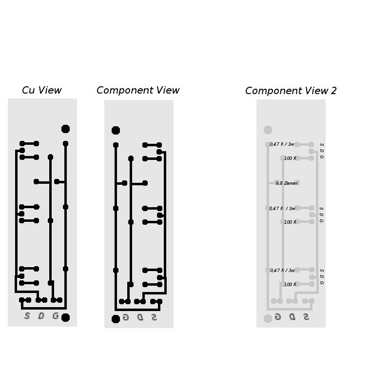

I am in for designing my own pcb's to fit my need's.
I have tried to mockup a output board, for IRFP240 / IRFP9240, which fit my heatsinks perfectly... Only difference is how the Zener diode must be turned. The mosfets are soldered under the Cu traces, and the gate, source resistor and zener-diode are ofcause soldered on the component side of the pcb's (Witch i had to make 8 pcs. of for 2mono block's)
Any comment's and suggested modifications are very welcome ! 😉

Jesper, you might want to make the tracks as wide as possible.
Especially the Source and Drain tracks would benefit from a bit wider tracks.
Steen🙂
Steen🙂
lykkedk said:I am in for designing my own pcb's to fit my need's.
Do you plan any thermal coupling between the N and P mosfet banks?
I think that would be wise in terms of dc stability.
Thank's i will make the traces as wide as possible.
For the thermal coupling i don't know, i don't think it's possibly with my heatsinks...
I will use 1 heatsink for the irfp240 and another for irfp9240, btw.
I havent really thought about that
