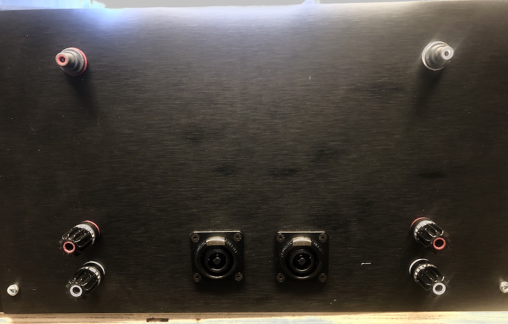

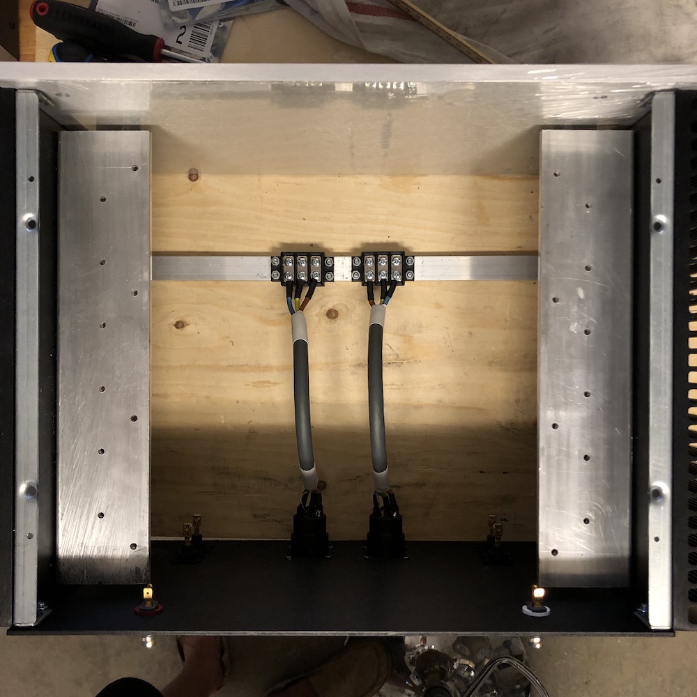

I'm building an F4 in a semi-permanent testbed using an external psu. Should I put a capacitor bank for compensation due to one meter power cables 3.5mm^2?
The PSU is dual mono with 400VA toroids and the rest according to Mr Pass general PSU. Other Ideas or comments are appreciated?

Thanks, Pass and ZM, for your inspiring knowledge.
ZM, those capacitors jumpstarted my imagination :)
Do Ducati 4.16.10 Series fit to this purpose?
Is F4 OK with +-25V from PSU?
Did I get the usage of capacitors?
