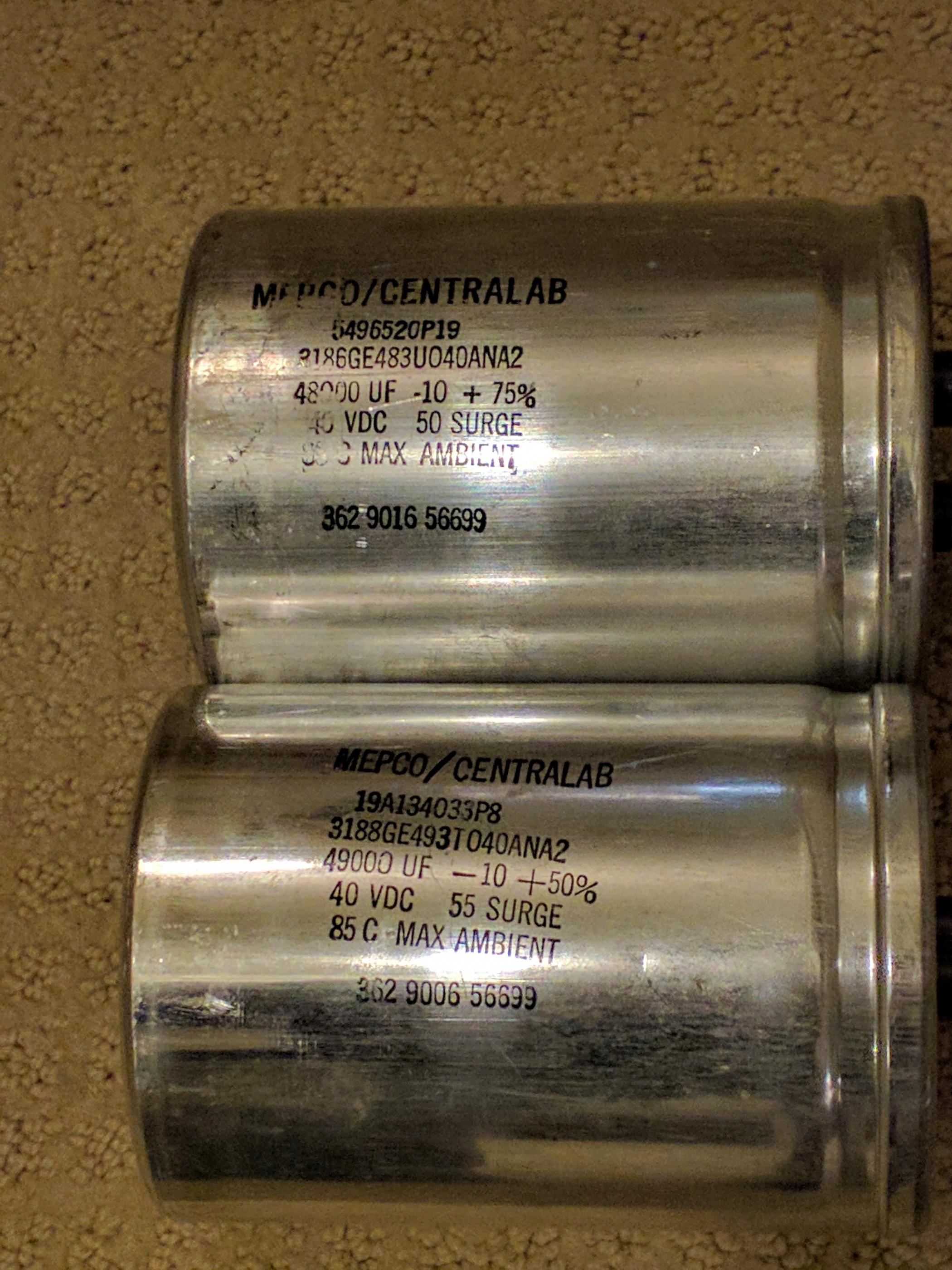

Big capacitors
Guys,
I have couple big caps as gift from friend but don't know how to check if they are good. My intention is to replace couple caps from my F4 if they are still usable.
Please advise
Albert

one thing is if they're old , other thing is are they tired and worn and dry
try reforming them - just slab them to highest possible DC PSU you have (up to declared voltage) through 100K resistor and leave them connected that way for few days
then try them , nothing wrong with some testing fun
if you have a place in case , connect 50uF motor-run caps as bypass for final caps in filter section , that usually brings some speed and freshness

Thanks choky,
You said there might be chance to wake them up by charging them with the stated maximum voltage and series a 100k from the PSU.
I have a bench PSU with adjustable dual 25v. I'll try series both supplies and tune to the cap maximum voltage to try.
Thanks for the advice
