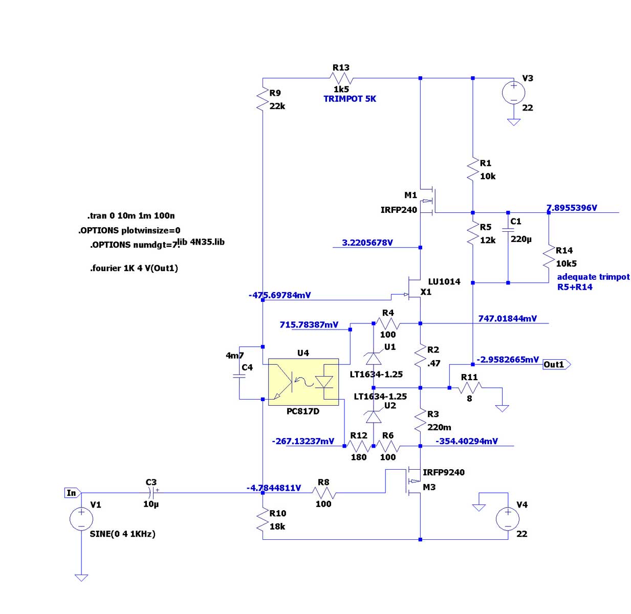

Incidentally, we are running sims of a boosted 100v rail version that can swing 90vpp into 10kohms and looks like this:
attachment.php
Here is the schematic of the souped up 90vpp version:
attachment.php

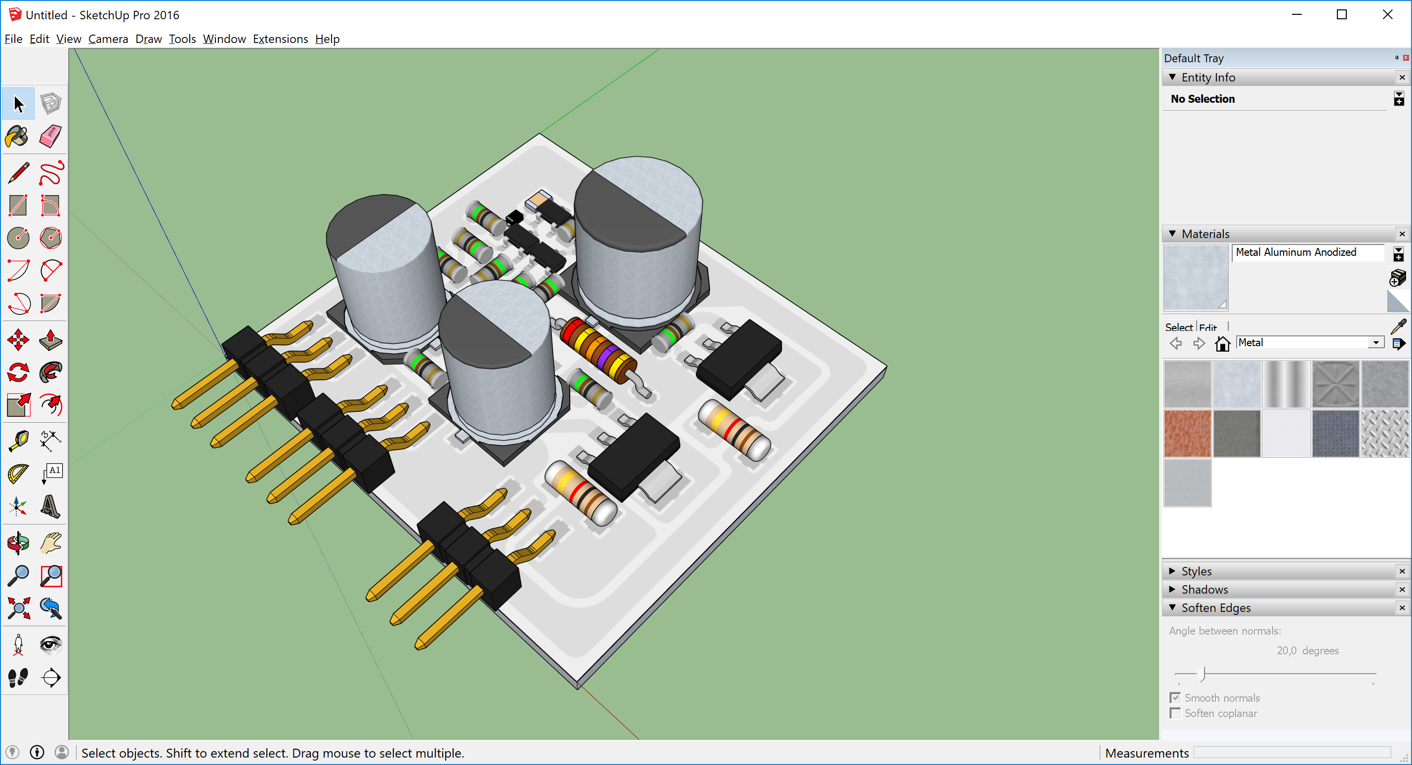

The JPS64 design of the 40vpp version has SMT daughter boards on a main board with selector switches and PSU and looks like this:
646500d1511024036-aksas-lender-preamp-40vpp-output-aksa-lender-preamp_v2-jpg
