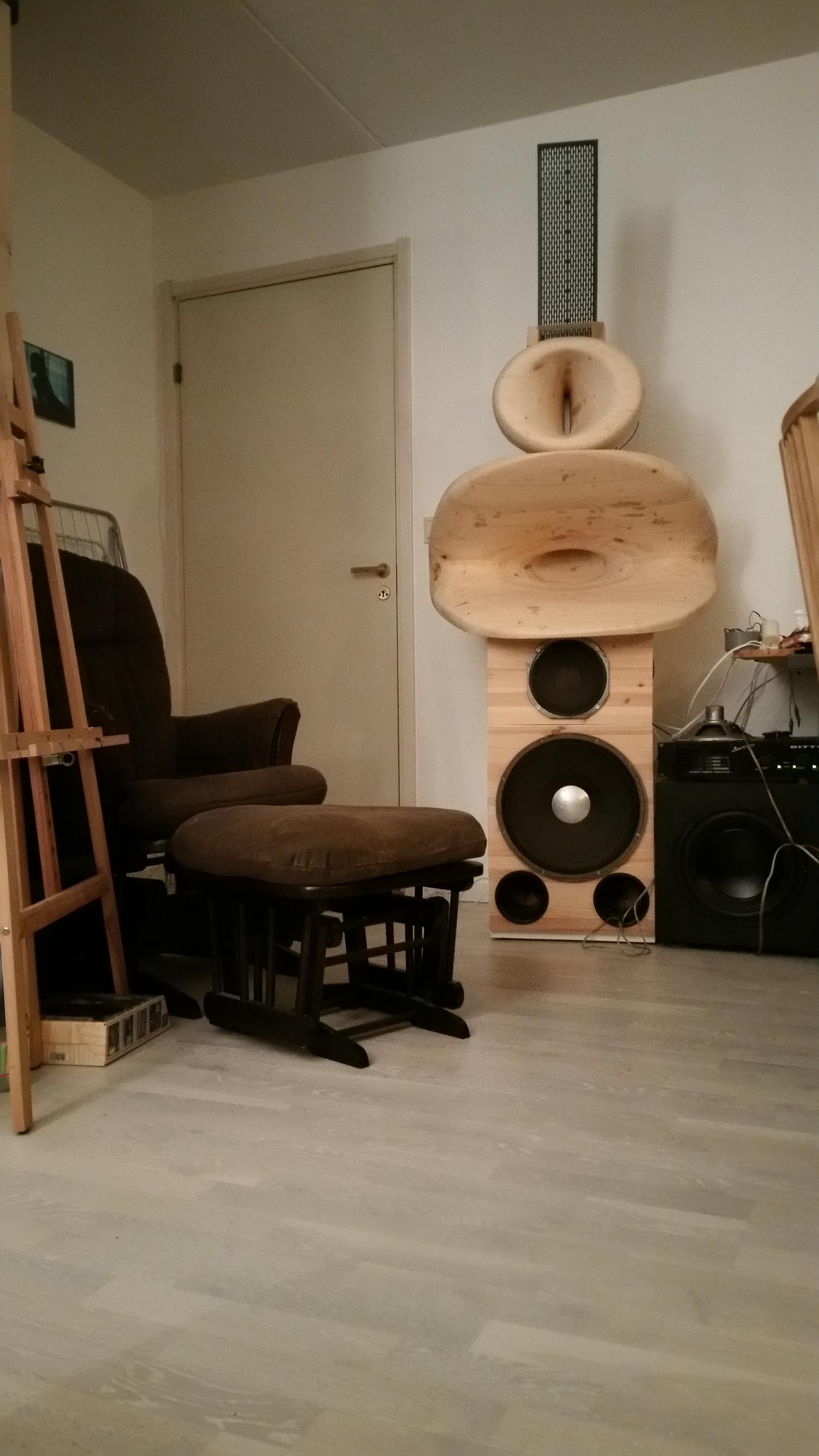

Wrote with Rob, the manufacturer in Australia, and he agrees it will be "a trial and error exercise" about Firstwatt amps. The electrostatic drivers are leaving Italy tomorrow! Exciting stuff! Considering that they won't play more than 250-15 000Hz, maybe they won't need monster levels of current. 🙂

The 25W Firstwatt F5 clone did do very well with the panels. I need like 25% volume instead of the 15% for the horns. 🙂 Now I have to decide on another F5 or F4. Gotta love a 7 ft speaker.
F4 has significantly more current capability than the F5. I suspect it will work MUCH better then the F5.
Thanks, I noticed an improvement with the electrostatic panels when going from a 2A3/6SN7 tube amp to an F5, and I suspect it has to do with current capacity. I will go for the F4 if it has even more. The F7 will be interesting to hear also, whenever that is released.
