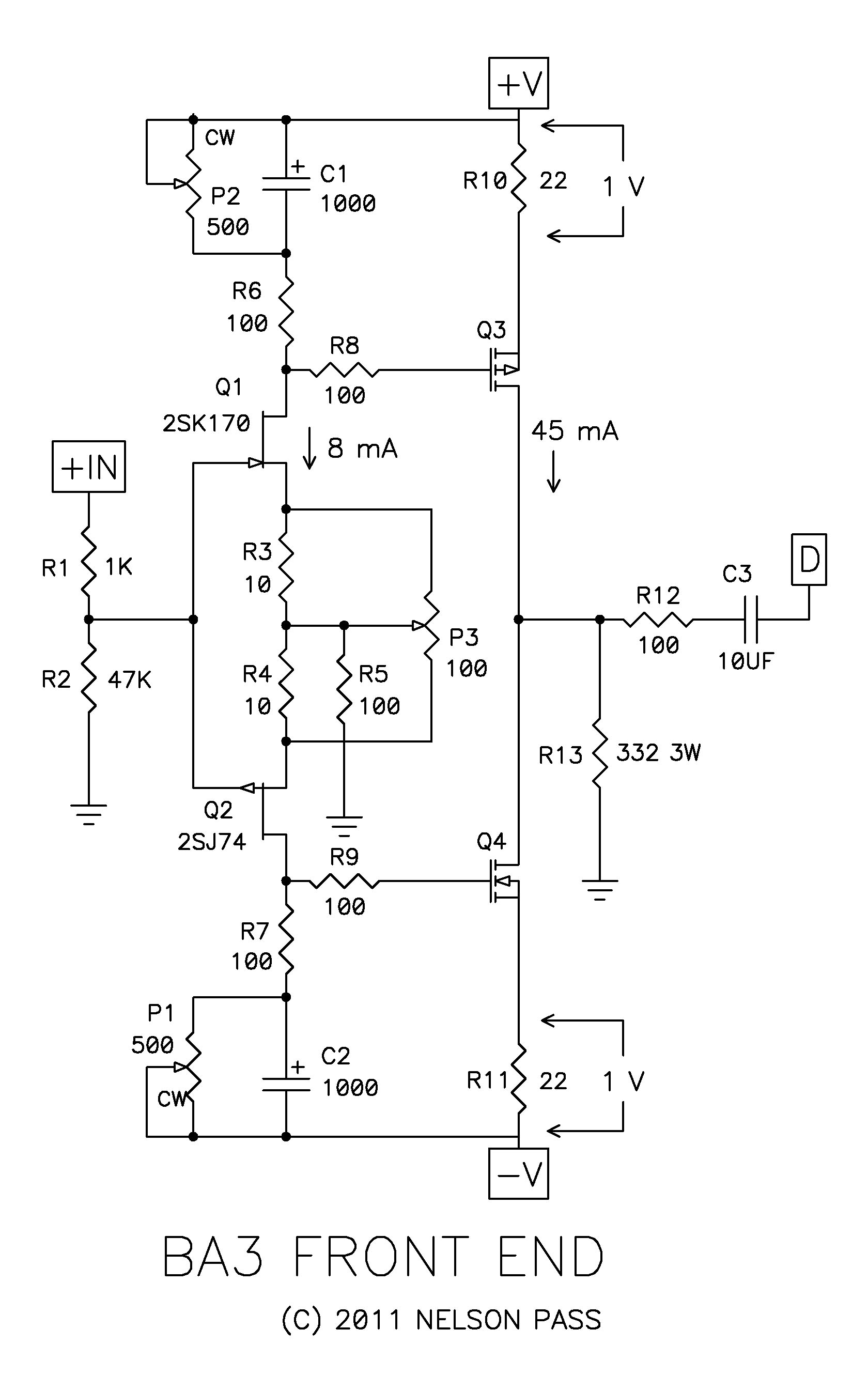

BA-3 output stage holds the bias circuit a little differently, look at C1 and the diodes and where the gian stage drives it.

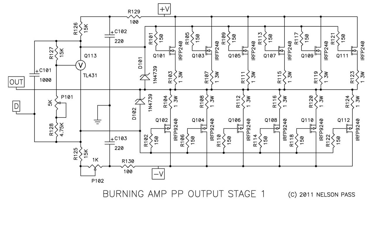

The Output buffers you ask about are all essentially identical - they are IRF240/9240 push pull followers. Followers don't impart much signature at all to the circuit. Which means they will all sound very similar, and that sound will pretty much be like whatever you drive them with.
Refering to the BA PP output and gain stage I don't understand your explanation about C1
It seems the same as F4 and M2View attachment 656383
From the Firstwatt BA-3 article.
http://www.firstwatt.com/pdf/art_ba_3.pdf
Coming off the Drain of Q1 is the loading network of R6, C1 and P1, and there is a
comparable network of R7, C2, and P2 attached to the Drain of Q2. R6 clearly sets the AC
load for Q1, but the DC requirements to bias up Mosfet Q3 are higher than that, so P1 in
parallel with C1 provides a higher resistance value below about 0.5 Hz, and gives the
approximately 3 volt DC drop required to bias the Mosfets
