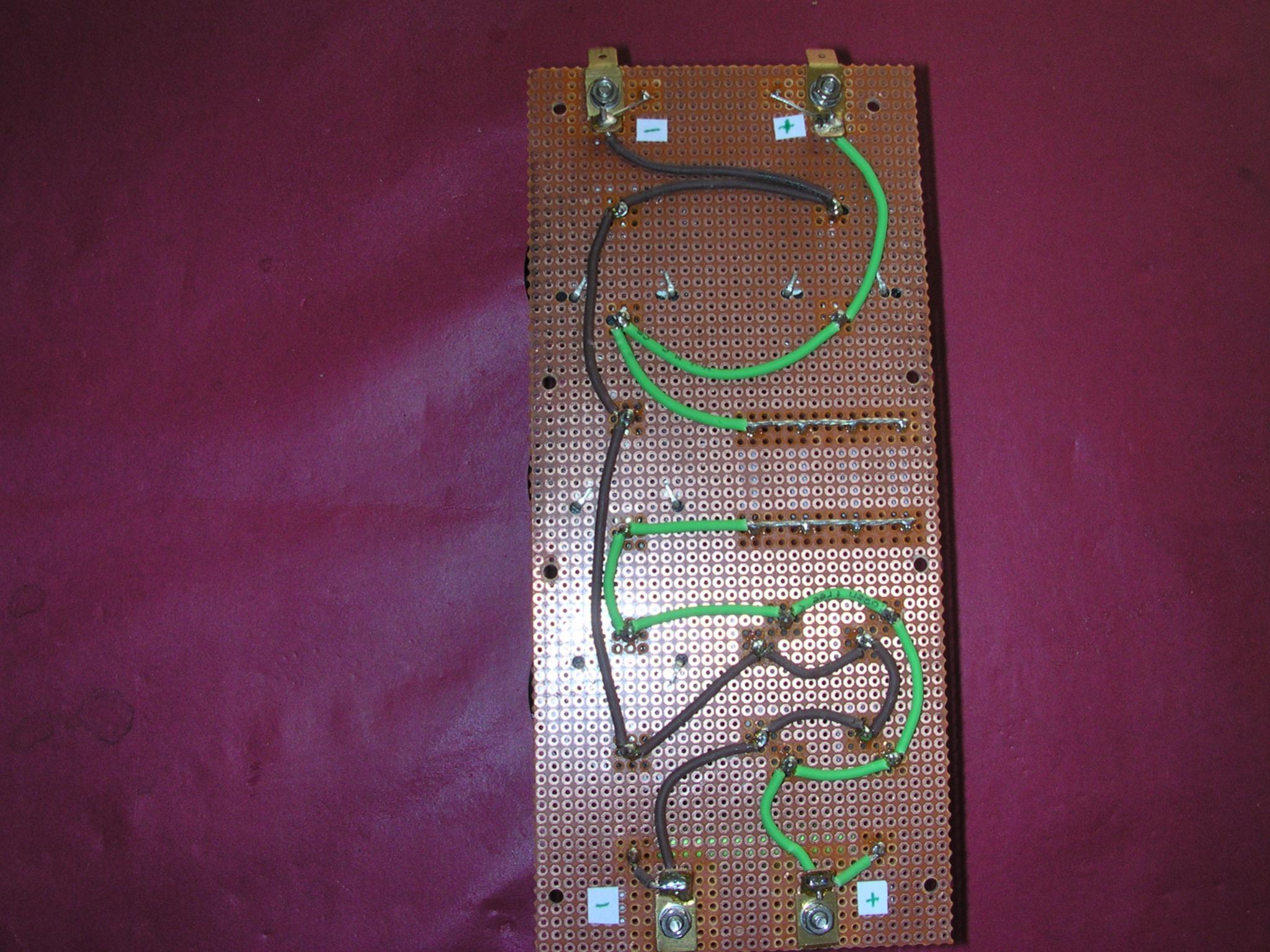

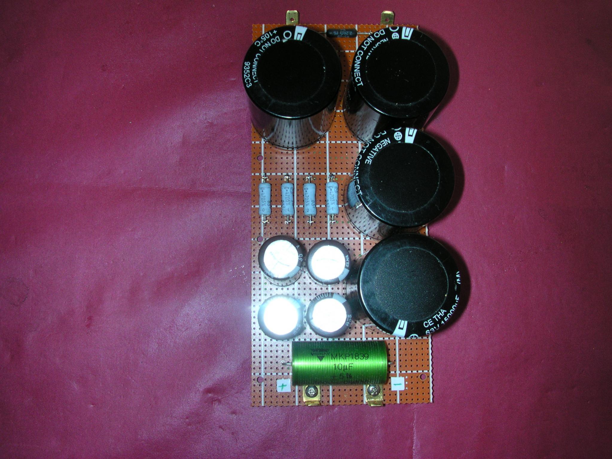

F4 PSU pictures
The F4's are coming along nicely. The PSU's are done and I thought I would post some pics of one half of the PSU.
We ended up using a CRC layout with point-to-point wiring:
The journey continues
- 2 x 15000uF 63V Panasonic THA,
followed by - 4 x 0.47Ohm Panasonic 3W (parallel)
followed by - 2 x 15000uF 63V Panasonic THA
- 4 x 1000uF 35V Elan Silmic II
- 1 x 10uF 160V Vishay MKP1839

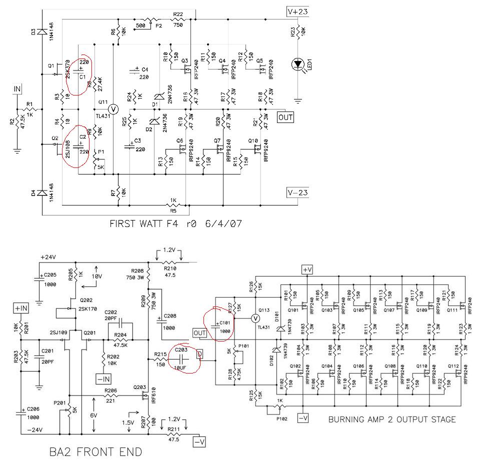

F4 has two C1, C2 - 220uF capacitors but looking at BA-2 cirquit we can see that there is only one C101 - 1000uF in the same position. So is the C2 a must in F4 then ?
The corresponding C1 is the 10uF from the frontend.
You know normally in F4 2 x 20uF would be sufficient but the 2 x 220uF are there to beware of the turn on and off plopp (as far as I know).
BA-has simply another distribution, the 10uF, this lower value makes a better foil cap possible for the signal path and the big 1000uF for the anti-plopp.
What I always wanted to know but never got an answer...... is this cap is also relevant for the sound.......?
C208 , on BA1 FE and also in BA2 FE schematic ?
if that cap is in question - it is just part of bootstrap mechanismus (R208,R209,C208 on BA1 FE schm) .
plain industrial quality cap is sufficient
Sorry that I was not more clear from beginning......
I mean C101 used in BA-2 value 1000uf
In this circuit version http://www.diyaudio.com/forums/diyaudio-com-articles/194809-burning-amplifier-ba-3-a.html
same approach - that cap is across bias network
some will say that his role is to bootstrap bias network - maintaining constant voltage across it ; Q113,R127,R128,P101
industrial quality cap is sufficient ; for piece of sleep - you can always bypass it with fine MKC

same purpose , different arrangement ;isolating two nodes DC wise
you can use them in both ways , and bypassing them with sweet small film cap can't harm 😉
