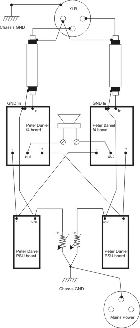

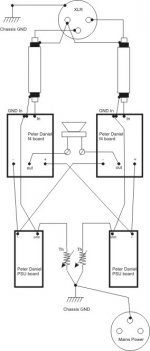

Dear All,
I will appreciate very much if you look at the attached picture - it is about grounding. In your opinion is it okay, or something wrong or missing, or possible to improove?
