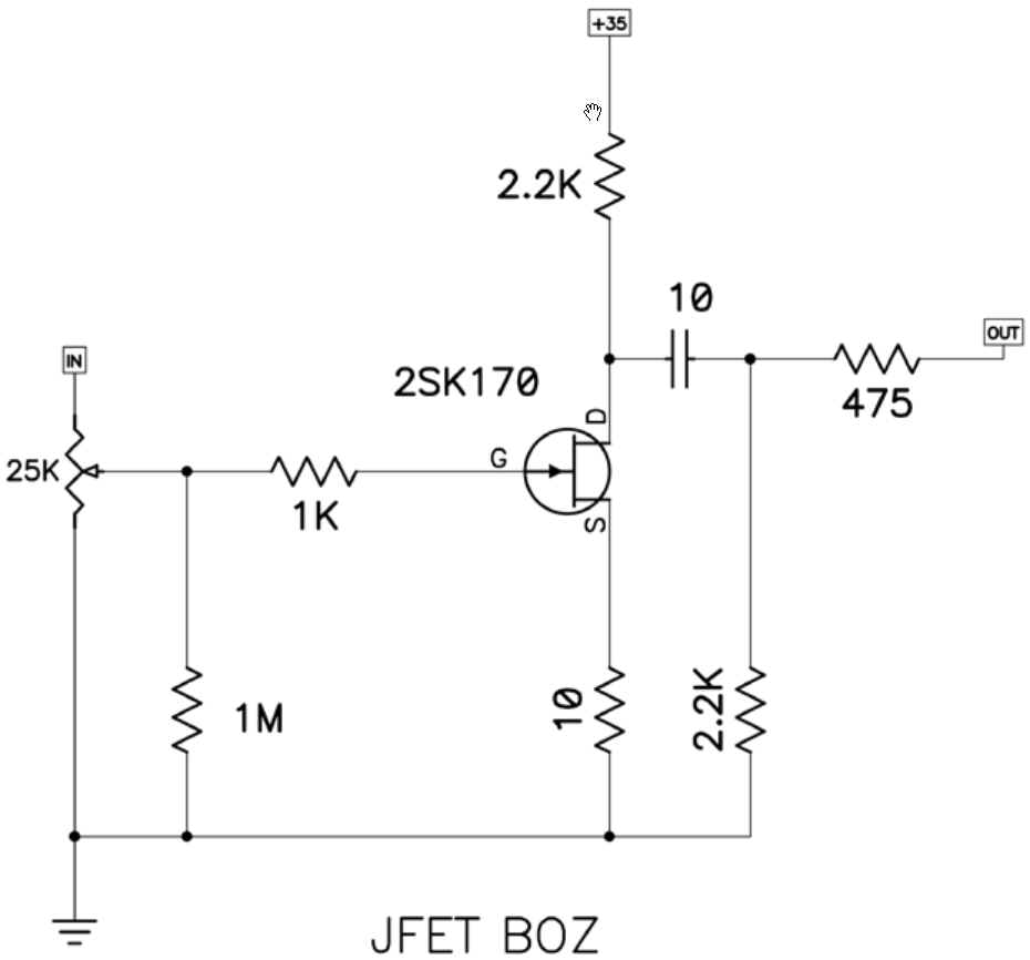

carpenter said:...Nelson's wonderful sounding JfetBOZ--which I've morphed into a balanced, CCSed...
Hi Carpenter,
Talking about Nelson's wonderful sounding JfetBOZ do you mean schematic below?
What do you mean "CCSed"?
Best Regrads, Andrzej
Andrzej Sochon said:
Hi Carpenter,
That looks like the original circuit--it's single-ended.
I've created a thread entitled: JfetBOZ mods. There you see my amateurish attempts at improving/playing with Nelson's creation. 😀

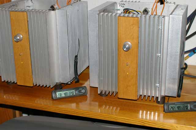

By the way, look what I use to measure temperature: simple car-thermometers I bought at supermarket, price approx. 3 Euro each.
Precision is not laboratory perfect but is quite enough! Important is that supply battery is easy to buy everywhere: 1,5V AA size.
I hope you can see 48C.
I was not able to check having no preamp, I did not observe any change in bass.
Best Regards,
a.
Looks like a manly pair of amps to me, allright😎
At 48C you can raise the bias a bit, if you wanted to😉
steenoe said:Looks like a manly pair of amps to me, allright😎
Yes, I want to raise the bias.
At the moment I got 48C without top cover.
If you compare my thermometer-photo with my awatar, maybe you will see there are no woodden insulators now. Now all walls are thermally
united/connected. With wooden insulators Mosfets temperature was as high as 68C. Now its much better.
... maybe you will see there are no wooden insulators now. Now all walls are thermally united/connected. With wooden insulators Mosfets temperature was as high as 68C. Now its much better.
Good catch, and something for us to learn. Thanks for sharing. 🙂

Hi Carpenter,
I wish I did not measure temperature of side walls before, as my beloved SOZ was inside. Big aluminum resistors ware mounted here, and after half an hour side walls ware so high that I could not touch them, it was 80C or more. Mosfets ware mounted on the front walls so wood insulation was necessary.
Where are amusing critters...aha, ...
...Big aluminum resistors were mounted here, and after half an hour side walls were so hot that I could not touch them; it was 80C or more. Mosfets were mounted on the front walls so wood insulation was necessary...
Now that makes perfect sense! More useful information.

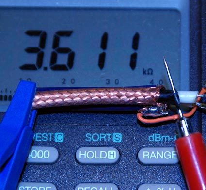

Last weekend I tried to clear cables and other things inside my f4. I exchanged C1/C2/C3/C4 to Nichicon, I also exchanged internal signal cables. Hearing tests – oops...there is no left side. Brumm test... one of boards in the left monoblock does not respond. The reason was simple: black “additional insulation” of signal cable was touching R1. It slightly conducts...See attached picture, for better view copper shielding is removed.
