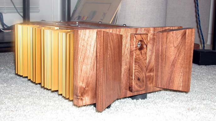

Andrzej,
Amazed you actually use those sinks this way around - try turning them "inside out" (fin in)and cool the assembly with a slow running, quiet computer fan and add a temp control cct for faster, more accurate pwr fet temp setting - plenty of examples.
There are any number of cheap fans like Cool-Master, Nexus, etc and mount with soft rubbers, add a 40mm fan to h.sink space, ensure no sharp edges, etc.
I've thought about using the larger, high flow, low turbulance fans which are "totally" silent but quite expensive and require a better system of temp/power control, unfortunately, so still using the C.Masters - silent in use, with baffle plate.
jameshillj said:Andrzej,
Hello JH,
Thank you very much for fantastic idea with turning sinks - my cables are long enough.
In the past SOZ was inside, including typical computer fan at the top. I even applied simple electronics with thermistor to slow down propeller after a cold start. I will use it again.
Best Regards,
a.
