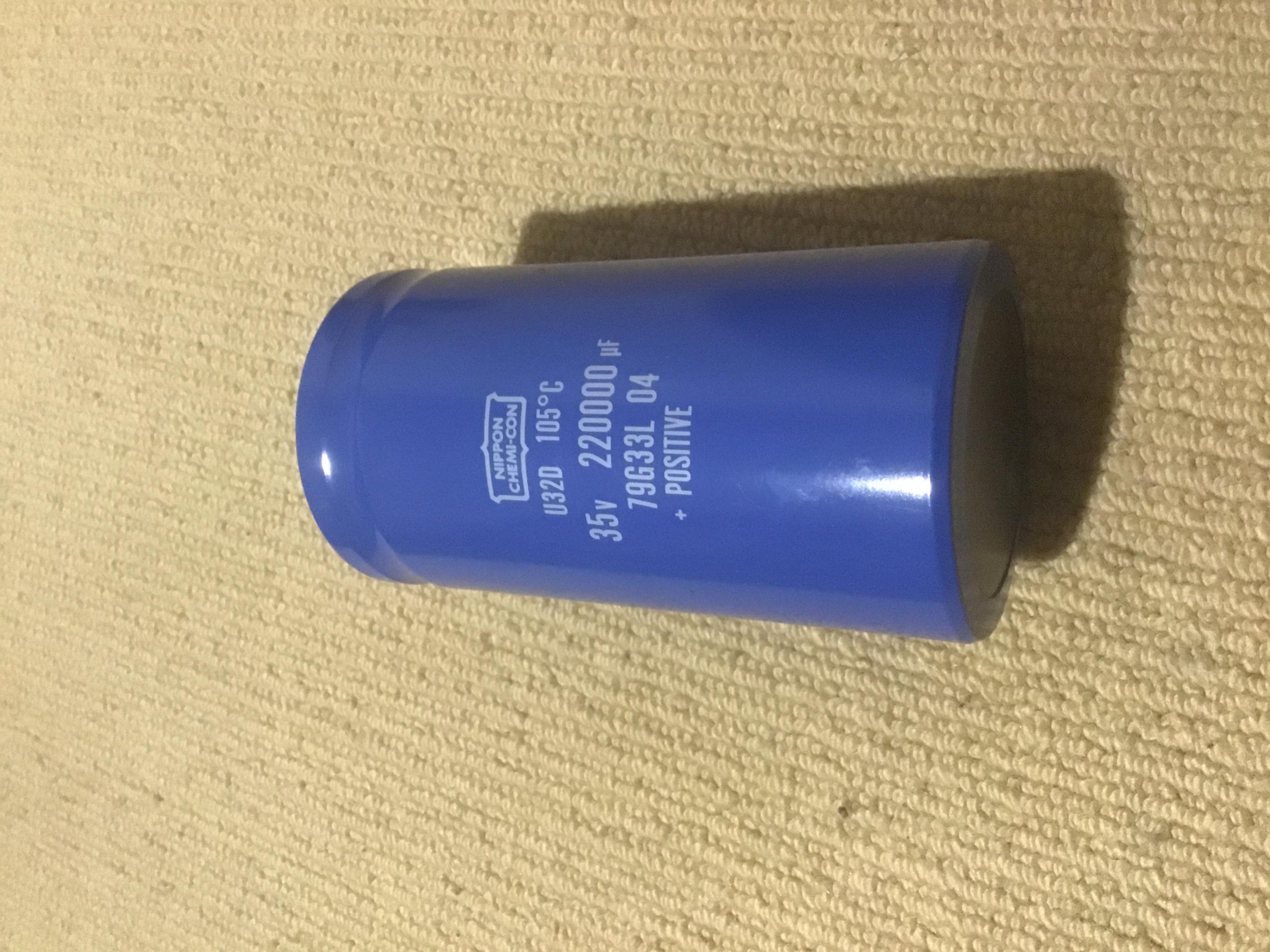

Bloody sissies.
I’ve got over 240,000uF per rail in the supply I am building now.
In another supply 440,000uF per rail.
The bloody thermistor takes care of in rush current.
I have some 20 Ohm thermistors if you want to go up in value, but the stock ones should be fine.
That’s not a cap.
Now this is a cap.
Hahhaha
I‘d say that‘s a capperone... 😀
