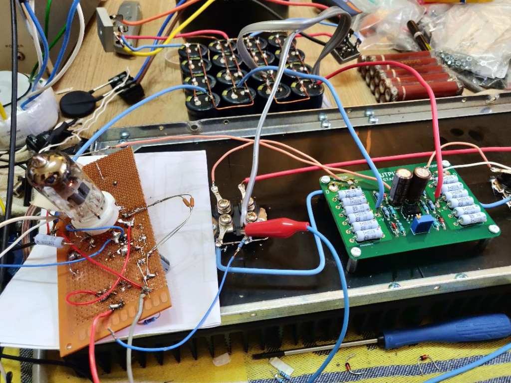

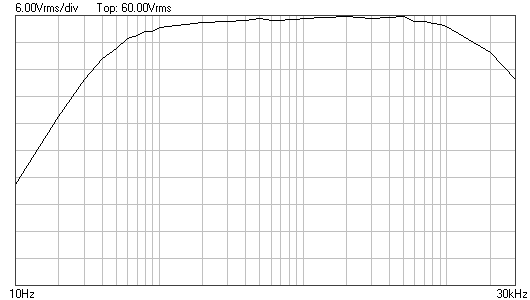

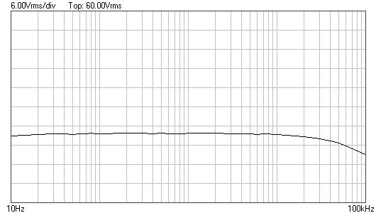

I just did a couple of tests with tube front end. I'm using a PCC88 tube with a CCS loading the plate, operating at 85V and 8mA in anode follower configuration. Found out that I need a low impedance, low distorsion FE to drive the output stage, otherwise I'm getting HF attenuation.
I need to add a cathode follower.

For me sound-wise that would be the last resort option. Rather use a lower Rp valve or an srpp.
