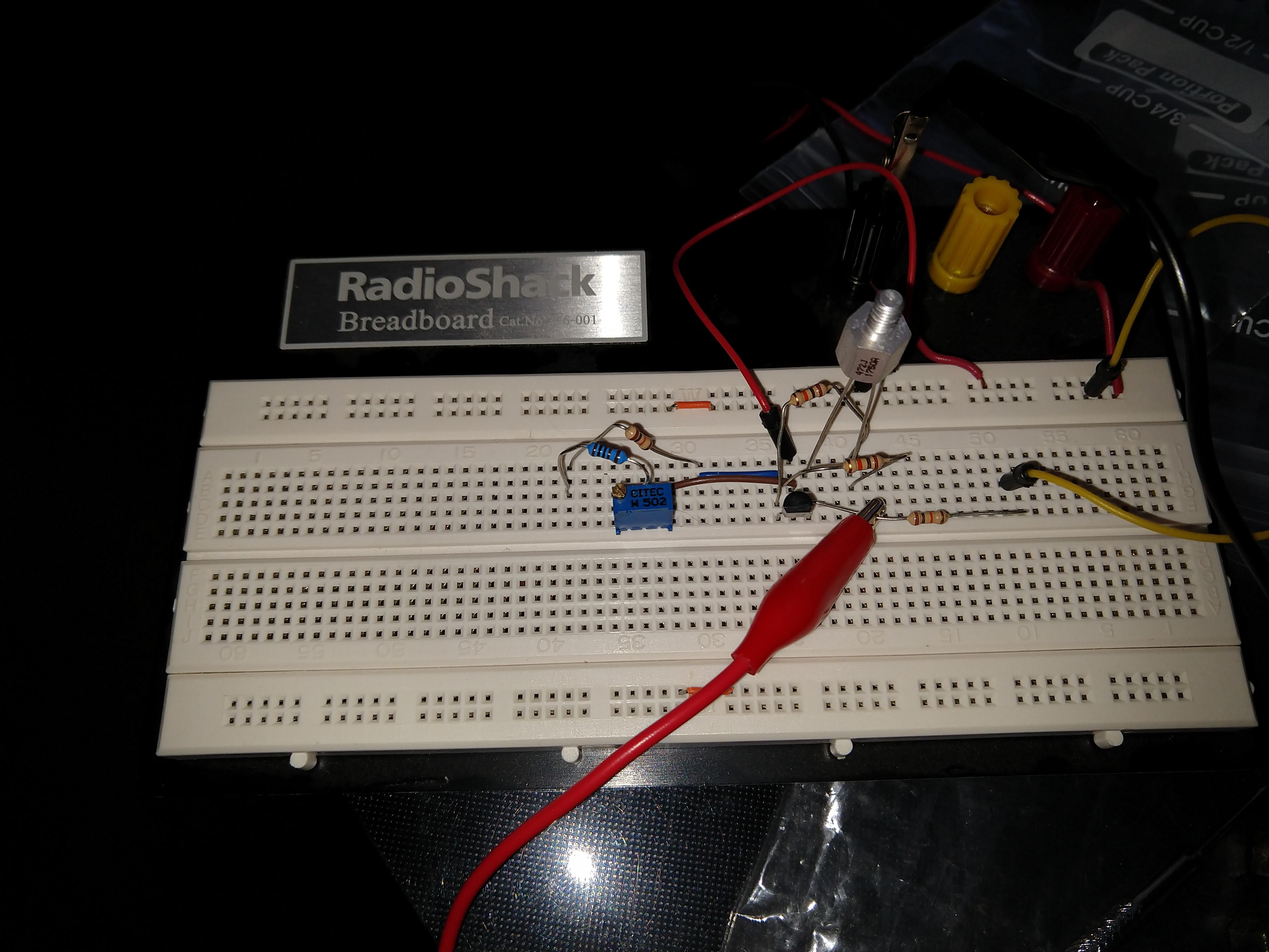

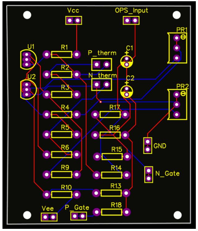

So, the bias circuit is on a breadboard so that I can figure out how the TL431 works and how the thermistor fits into the 431 circuit. That is working in a use-what-is-on-the-shelf manner. The first thing I grabbed was a bag of 10k resistors.

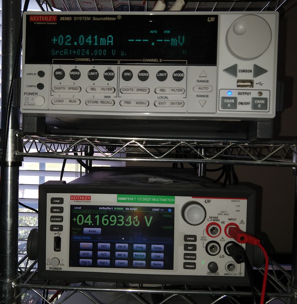

For the N-channel puck, the cold Vgs will be around 4.15V. Warming up the thermistor drops the bias voltage. Bingo. It works in principle. It will need tweaks once the puck is powered and runs up to temperature.
The bias circuit is fed by a 10K resistor that is powered at 24V. The bias circuit draws 2mA.
I played with the TL431 and found that around 1/2 mA is required to flow through the TL431 before the 2.5V ref becomes stable. Below 1/2 mA, the ref voltage droops. There is range of current flow where the ref voltage increases with increasing current and a point where the ref voltage remains relatively stable with increasing current.
For this particular build, the resistors chosen make the 431 ref voltage very stable with changes in the 24v rail.
