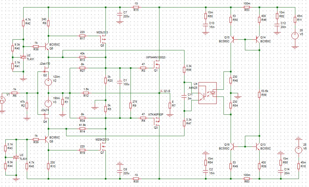

I too have played with many versions and in the spirit of sharing attach the one I found to work best, consistent with not being too complicated. It is not ideal though and I like the look of the latest dual opto solution with zeners more and intend to try it out, i.e. build it.

I like that one. The only problem might be that the cascodes are loaded by the 240R load resistors to the rails, vs. 33k(+/-) resistors with the output fet bias spreader servo. You need to estimate or measure in SPICE the open-loop-gain of that bias servo. It might be lower than the servo on the output FET gates.
I haven't measured the servo open loop gain but it seems to adequately compensate for changes in output stage current so I don't believe it to be an issue. Actually my motivation for connecting the servo as shown is so that it also works to control the bias of the front end MOSFETs.
My experience appears to differ from yours here in that I find the FE MOSFET current drifts without source resistors. I'm wondering now whether it might be better to keep the source resistors and bypass them at AC with capacitors either directly to the power rails or perhaps to a point somewhere along the cascode resistors as you have shown previously. The latter appears to have the potential advantage of a better low frequency response if the point is chosen carefully.
Thoughts?
Thoughts?
Ian: Thinking about it more, the difference in connecting the opto output to the nodes between the JFETs and the cascode BJT emitters vs. connecting between the cascode BJT collectors is the voltage across the opto output transistor. Vce is limited to 30 volts or so on most optos, so the cascode connection solves that problem.

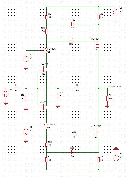

Your point Lynn? I've seen this before and it is what I was referring to by connection "to a point somewhere along the cascode resistors". Are you saying that this is your preferred approach?
I forgot to mention that the above approach has the potential issue that the DC value across the capacitor can be quite close to zero. Consequently it may be necessary to use a non-polarised type which are not that common in the large values needed in this application. Not a show stopper but maybe there is a better way?
In the schematic in post #962, the AC component of Vgs of the j313 and k2013 FETs is not affected by the value of the (DC degeneration) resistor from source to rail, other than ESR (parasitic internal resistance) of the cap. Connecting optos as shown in that schematic makes use of the lowpass filter formed by RC network involving the electrolytic.
ESR and RC time constant are serious problems if you use the simpler circuit which bypasses the source resistor with a large electrolytic. For instance if you want a 47R source resistor for DC degeneration and a time constant of 1 second you would need a 20mF capacitor. You actually need a much longer time constant to keep AC degeneration to a acceptable level. I actually built an amplifier using that circuit but its performance suffered from ESR problems with the caps.
You can safely run electrolytics slightly reverse biased without problems.
I did both a "back of the envelope" estimate and a simulation check of the current gain from the cascode collector to the j313 drain, ie. d(Id(Q5))/d(Ic(Q6)) in your circuit in post #1326. The estimate takes the form R8*gm(Q5) = 240R*.23S = 55x, assuming Id(Q5)=36mA. That means an opto servo connected between the cascode emitters has about 35dB more open loop gain than one connected between the output stage gates. That surprised me.I haven't measured the servo open loop gain but it seems to adequately compensate for changes in output stage current so I don't believe it to be an issue.

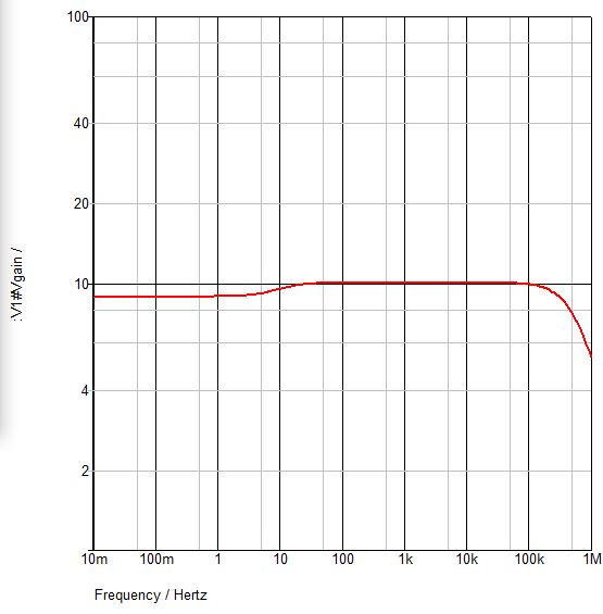

I agree with you regarding simple bypass of the source resistor although I haven't actually tried it in this particular circuit.
Regarding the other form as per your much earlier post, I am not so sure about the source resistor only providing DC degeneration. As you say, there is a filter function at work here and depending on the value of the capacitor, this will impact the low frequency response (open loop). See the attached by way of example.
