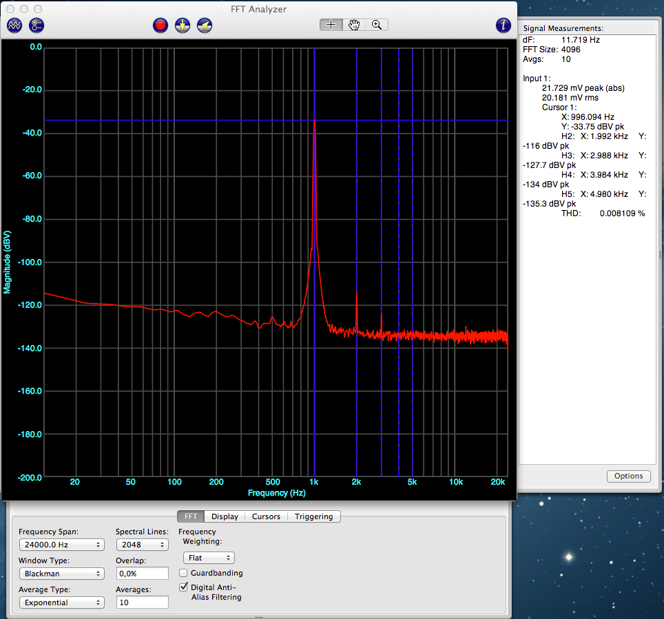

Long live low distortion.....see picture!
but sound dead!
I have to find the right OLG and CLG. CLG is clear 20dB. So I will put in for the gain resistor a small pot and turn and hear and turn and hear and turn and hear......
