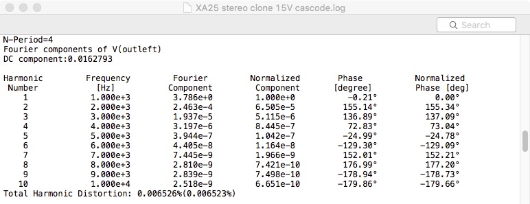

In the case Spice is right the very low distortion values Nelson states are for me only available with cascoded output and with some bootstrapping of the cascode transistors.

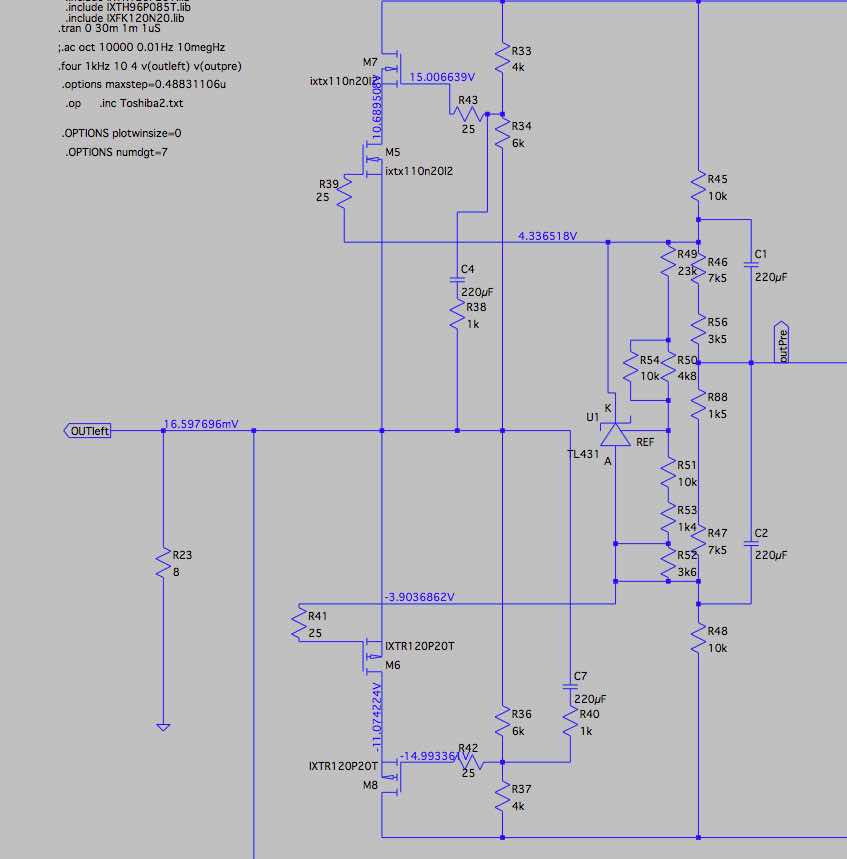

In the Sony II paper Nelson writes "There is one other detail in the output stage regulation; R17/C7 and R18/C8
which bootstrap the Cascode power transistors with about a one-sixth version of
the output waveform so as to get a little more voltage swing at maximum and
bring the output VFETs a little closer to the “sweet spot” of their load line curve."
Of course this detail is crying to be used in the "F4 beast" too.
I am only unsure where to measure the "one-sixth" waveform to get the right R.
And of course "one-sixth" might only be correct for the Sony II.
These are the limits of a box of bricks amp builder....😀😀

I'm getting very low distortion without cascoded output.In the case Spice is right the very low distortion values Nelson states are for me only available with cascoded output and with some bootstrapping of the cascode transistors.
What do you think lhquam?
You can cascode if you want, but the main reason papa did so in Sony is because the sony devices produce triode curves.
The IXYS devices are strongly pentode and capacitance isn't that high to lose sleep over, so adding cascode is really a personal choice not a requirement.
CFB allows you to achieve the same result without adding degeneration to the jfets, it also adds a form of Schade feedback to the front end.Maybe this CFB method is better.

Good point. I had forgotten about cascode local feedback, which might be a good idea in order to tame the gain of the undegenerated front-end.

.....here cascoded and bootstrapped, by the way it was all done already by lhquam in Villars Amp with some different values.
