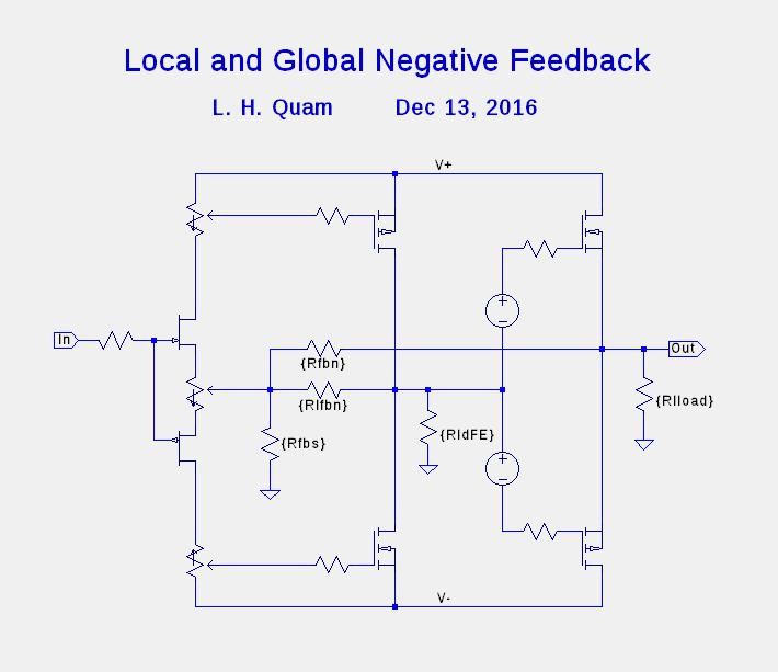

Ok Laterals are a little better for temperature coefficient but Toshibas aren't that terrible if biased in the same range as the laterals.

Ok Laterals are a little better for temperature coefficient but Toshibas aren't that bad if biased high enough.
but in the frontend we use normally 36-50mA...
Yes but the Laterals need 200mA to hit zero tempco.
Compared to what? Nothing wrong with your circuit though.Adding the local negative feedback resistor Rlfbn will get rid of excess open-loop gain and lower the output impedance of the FE stage.
My circuit doesn't have excess open loop gain.
o.k. lhquam, is there an advantage over the Cascode Feedback? Papa praised it ....
I already told you the benefit of cascode feedback.
