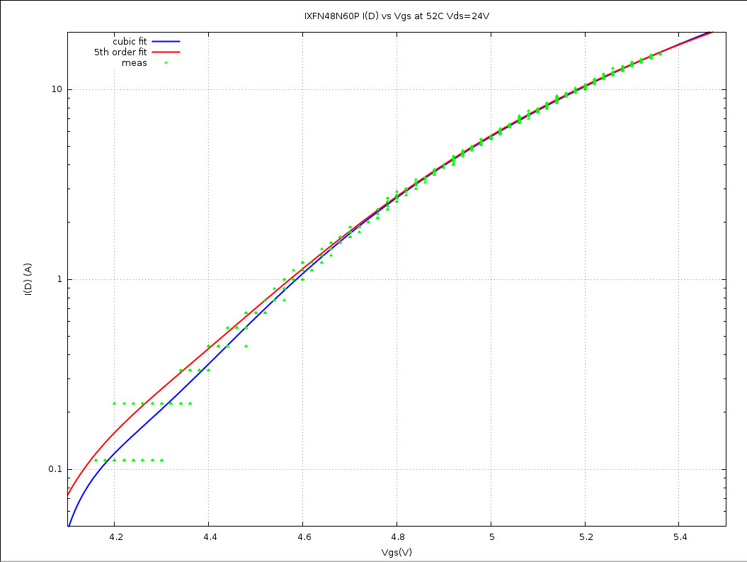

Attached is raw Id vs. Vgs ramp data and jpeg files from of Rigol DS1054Z screen. I also have performed least-squares polynomial fits to that data, shown below. The columns in the raw data files are : Vgs, Id. The accuracy of the raw data is on the order of 1%, but the polynomial fits are much better.
IXFN48N60P
poly3: Id=8.92663*Vgs^3-111.878*Vgs^2+468.086*Vgs-653.668
poly5: Id=-3.31238*Vgs^5+76.9572*Vgs^4-704.511*Vgs^3+3187.0*Vgs^2-7140.02*Vgs+6347.62

Some more info: The measurements are at approximately 50C heatsink temperature. I used a 1% 0R18 current sense resistor for the Id measurements. These sweep measurements were spot checked against measurements made in very a different manner and they agreed within 1%-2%.
I am glad to brought up this subject. It made me realize that I should be able to predict the push-pull harmonic spectrum of the output stage driven by a perfect front-end for a low frequency input. It is a relatively simple procedure.

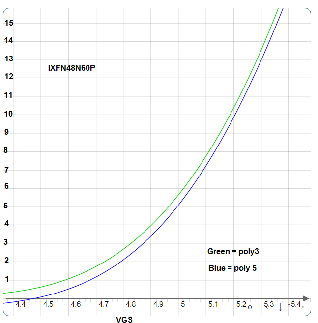

You are partially correct. I truncated the number of digits in the polynomial coefficients, and it shows for Id < 1A. Here it what my plots show. Note the vertical axis is log-scale.

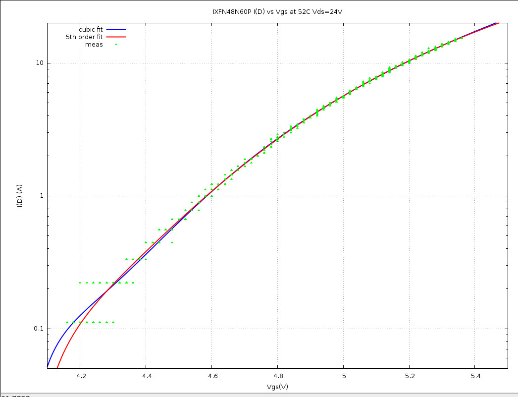

Here are the polynomials with 2 more digits per coefficients.
IXFN48N60P
poly3b:8.9266293*Vgs^3-111.87771*Vgs^2+468.08582*Vgs-653.66802
poly5b:-3.3123769*Vgs^5+76.957238*Vgs^4-704.51148*Vgs^3+3186.9992*Vgs^2-7140.0232*Vgs+6347.6198
I am working of a better set of polynomials expanded around either the and estimate of Vth (threshold) or Vgs at the idle current.
Plot on the left: 6 digits per coefficient.
Plot of the right: 8 digits per coefficient.
