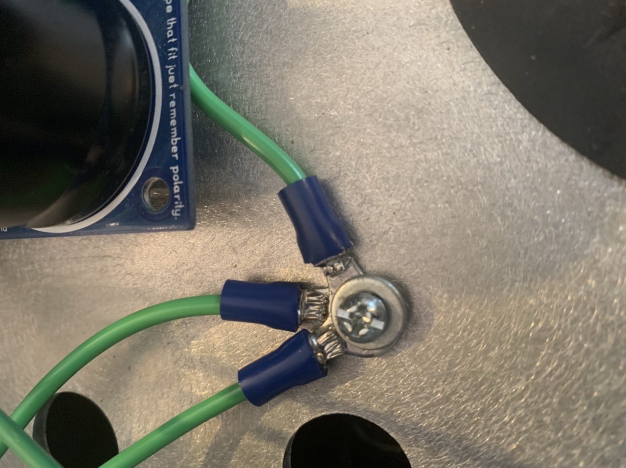

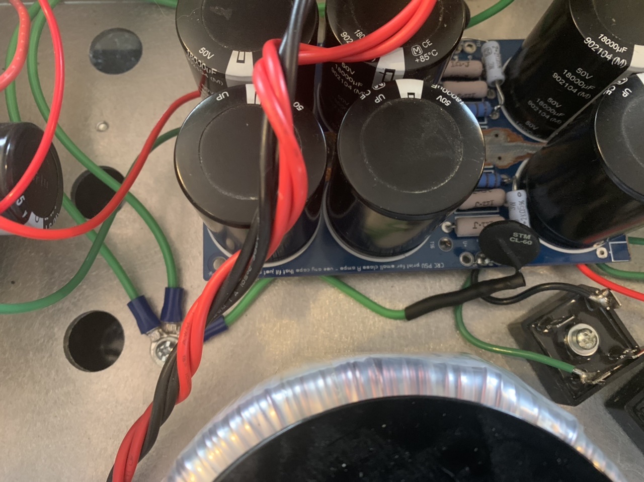

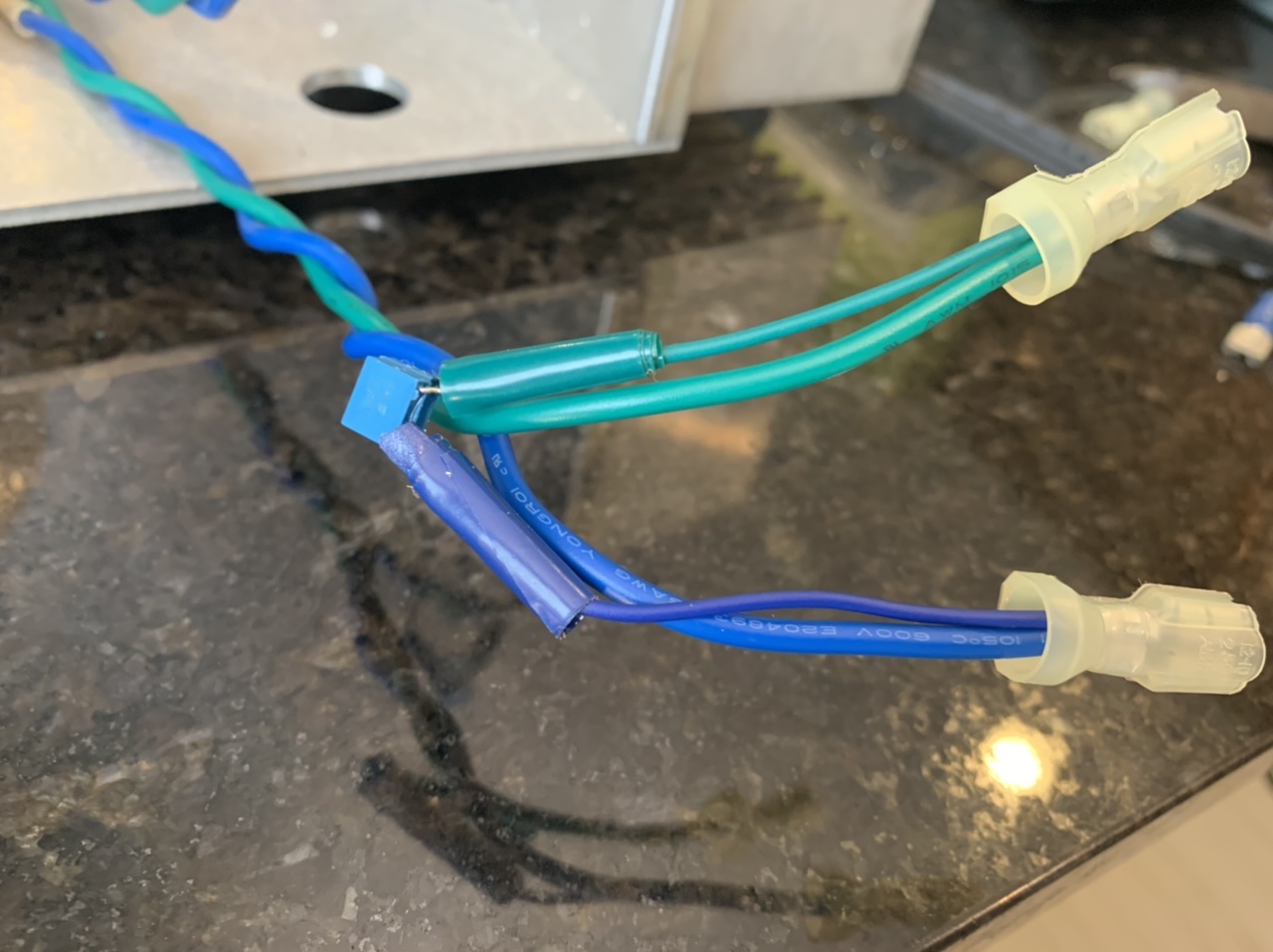

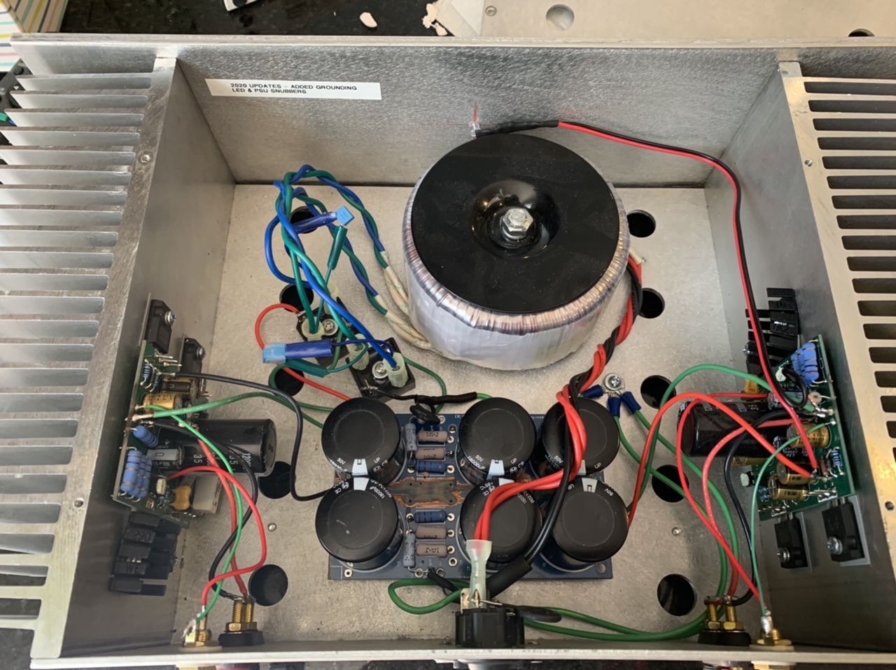

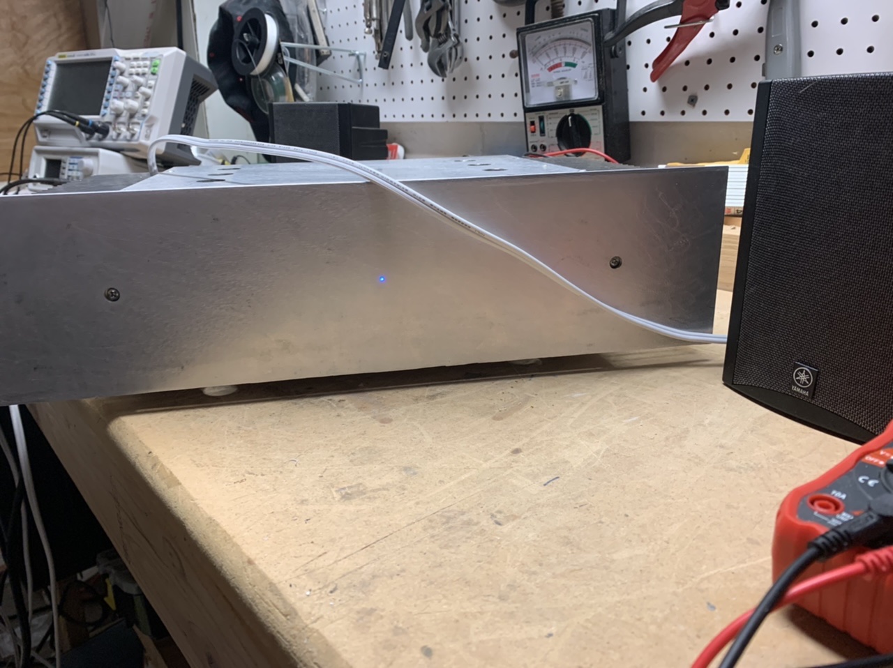

I got my F3 up and running. It is a Rawson build that I saw on audio mart at a nice price. Having updated a pile of rawsons last year, I thought I’d try this F3. I added grounding - it was totally absent. Classic rawson. It looks like the F1 psu, or Jeff’s up above. 2 single rails, each rail with a cl60 to chassis. And I have the mains ground to chassis, that was missing, too. I added snubbers and a power LED. Blue, of course. It sings on the test bench.
No other mods yet. All caps are original. Perhaps I’ll go for enhancements in the future.
I’ll try it on my horns this week. How will it compare to the mighty SissySIT?

nice amp per se
of course, Blue Led being a necessity, Papa's secret ingredient
to relieve more of secrets - one channel must have Blue LED powered from positive rail, while second channel must have Blue LED powered from negative rail
when having single rail supply, just one channel's LED is allowed
............same breed as Sissy, but Sissy being more equal animal

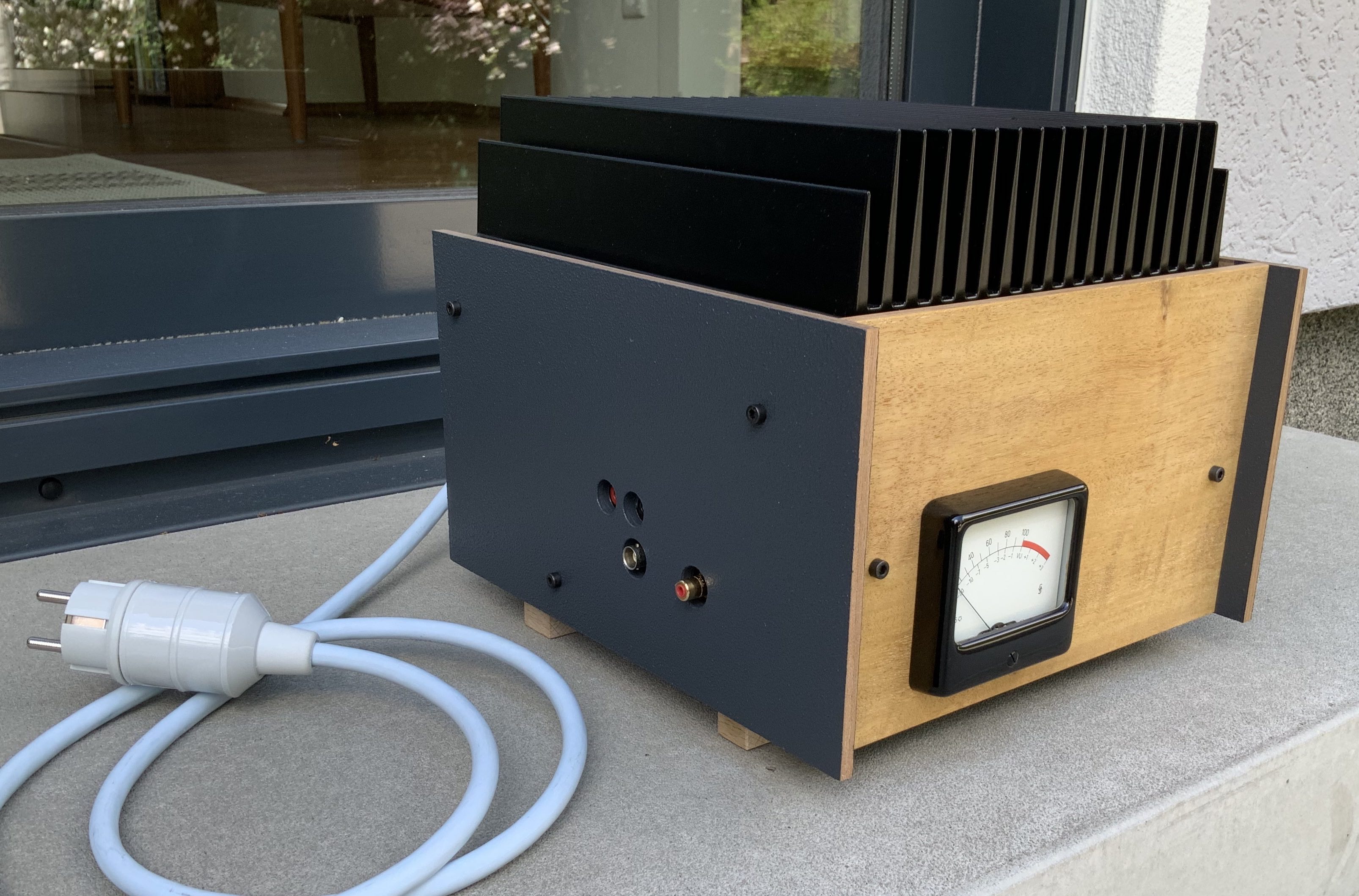

Finished a mono pair F3 clones…
Thanks to Mr. Pass and the solid contributions here in the forum!
These amps sound sweet[emoji445][emoji106]
Nice one.
Thank you guys [emoji106]

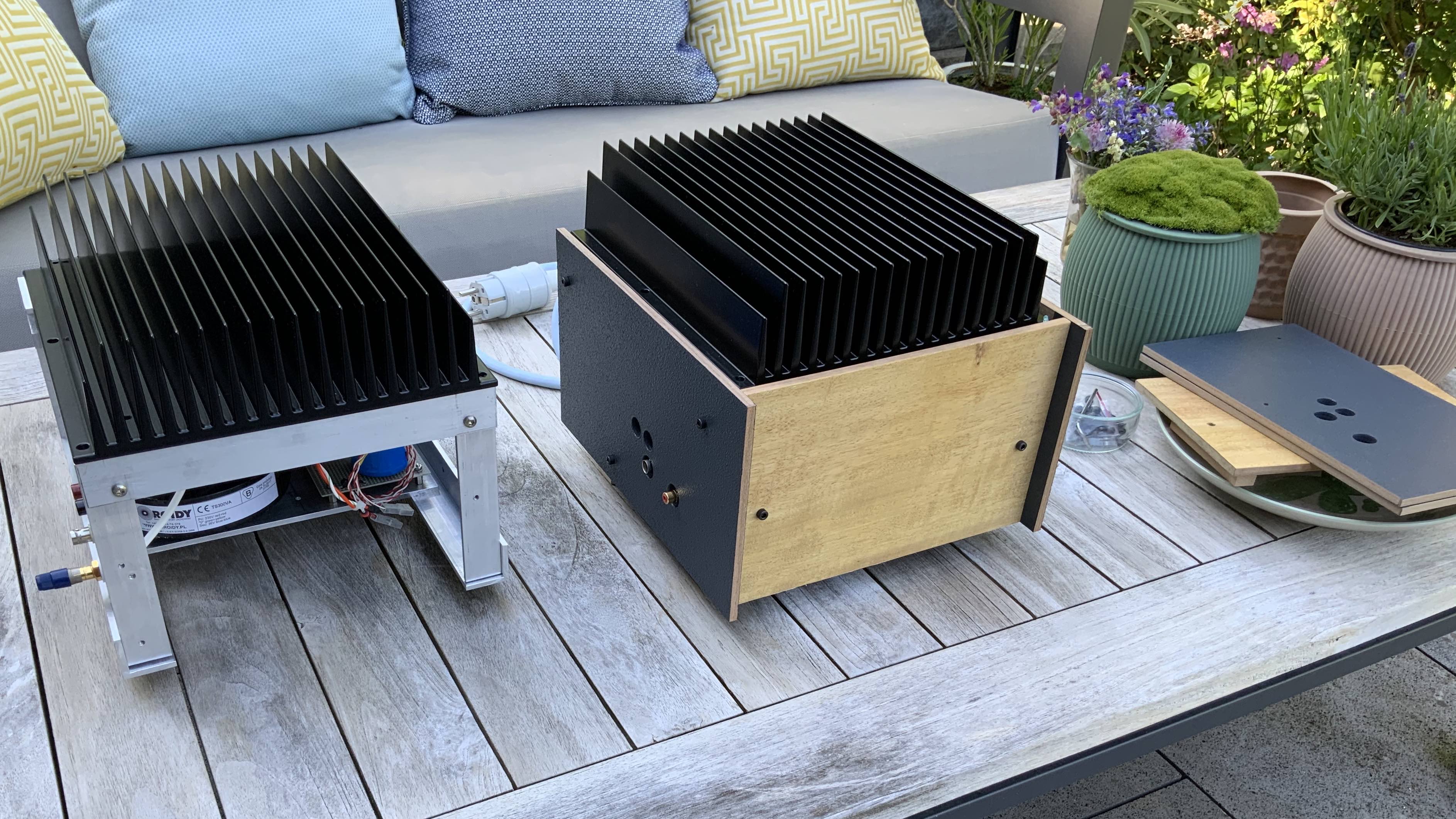

It was a fun project with a lot to learn about the LU JFet and the triode cell. Meanwhile the amps received an update.
If anyone wondered, the BNC connector is directly wired to the amplifiers output to drive the F4 that is coming [emoji3060]

Thanks. I liked the shape with the lower fins at the end. I have six of them in total. So F3, F4 and one tbd…

May I know why the LED needed to be blue and not RED, GREEEN etc...
And why only one channel if for single rail?
At risk of publicly confirming a nearly complete lack of knowledge, let me try to expand on ZM’s succinct (but I think lighthearted) notes.
The LED can be any colour - blue is a kind of signature for some Pass amps, so maybe the builder intended it as a bit of an hommage to NP. Or maybe blue is a favourite colour - who knows?
One thing about blue LED’s though, they can be noisy, relative to other colours. For a single LED one could opt to move the tap to a reservoir capacitor in the power supply board where any injected noise can be dealt with a bit better.
now seriously- that LED part of my post - 158% joking
regarding LED noise - in 99.9% of cases, that's Audiophoolery
any power amp is hardly possible to even get a mile near to remaining 0.1% of cases
