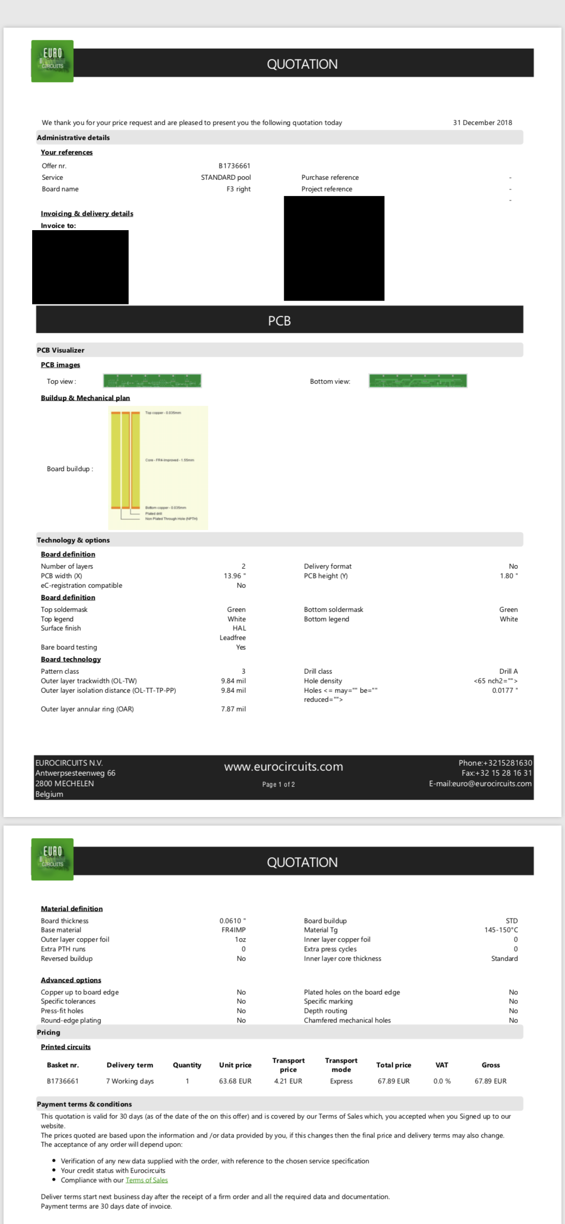

As I mentioned, I only appeared to have accidentally uploaded the file for your left F3 channel from my Apple device at Osh Park and got a quote. Having 3 new complete matching channels made by them would be too expensive even though I have extra single rail power supply boards from my F2 project.
I registered at Eurocircuits and when I browsed for the files I had unzipped I found several labeled “F3 right” with various sizes, dates suffix descriptions such as “cache” nd the like. I decided to select the most recent and largest file (185KB). It appeared to work.
The website generated an initial quote that I was able to modify. I changed the options you mentioned as described and got a second quote for about 64 Euro.
Since I’m completely inexperienced at this, I wanted to attach the pdf quote they generated to ask if everything looks as it should before ordering anything.
I’ve never attached a pdf to a post before. Hopefully this works.
Edit: Didn’t want my personal info visible...tried an edited screen shot.

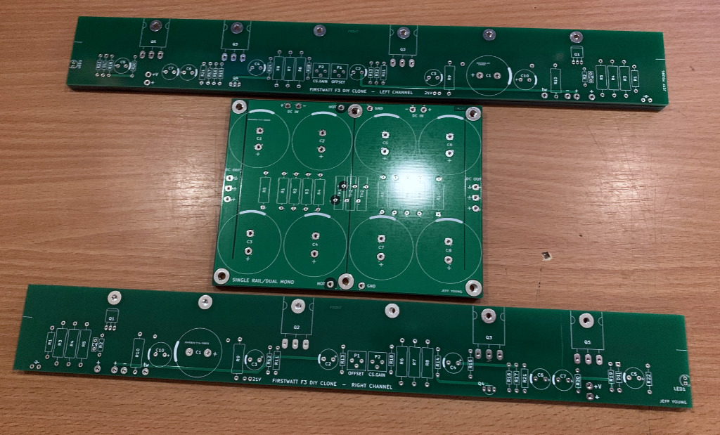

Hi all,
only for EU ... I have 1 set left and only with tracking and as package, because the size of the board and to many "not arrived" from other projects.
One set (3 Boards) for 20€ + shipping
Thanks to Jeff and Mr. Pass!
[EDIT] If enough interest I think about a second run
