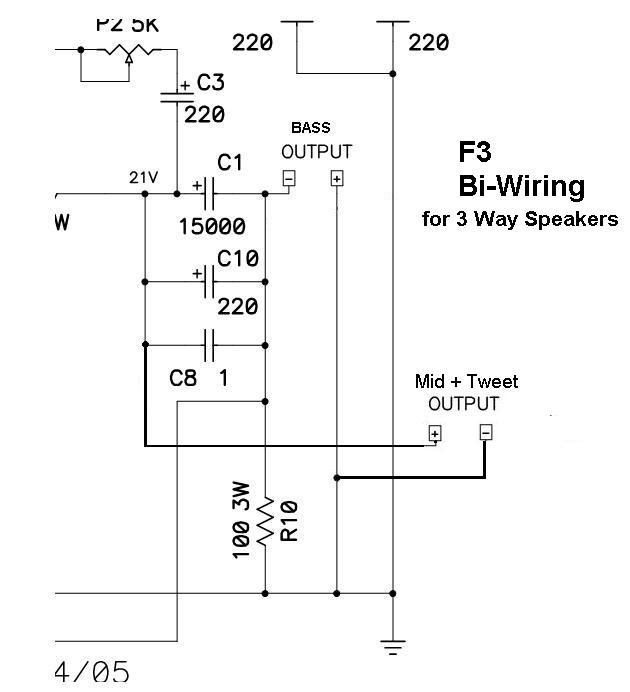

Correct me if I’m wrong.
In my opinion polarity should by reversed:
sts9 said:
Correct me if Im wrong.
comparing to what ?
Papa drew that "-" on output of amp - to preserve absolute polarity .
connect spks as you wish , but all in same manner .
