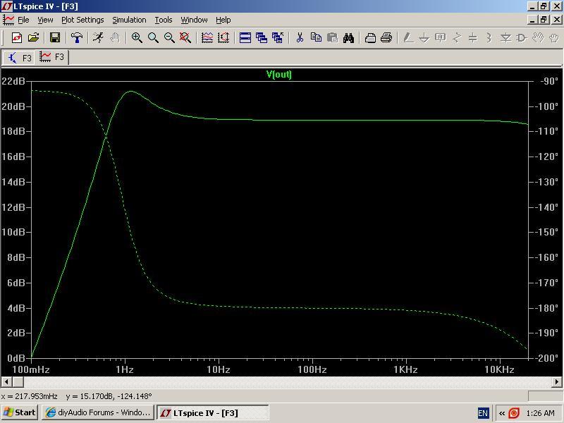

In case anyone would like the LTSpice schematic here it is.
The funny thing is I couldn't get the desired votage at the drain of the mosfet using the values from the service manual (I think it is meant to be 21V or 23V). I had to tweak some resistor values. It's not perfect but pretty close.
I did a frequecy response (LTSpice) using 1000uF instead of 15000uF. To me (don't trust a word I say) there doesn't seem to be an issue. There is a peak (small hump) at 1Hz which falls quickly, but other than that I can't see a problem using 1000uF instead of 15000uF.
Anyway have a look at the attachment

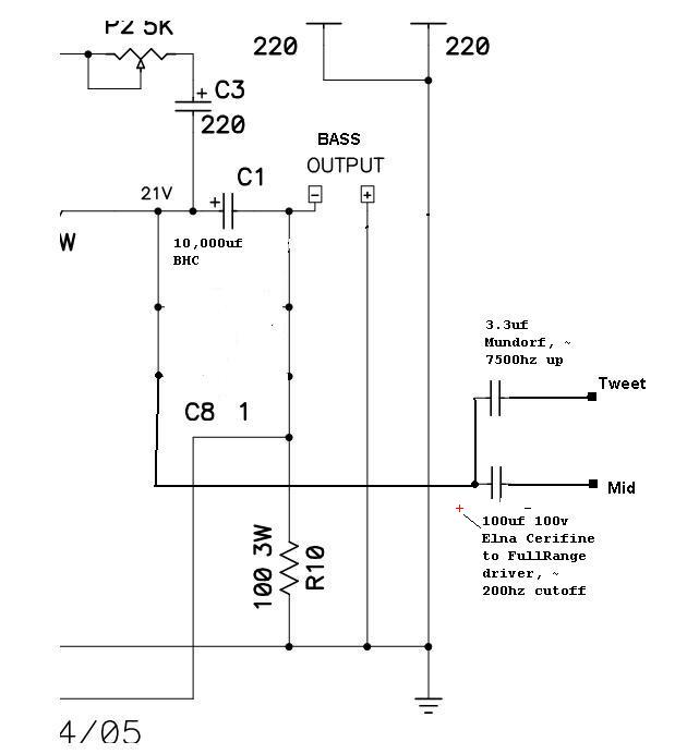

Peter Daniel said:If I can suggest something for multidriver speakers, is to split the output caps between drivers and use whatever is needed only.
For instance, in my particular setup, I'm using 6.8uF Siemes MKV in tweeter network (1st order filter) and BG N 330/100 with the midrange driver (again first order filter only). No need for other big caps. If you have a woofer, then you can put 10,000uF cap there too, but it could be separated from mid/high output.
Peter,all
this sounds like an interesting concept if your talking about using both the 330uf and the 6.8uf out of the same amp.
I am not sure how your wiring it however if this is the case, if they are paralled as Nelson does it, then taking multi-taps off the + side of cap seems to make no difference.
If your using a different layout, I would like to know what it is.
I assume that C1 can only be one value, and that value determines the low filter frequency.
I would not mind some advice on how to calculate this. I am considering using it to run at 200 or 300hz on up..
Mike
crossing over
I think I may have thought this through a little better. forgot first order xo is cap.
C1 area - would look something like this,
+woofer - +mid - +tweet-
-----(neg 10,000uf+)---(-)330uf(+)---(-)6.8uf (+)---100ohm R10)--
R9
Maybe? Do-able?

This is probably one of the best mods you can do to this amp. I was originally using Jensen 10,000/63 and it was not bad, adding 0.1uF V-Cap bypass improved high frequency clarity at the expense of naturalness, but using dedicated cap just in a tweeter network brings this amp into completely different league 😉

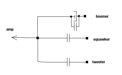

Ok I am starting to get a clear picture about this mod.
I am not sure if this is the same idea you had or not.
What I am thinking is running a bi-wire setup from the amp. The original out goes to bass drivers (Which run up to 2000Hz).
I then run another output before the capcitor network on the amp straight to my tweeter crossover network. Since this already has quite large capacitors in it anyway, I shouldn't need to add another cap ahead of it.
Is this the same way you did it?
Yes, that's correct. Regarding your earlier question, the size of the cap has nothing to do with DC protection, only the voltage rating, and with audio signals, this shouldn't be an issue at all.
Thanks.
I wasn't thinking straight before.
Besides doing this mod I think I wll also still change the 15000uF with a 1000uf Elna SIlmic

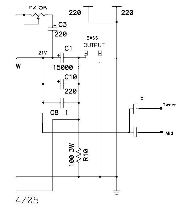

Re: Re: Re: Re: crossing over
I did some potentially correct 1st order XO settings, optimized for the values I have around..😀
This version may work for those with a FR used as wide band, with help from WOOFER and Tweeter on top end.
This of course assumes I didn't forget something. Never used a e-cap in a crosssover, but I guess this can be thought of as part of the amp, sort of.
Thanks ZM for drawing.
T
T
