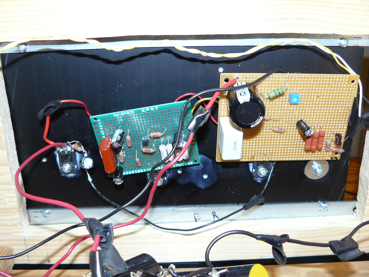

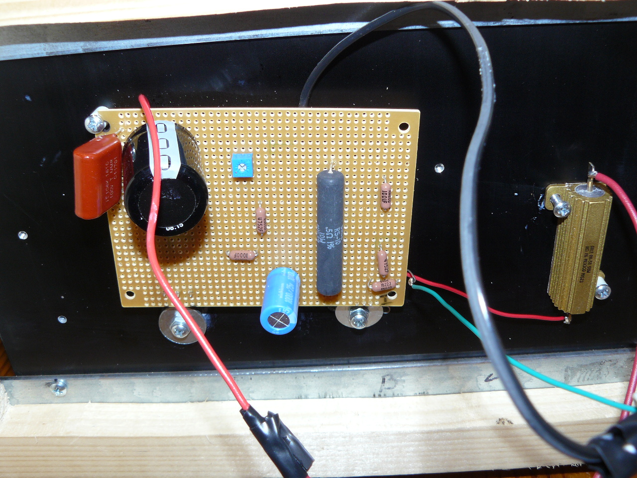

I tried to install the cap multiplier noise reduction circuit in the Zen 8 build and my Antek 400VA transformer that had a slight amount of buzz grew much worse and this was with just one channel hooked up. Instead I decided to just delete and add parts to my board to build the Zen 9 which was my plan to begin with. I built the Aleph current source on a separate board and the cap multiplier is just built pp. This is my test box with heatsinks and PS I use to try my projects. I understand this is the F3 builders thread but the F3, Zen 8 and Zen 9 are interconnected and I decided to post here. I admit to being just a solder slinger and this is just a test amplifier and not intended to be used as a dedicated amplifier. Built only to play with different amplifiers so excuse the messy build but it runs and sounds fantastic with my horns. It was not without problems. Building on proboards give me the most trouble because after determining where the part should go and flipping the board everything is in reverse but I love the challenge and this kind of build is more satisfying for a solder slinger than a ready to stuff board. I admit to 2 days of running down errors in both channels but it now works. I have not scoped the build yet but I should find time today to do so. The placement of the boards was determined on where I already had holes drilled and tapped. Lazy
No problem with that.
Keep updating.
Pictures are good too.
I have been enjoying this build tremendously with my horns. I did take the time to scope this build and was surprised at the good looking square waves I saw, better than some ready to stuff board builds. This build is like many of my lady friends of past years, not very pretty but sweet. At least at first. With horns single ended amplifiers just sound so natural and sweet.

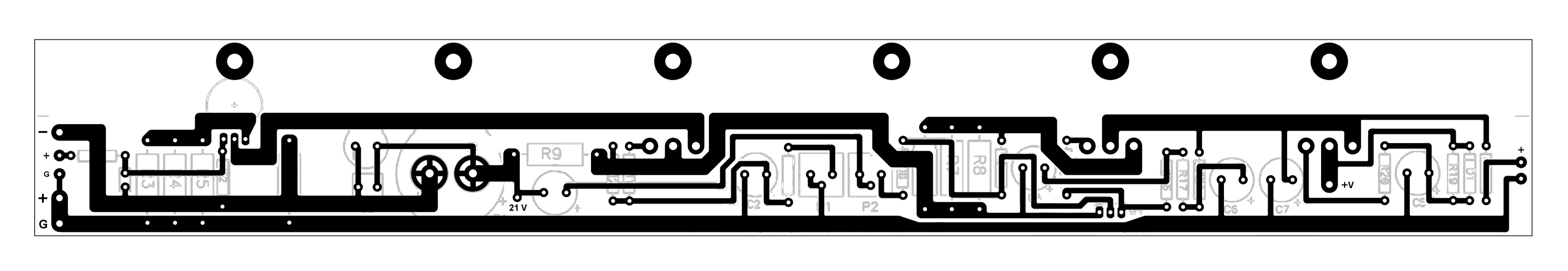

I'm just starting a DIY version of the F3, and trying to keep close to the internal aesthetics of the production version. There's something about the horizontal, long & skinny boards that really appeals to me.
Since I'll be using the toner-transfer method for my PCBs, I'll have no through-plated holes. While that doesn't necessitate a single-layer design, it certainly encourages it. With that in mind, I've done a layout of the right channel on a single layer. I thought I'd post it here before doing the left in case there's any feedback about doing something different.
Jeff.
Jeff.
