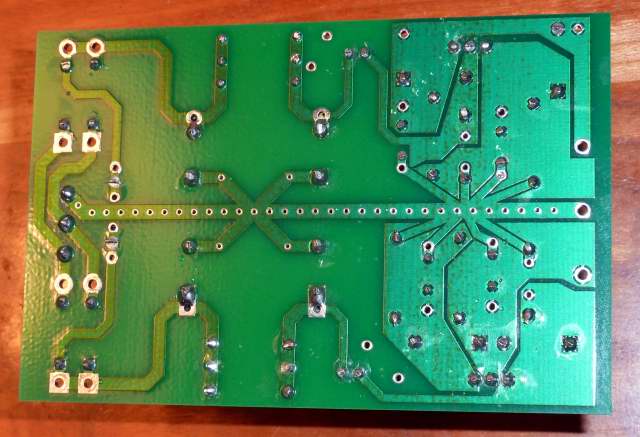

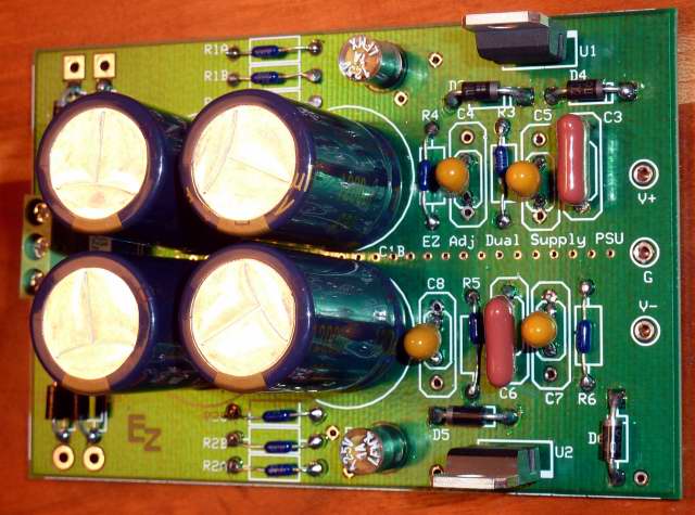

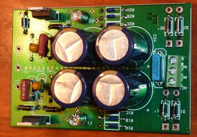

I put together my EZDual tonite, and am having problems with it. Trafo reads 15.1v - 0v - 15.1v, the centertap is hooked to AC2, something seems to be pulling current with no load. I get 13.4V -0v - 13.4V from the trafo when hooked up to the board. With power hooked up R2A,B,C get warm. Even if I disonnect AC3 and leave AC1 hooked up R2A,B,C gets warm. I checked for obvious shorts, but so far I haven't been able to find any. I'm pretty much a newby at electronics, and any help would be appreciated. I've attached some pics of my build.

First check the polarity of the tantalum capacitors C4,5,7,8. Especially C7 & 8, the + side of each should connect to Ground.
Then check the DC output voltage. If it's slowly decreasing after you wait a few seconds, it is probably those capacitors. I'd bet on C8 causing the problem.
Oh, yes, wear eye protection! They can explode.
If you know for sure that a tantalum capacitor has been reverse- or over-voltaged, replace it even if it seems okay.

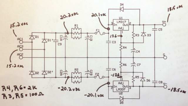

Hi Guys,
I removed R7 and R8 and replaced them with some electrolytics that I picked up at Radio shack. The good news is that solved the heating up problem, the bad news it that I'm getting+/- 18.5 vdc on the psu outlet. It looks like something is going on in the regulator area. I've attached a pic of some voltage measurements that I've taken. I'm am a bit confused by all of the different BOM's for the PSU so I'm wondering if I used the correct choice of resistors.
PJN
PJN
Yea it is confusing especially if you don't know what you're doing like me. I'm glad I have your BOM for the EZDAC.
If you're using the LM317/37, make sure to read the datasheet. The formula for calculating voltage is very simple (assuming the adjust current is negligible). I always assume people don't take my BOM values on blind faith, but I suppose that has not been the case.

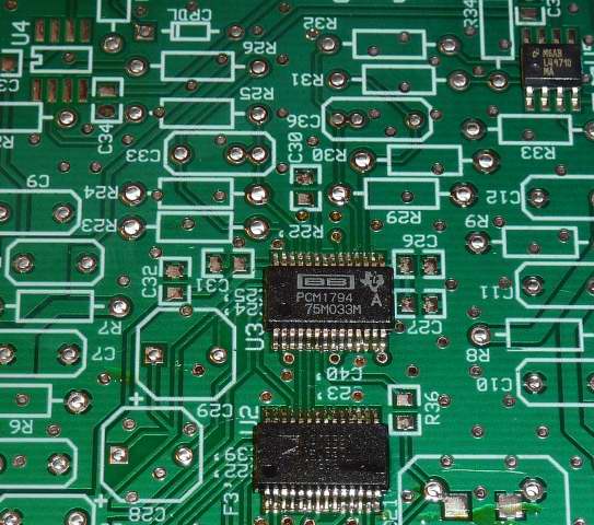

Hi All,
After watching a primer on SMD soldering on U tube I finally got the courage up to try any start populating the DAC board. It wasn't so bad after all. I do have a question on the orientation of U 4 and U5. In the picture that I've seen folks used the AD8610, but I used the LME4971 since digikey was out of the AD8610. In the attached pic I have U2 and U3 attached, but U5 is just sitting there. Is the LME4971 in the proper orientation to solder in ?
Thanks,
PJN
Thanks,
PJN
