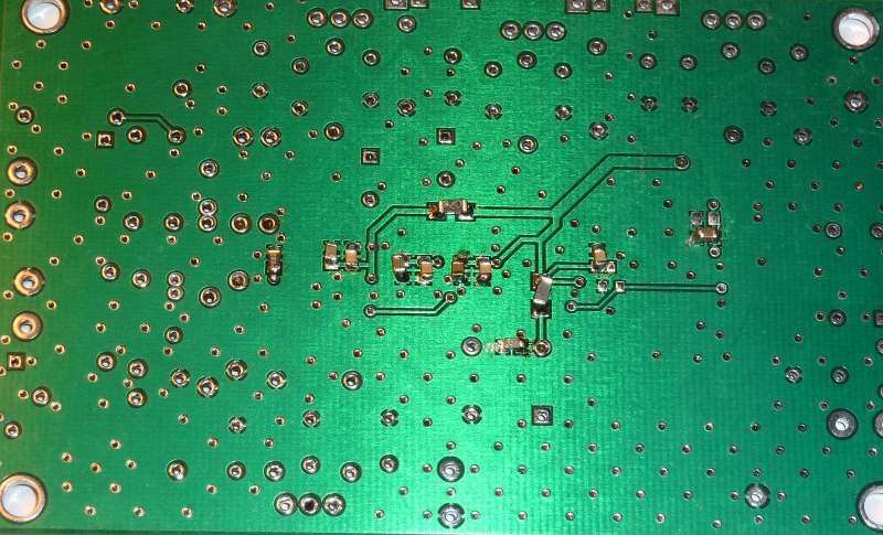

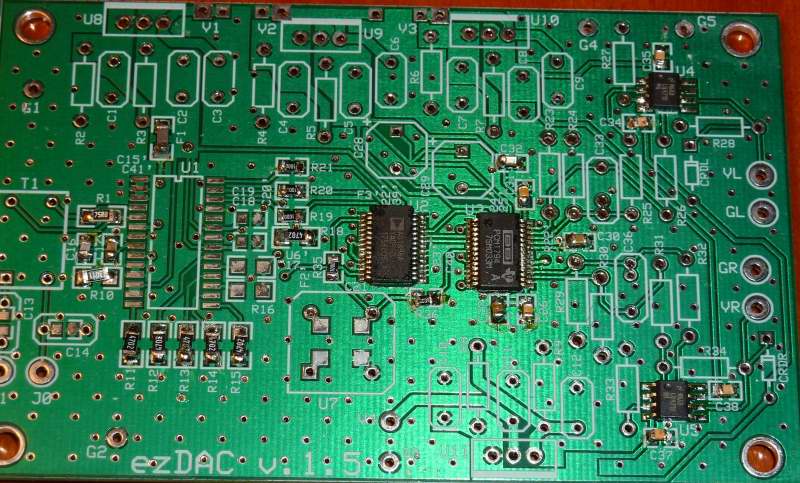

Update on progress,
I have installed most of the smd's except for a few around U1 and C15, I'll put them in after U1 is in, I'm waiting on the rest of the parts to arrive. Those tiny caps were a real pita, they were worse than the IC's. I do have a couple of questions.
On the btm right below C20' I'm guessing that is where U6 with the three legs goes, am I correct ?
Has anyone installed another clock for U7 other than the one's in the BOM ? Is there any available that could fit on the board that would make a difference ?
You need good magnification, small tweezers, thin solder, and a thin iron to do them. I apply solder onto one pad, then slide in the SMD part from the other side as I'm re-heating the pad. Then solder the other side, and come back to the first side and re-flow, applying more solder if necessary. Sometimes you need to push down gently on the part while re-flowing one side or the other, to make sure the part is flat on the PCB.
flux flux and more flux is my secret for SMD, makes it so much easier to get a nice shiny smooth joint. can be a bit of a pain to clean later, but I find it worthwhile as it also means much less time is needed to get solder to flow properly meaning the chips are subjected to less heat. for tiny SMD caps and R's, the price of a high quality pair of tweezers (actually I have both straight and curved type) are worth their weight in gold
Yep, that's the place for U6. It's a bit tight, so close to the capacitor.
The v1.5 board can hold a standard half-brick oscillator and an SMD type. For the half-brick, at this frequency the options are limited at most suppliers, if you can get one at all. Your best option here is a Tentlabs XO, that will run on 3.3V as well, and is indeed a low-jitter component.
In SMD, you need a 5x7mm. part. There are a few suppliers that actually specify some form of jitter, so getting the lowest one seems logical. You can leave the ones that don't spec anything here. The frequency stability, mostly indicated in 50, 25 or 10ppm is often promoted as THE MOST important factor, but this is the long-term stabilty and has nothing to do with jitter.
For example: Farnell 1640947 and 1641004 or Digi-Key 631-1120-1-ND, 887-1173-1-ND, CW449CT-ND, CW528CT-ND, 535-10077-1-ND, 631-1186-1-ND and CTX326LVCT-ND.
And then there's the DeLuxe solution: The Flea 🙂
