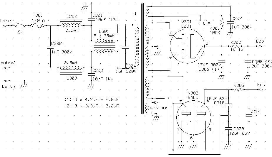

Heater supplies should not float, so the EZ81 heater secondary needs to be connected to something. Connecting it to ground puts a high voltage across the heater-cathode insulation - which is designed to cope with this, but may fail. Connecting it to the cathode puts a high voltage across the heater secondary insulation - which may or may not be designed to cope with this, possibly depending on the age of the transformer and exactly what the datasheet says. Using a highish value resistor as Osvaldo suggest would be a useful precaution.

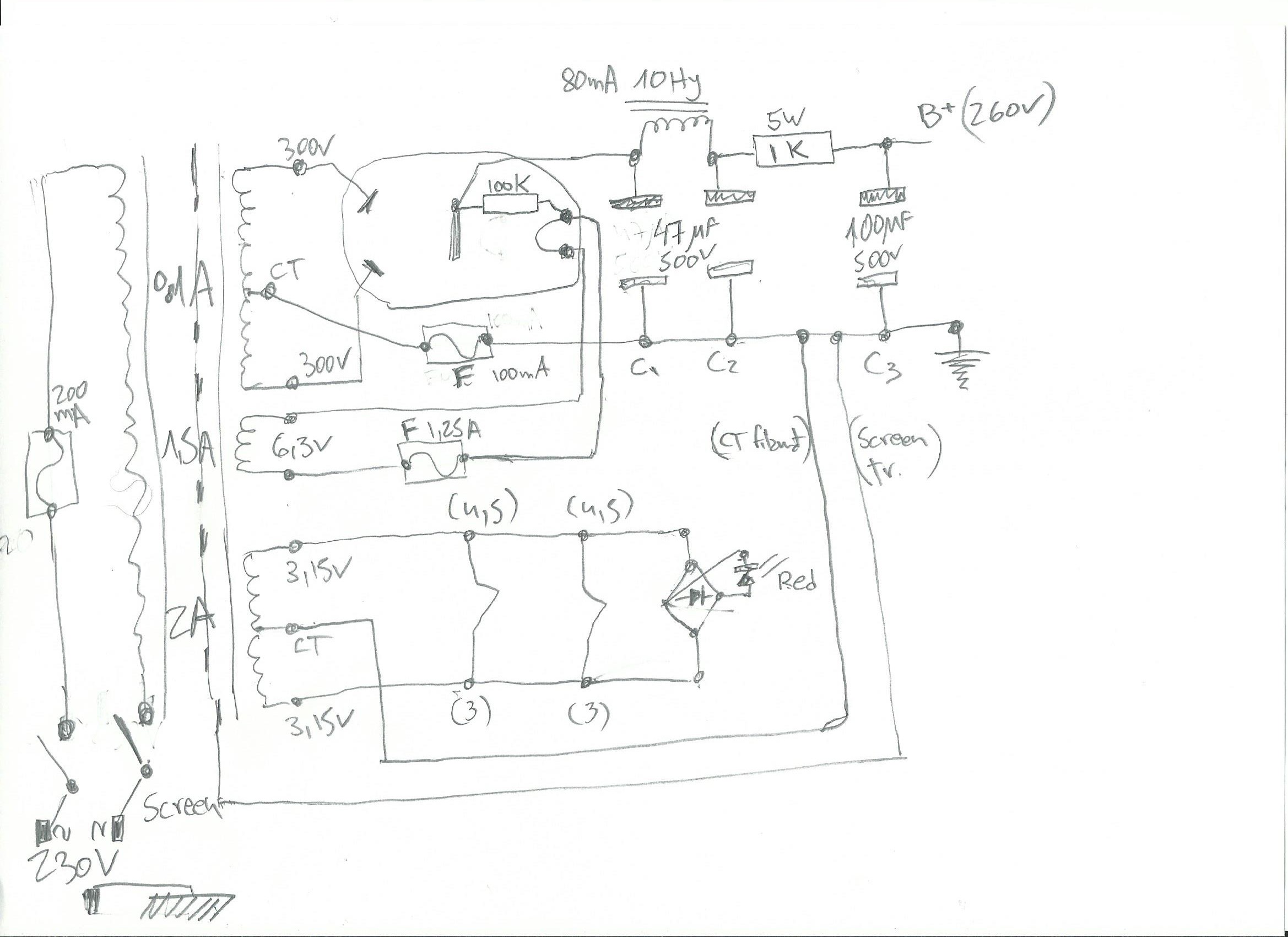

i realize now that one fuze on the ct = puting one on each 300v...
my transformer is newly wound, and the sec for the EZ81 heater is 6.3/ 1.5A
can i conect the pins 3 and 4 of the EZ81 with a resistor? if so, what value and W will you suggest?
Not necessary, but in my own experience, recommended.hi
if i have a separate 6.3v winding for ez81 is it allso necessary to have the cathode and heater at the same potential?
I use a 47 or 100KΩ and a 1µF 400V from pin 5 to gnd. Also, nor the C nor the R are mandatory, but I use them, as in the DOS schematic.
100k, 1/2W?
This resistor does't conduct any current, so a 1/8W is sufficient, but for commodity I use ½W.
This is my circuit.

I've never seen anybody worry about fusing the heater supply. A fuse on the primary side of the transformer should cover you unless you are worried about damaging an irreplaceable vintage power transformer I wouldn't bother.
For safety reasons I'd add bleeder resistors across the HT capacitors.

No need to fuse heater supplies. The CT on a heater supply does a completely different job from the CT on a high voltage secondary, so fusing the heater CT achieves worse than nothing: it simply inserts a point of failure while protecting nothing. Think about where the currents flow.

see below my ps as it is now
i started the preamp yesterday for the first time and took some measurements
i am geting 308V not 260V
so the plate V for the 12b4 is 116V not 90
i want to add a bleeder resistor, although the caps are bleeding when i close the amp (?)
if i add a bleeder resistor
1- will it drop the b+ ? ( before i change the 1K resistor )
2- were to place it for better regulation? C1 C2 C3 all of them?
3- how can i calculate the values of the resistor for better v regulation, W and R ?

Running a circuit designed for 260V from 308V will do no harm.
A bleeder resistor is for safety, not voltage regulation. If you wanted better regulation with an unregulated PSU you should have used silicon diodes with a smaller secondary voltage. Valve rectifiers give poorer regulation.

I suggest two variants to the schematic:
1) remove the bridge diode and the led,
2) place a neon lamp in the +B to gnd, via a 200KΩ resistor.
This way, the lamp will indicate when +B is present, and also save the cost and space of the diodes. Also, neon lamps shut down at about 60V, indicating that +B is sufficient low to play in the equipment soon.

hi again
as I wrought before I started the preamp and the B+ was a bit high 308V
so I replaced the 1K resistor with a 1.2K and then problems started…
sparks & smoke from the positive terminal on C3 100Uf/450V (not 500V like in the schema)
I replaced it back to 1K but still S&S from C3
Replaced the cap with a 47Uf/400V so I got S&S from positive terminal on C2
I thought maybe the current is to high so I tried putting limiting resistor between the cathode and C1 then the fuse on the CT of the HT blew
When disconnecting the smoothing circuit and measuring from the rectifier I get 292VDC and the from TR 635VAC
The chock is 10H/80ma with 200R DC
To my understanding probably too much current?
May be need smaller caps < 47uf ?
