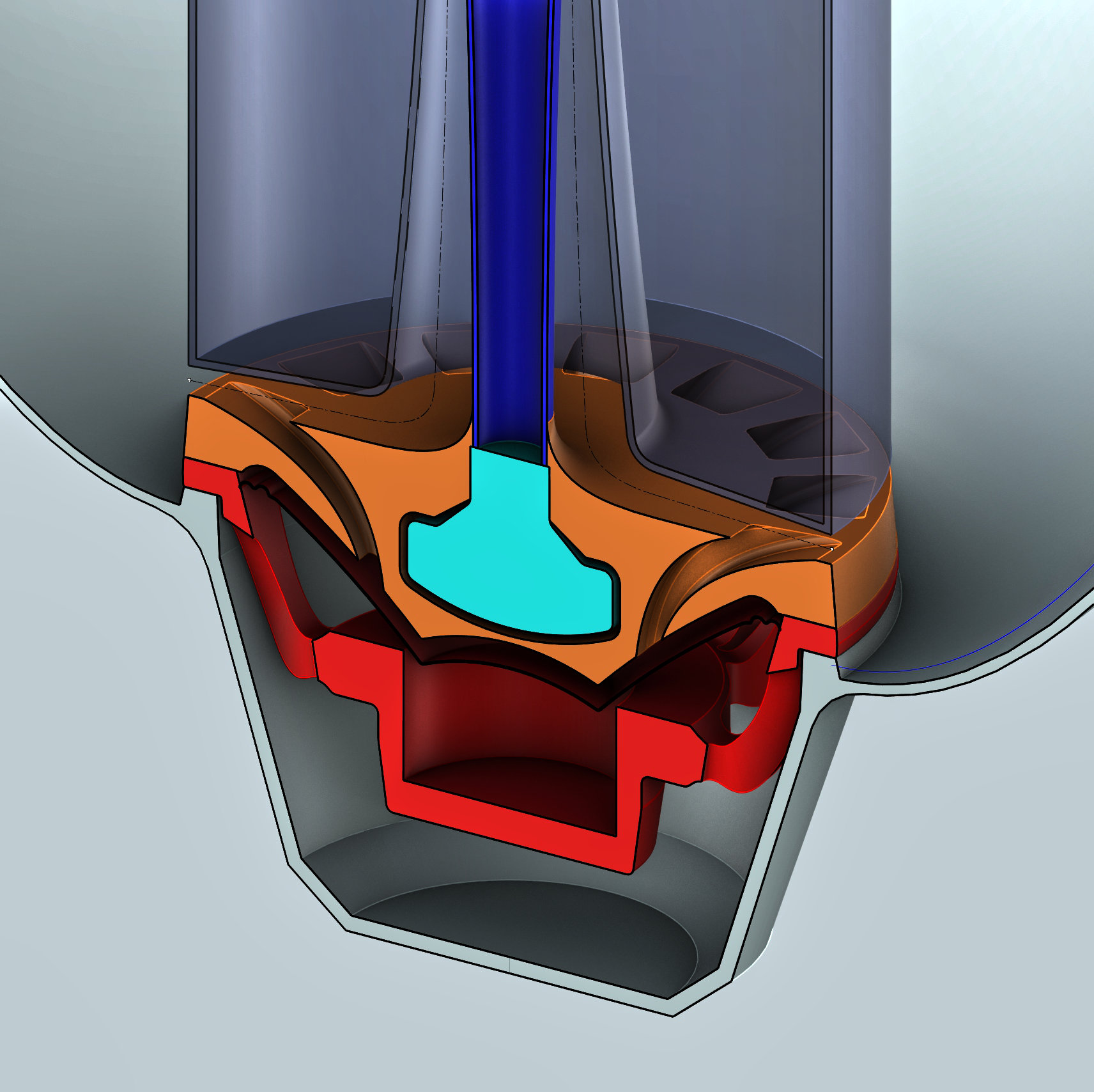

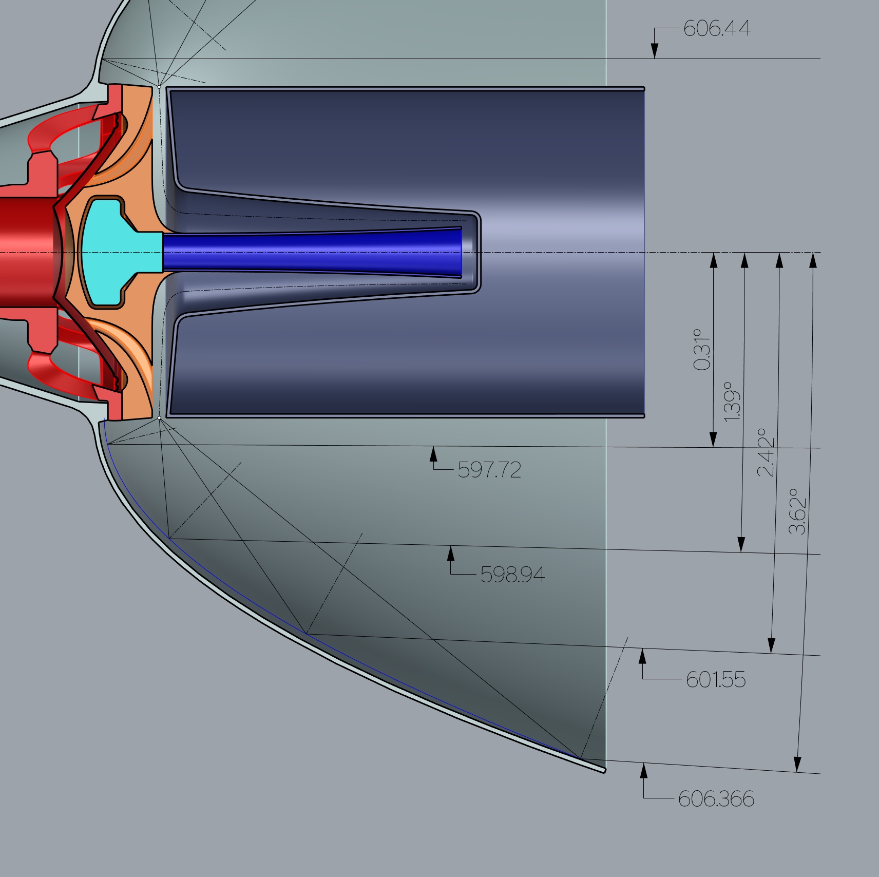

Sketch goal here, to use a larger diameter LF driver in parallel and employ the compression plug as in the Graber design.
The L transition maintains a steady volume around the 90-degree turn (estimated on the horn volume at that section, the goal of not compressing the volume around the turn.)
Horn compression driver size is estimated, the red bass driver is drafted at 8" diameter. The orange compression plug sends the LF out next the HF into the parabolic dish.
Dark blue surfaces denote the donor megaphone.

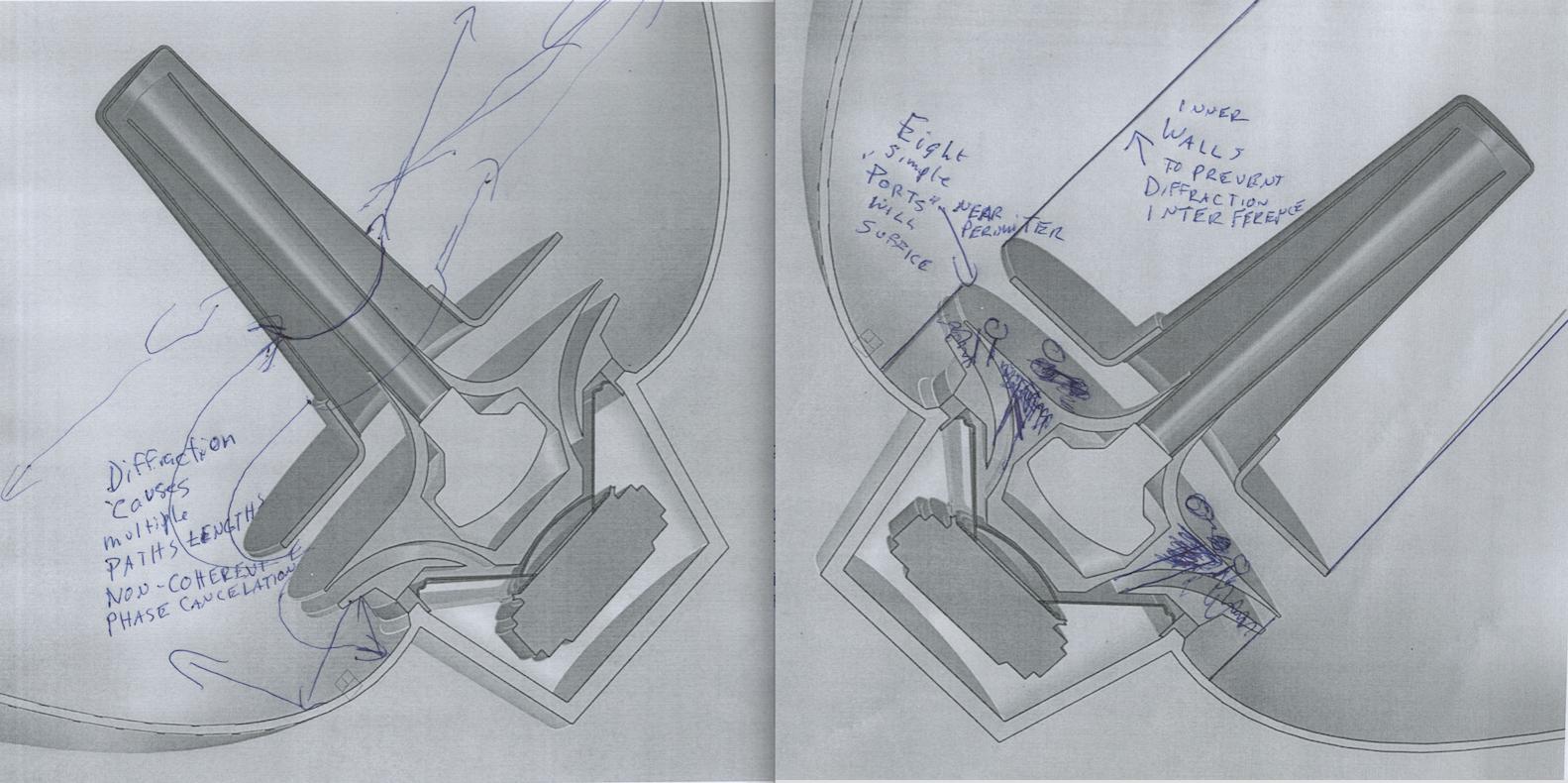

Stratotron,
Nice looking pictures!
The radial ring’s “mouth” should extend to the lower portion of the hyperbola and it’s terminus to prevent diffracted sound waves combining destructively (“comb filtering”) within the horn.
Parabolas and hyperbolas are both open curves. In the case of a parabola, the two arms eventually become parallel to each other, whereas in the case of a hyperbola, they don’t.
The hyperbolic curve is preferable for sound projection, as the area of the mouth must expand to be large enough to prevent diffraction of wavelengths longer than the exit diameter “spilling” out with no directivity control.
You have left out an element of the compression (phase) plug design, channels providing for equalizing the distance traveled from the inner radial inlets to perimeter outlet exits.
In your two-way design, that feature is less important, as the LF driver will only need to reach to 500-1000 Hz.
Output through the ports in that frequency range will be well under 1/4 wavelength of each other and sum constructively from a cone with only an 8” diameter.
Rather than exiting through a separate “ring”, the ports could be placed in the HF horn’s radial ring.
Minimizing the volume of the throat chamber (the volume of air between the cone and filler plug) is important, as the volume increases, the acoustic band pass it creates goes down in frequency. The distance between the filler plug and cone should be greater than the driver’s Xlim (usually around double Xmax) to prevent contact at high excursions.
The shorter path length from the LF in relation to the HF driver will probably require it’s output delayed to time align and sum constructively. It is possible to sum constructively using a passive crossover if the phase response is in alignment at the acoustic crossover point, though the LF still will lead the HF by one (or more) wavelengths.

Art, thanks for taking the time to sketch over the drawing, super informative and much appreciated!

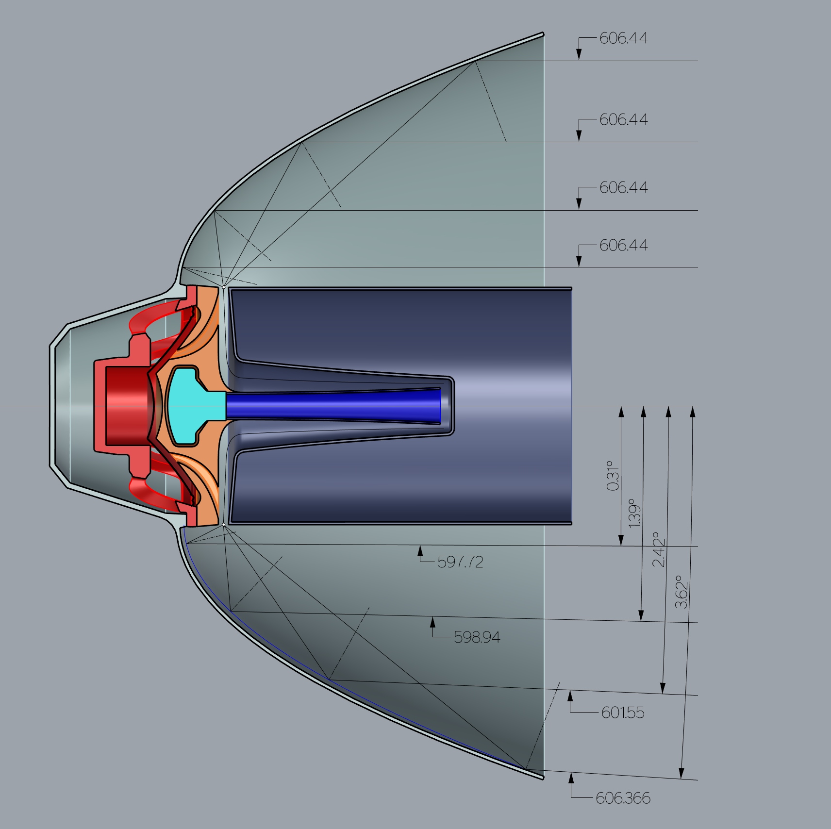

I've incorporated the concepts into a new sketch. One alteration is the width of the L channel. For focus I'd like it to have as narrow as possible an exit, without constricting the flow. To get there, I have drawn the centerline of the horn walls and measured the cross-section area perpendicular to that line. As the diameter increases, the width decreases so that the net cross-sectional area is slightly increasing out to the edge. ViewCapture20210905_comp.jpgViewCapture20210comp.jpg
I've drafted based on a B&C 10NW64 10" Neodymium Woofer, the compression plug can use the extra space to get around the HF driver. Since this is meant to be portable, weight savings is important.

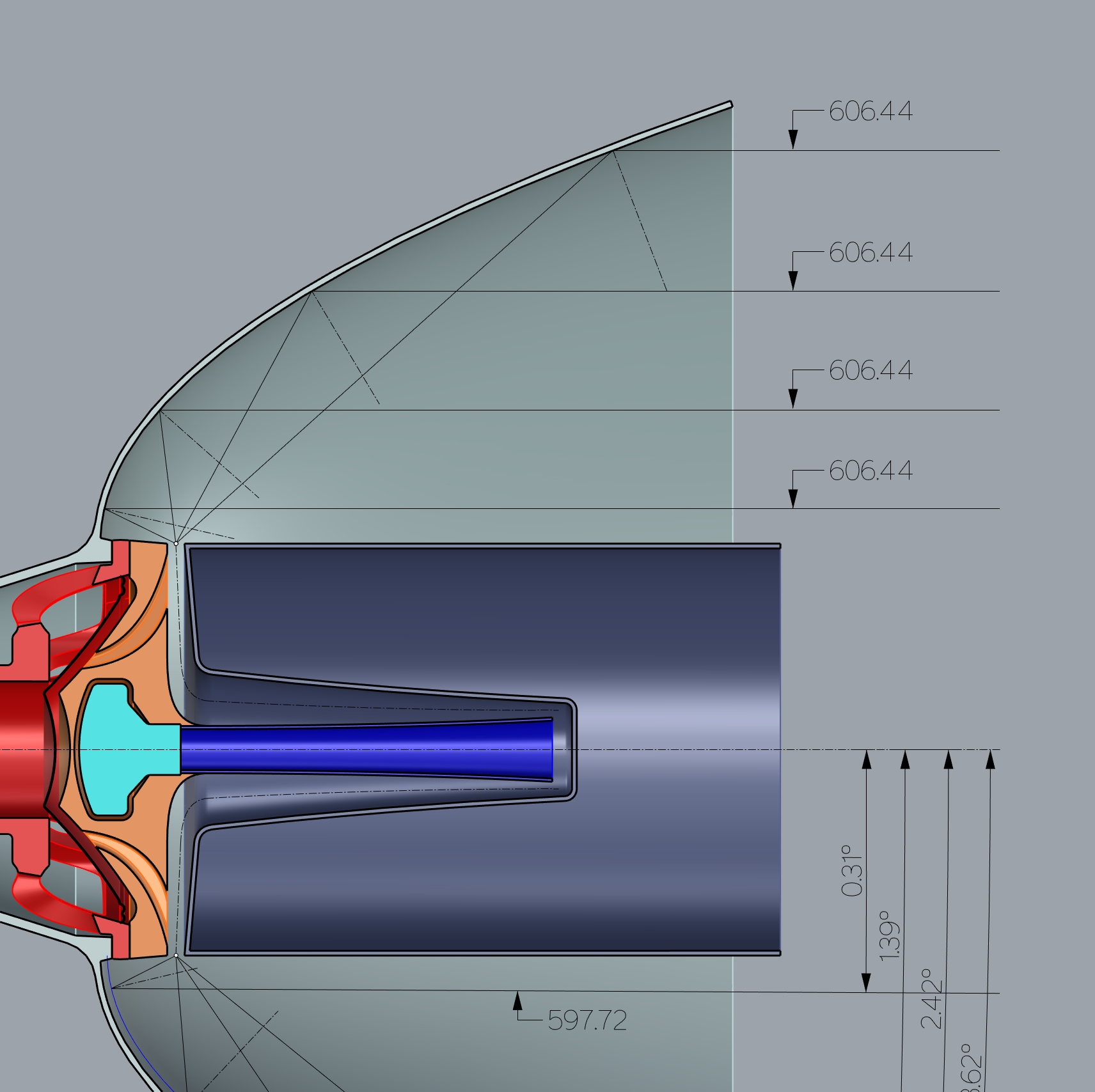

Concerning parabola vs hyperbola. I am drafting with a program called Rhino3D. It has tool for generating both types of curves. The focus point drives both of the curves. In the images there is a white dot at the center of the mouth of the exit ring. This is focus point of both the parabola and the hyperbola blue line. I matched the width ends for this test. I have done other test but they all have the same result.
I chose four points along each curve. Drew a line perpendicular. Drew a line back to the focus/exit point. Reflected/mirrored that line about the perpendicular. Extended those lines out a distance and cut them all off at an arbitrary even length. The parabola lines are parallel and equal in length, indicating a plane wave. The hyperbolas all have lines that spread slightly and are not the same length when they reach a given distance. I am depending on the math of the CAD program to generate the curves, it is a program that takes its curves seriously so I trust it.
ViewCapture20210905_162945.jpgViewCapture20210905_163008.jpgViewCapture20210905_163039.jpg

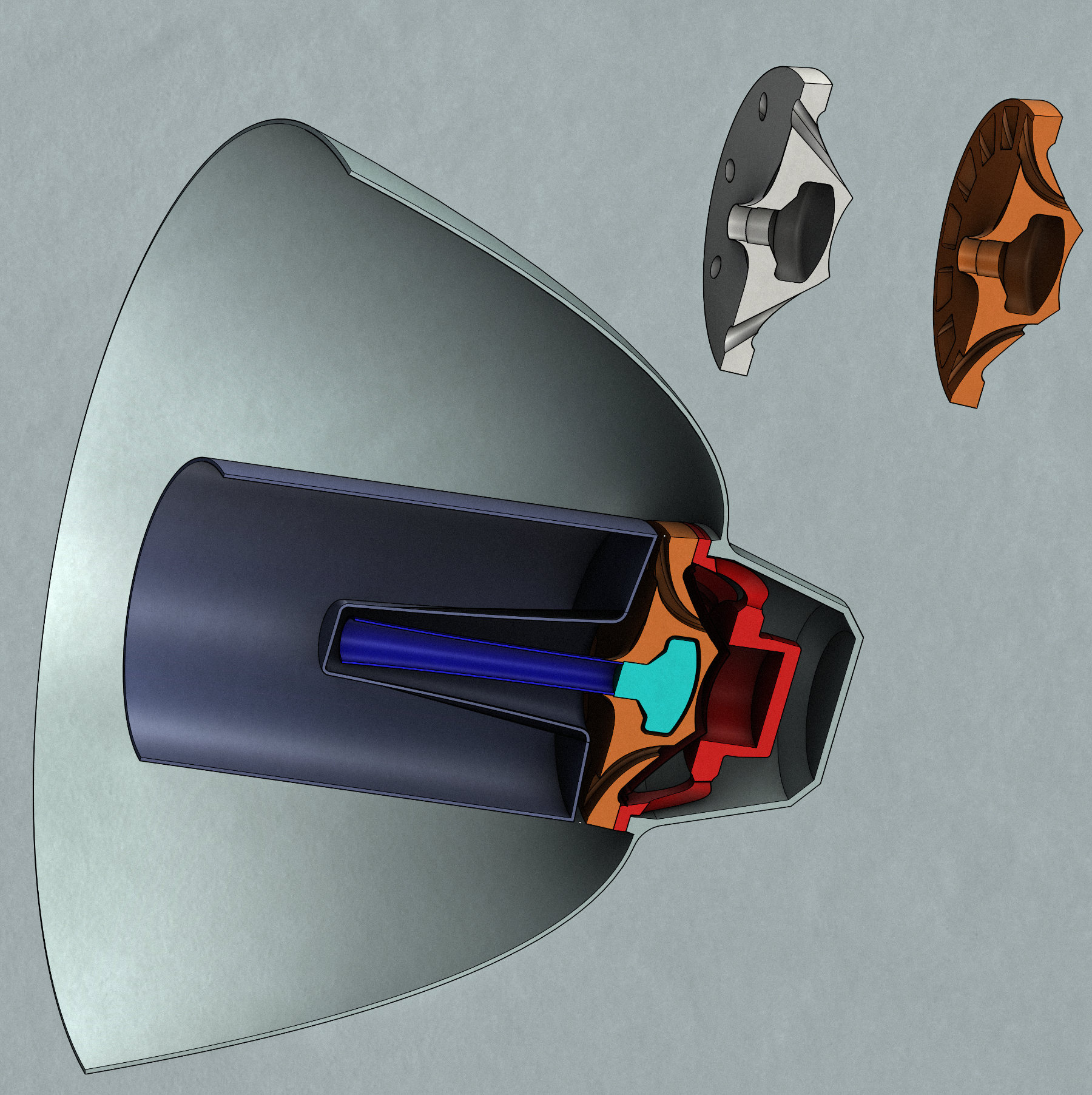

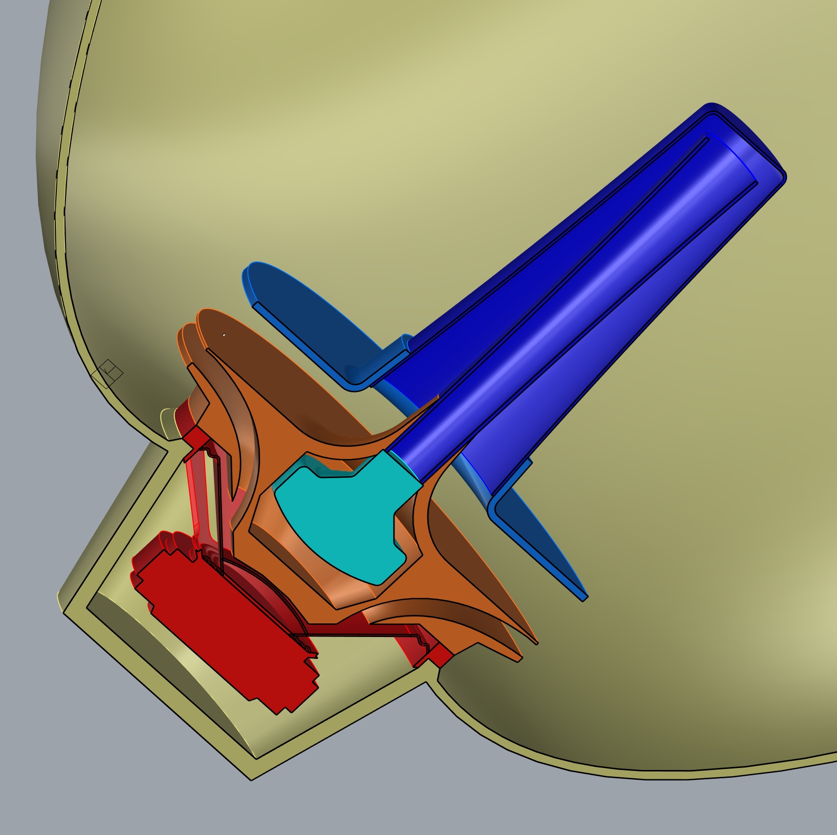

I've drafted the compression plug with the appropriate spacing, one with your recommendation of eight holes, and one with more channel volume and directing curvature. I do not understand these at all, so just going by gut feel.
Thanks again for the feedback.
The straight hole port arrangement would work better than the complicated one that will mess up the HF horn's response 😉
The profile width/depth looks similar to my Hyperboline, which did well down to 200 Hz as far as pattern control.

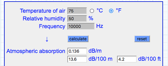

Also understand that air absorption (and diffraction) of very high frequencies limits the effective distance they carry, even if the theoretical drop per doubling of distance is reduced from -6dB to -3dB.
https://sengpielaudio.com/calculator-air.htm
Whispers sound like whispers primarily because they have more high frequency content than normal speech, so the further from the source, the more they will sound like whispering through a pillow.
At 100 meters, the HF content may sound less than half as loud relative to the lower frequency content.
