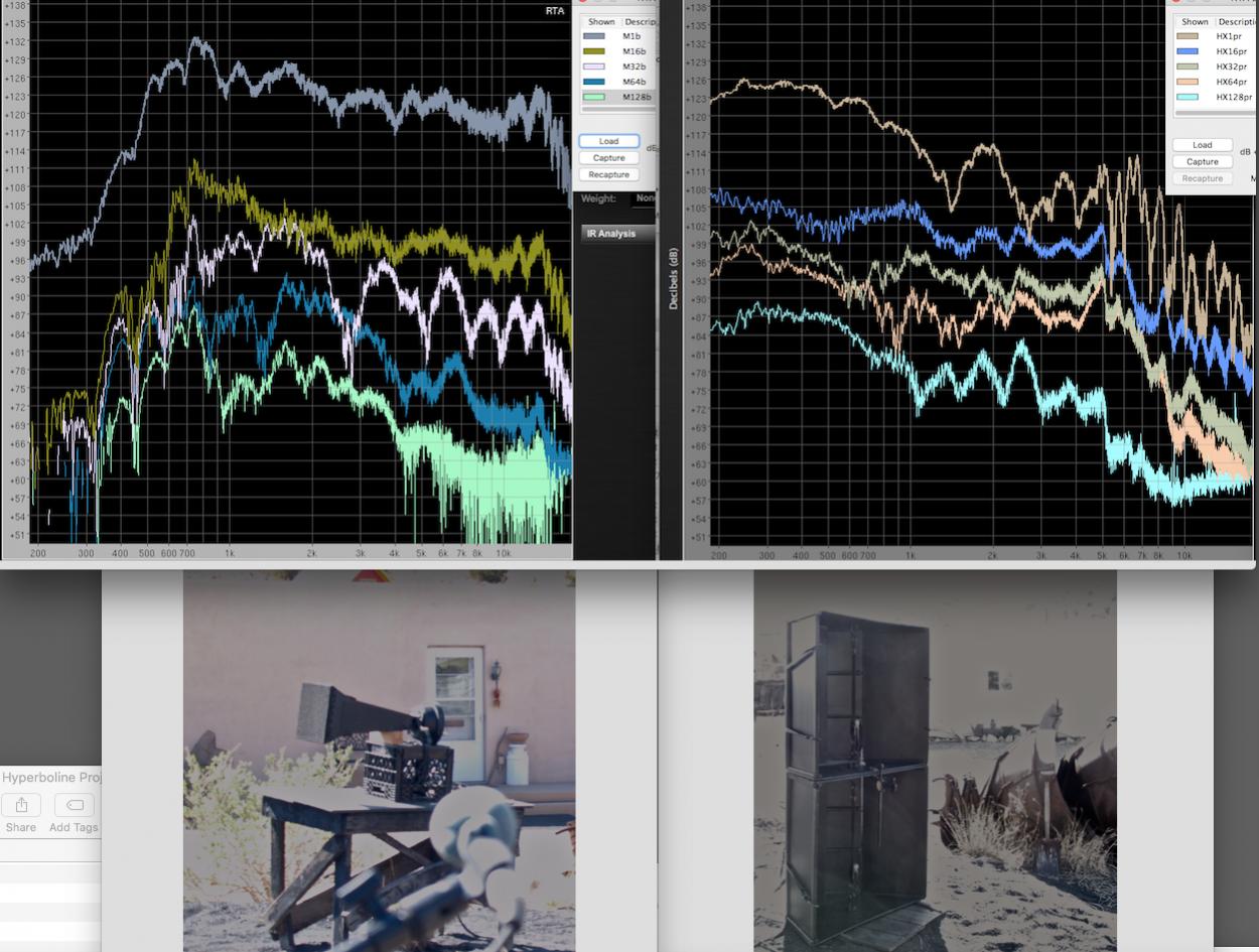

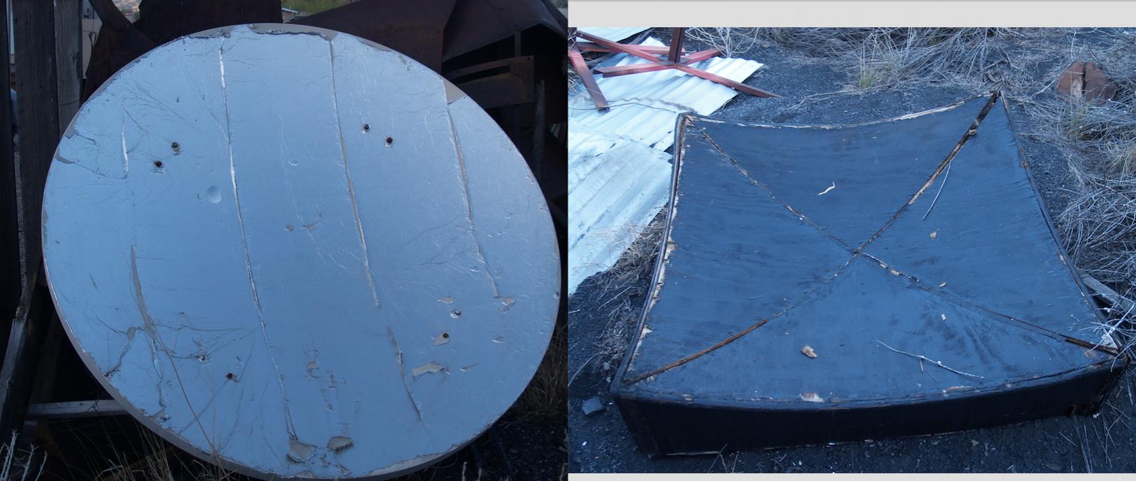

I have tested the Maltese horn with a 6 foot diameter parabolic dish, (and a plywood 45" x 45" version) it resulted in about 6 dB less inverse distance loss compared to the horn only.
In post #14, I provided a link describing the Hyperboline, it shows a comparison between it and a Maltese horn taken under the same (bad) conditions. The Hyperboline had about 10dB less attenuation over a distance of 128 meters compared to the Maltese horn.
To put that in perspective, a parabolic or hyperbolic reflector/projector could sound less than half as loud at the source (Focused4Door's roof) to achieve the same level at a very long distance.

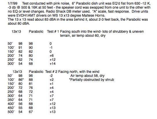

The attached test from 1/7/1999, though very basic, shows real world results- the very narrow 13 x13 degree horn at about 122 dB at one meter (98 dB at 50') dropped into the wind noise floor at 300 feet (into the wind) and 400 feet (with the wind). Using the parabolic dish, the sound level remained more than 12dB above the wind noise at 300 feet (into the wind) and 500 feet (with the wind).
Later that month, used the parabolic device (a 45" x 45"plywood version) for PA announcements in a 50' x 300' long tent during the 1999 Alpine Ski World Championships held in Vail Colorado.
The announcements could be heard above the ambient crowd noise at the tent entrance, about 240' distant, while patrons waiting in a line that stretched that distance waiting for commemorative pins could still easily converse only 10' from the device, which was only sitting about four feet off the floor, directed up for "bounce" off the tent ceiling at about the half-way point.
Funny event, provided PA for comedians, puppet shows, and bands, there was probably no more than 50 people there ever, until the pin giveaway, when 500 people would line up, then leave...

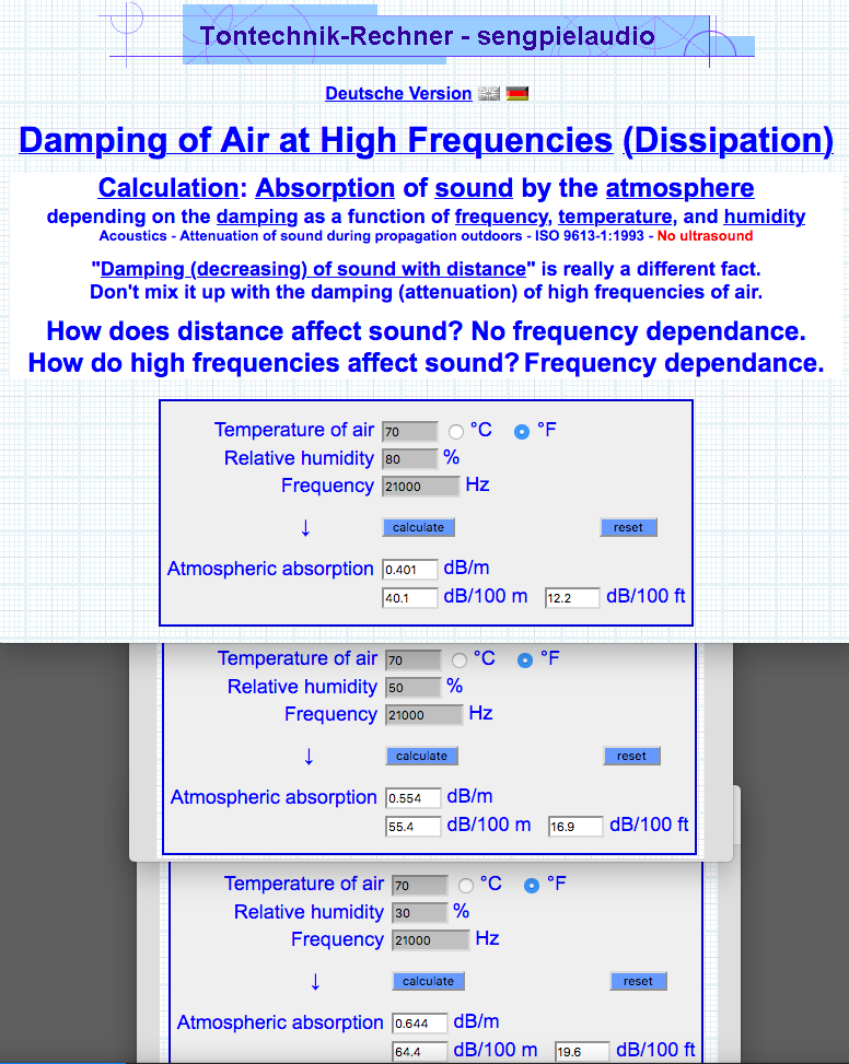

The OP, Focused4Door is looking for projection of around 450 feet.
Using this calculator:
Calculation method of absorption of sound by atmosphere air damping dissipation absorbtion high frequencies attenuation sound during propagation outdoors outdoor - sengpielaudio Sengpiel Berlin
We see if a 21kHz carrier wave is used, in addition to the normal inverse distance losses (50+dB) , an additional 55 to 88 dB loss (humidity and temperature dependent) would be incurred compared to normal speech range, putting the output level at that distance below audibility over any ambient noise.
