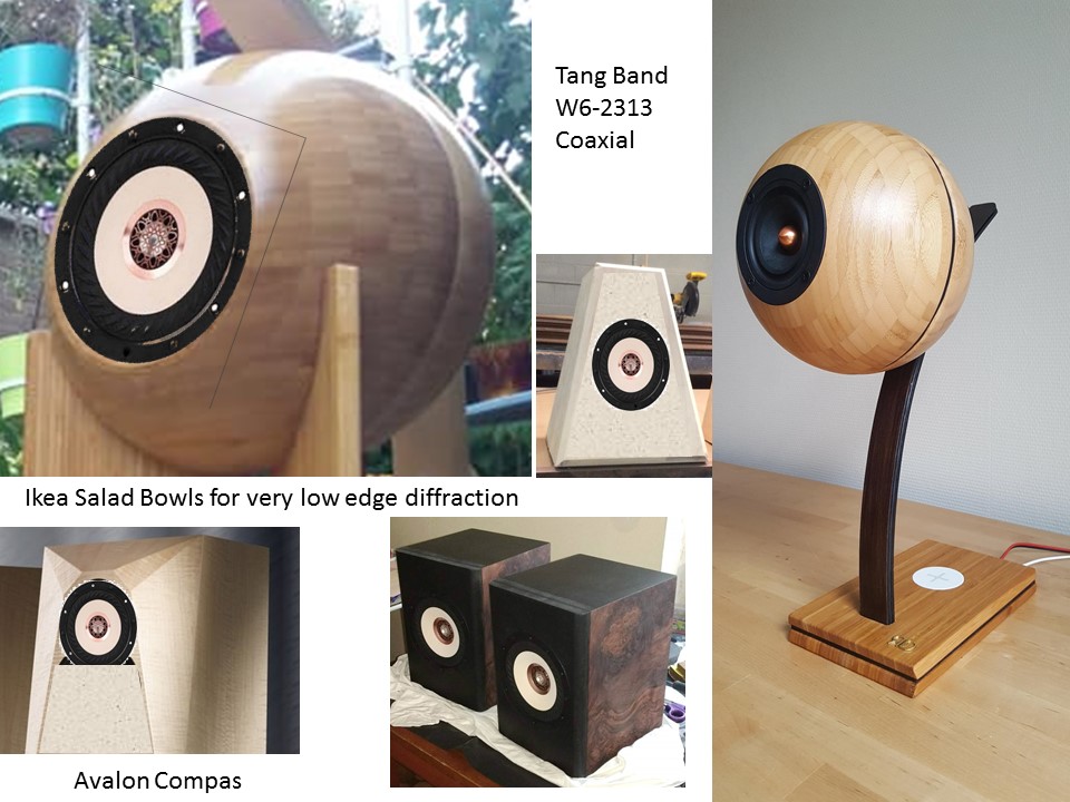

...Kef HTS3001SE eggs. They have a 4.5" cone, and are coaxial.
That is one of the coaxes mentioned earlier, and one i did an alternate box for. Being a coax, get the XO right and many of the issues of an XO in the critical range go away. The little Tannoy should work well too (i believe Moray has some really good things to say about them).
A couple of 3" drivers can't move enough air to hit 40Hz with useful SPL
One has to work really hard to get bass out of a 3”. These probably do the best, and will reach near 40 Hz, whether it can move suffiicent air for you is another question. I realisticly suggest about 60 Hz.
If that is sufficient bass is very much a personal thing, abouve 100 Hz or so near field they can be quite stunning, and few multways at any price will ha as coherent and seemless. Also, do not think that HF dispersion is any worse than most domes, the 19mm duscap does an admirable job of the HF.

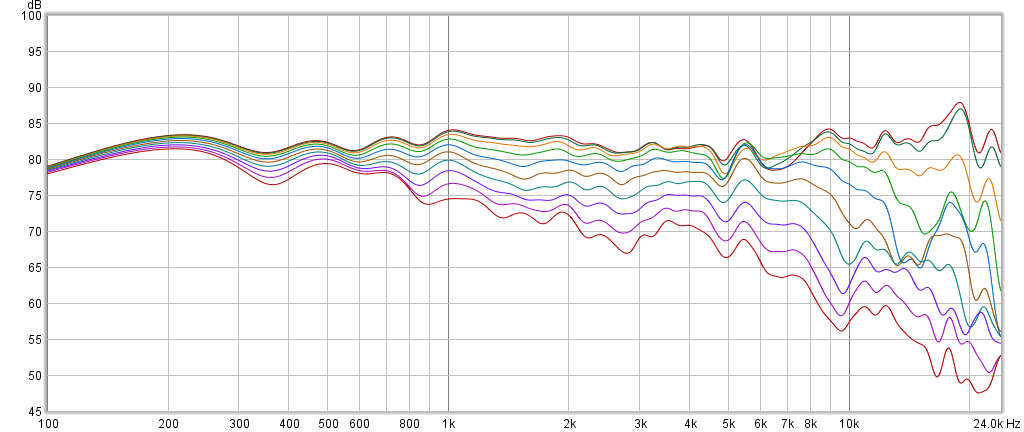

Here’s a pair of 6.5” coaxials from DIY Sound Group that didn’t end up going into production.
Measurements below
HF driver is a 1.75" titanium compression driver with copper cap on the pole.
Woofer T/S Specs:
* Piston Diameter = 134.6 mm
* f(s)= 85.46 Hz
* R(e)= 5.20 Ohms
* Z(max)= 56.26 Ohms
* Q(ms)= 7.551
* Q(es)= 0.768
* Q(ts)= 0.697
* V(as)= 5.519 liters (0.195 cubic feet)
* L(e)= 0.45 mH
* n(0)= 0.43 %
* SPL= 88.41 1W/1m
* M(ms)= 17.87 grams
* C(ms)= 0.19 mm/N
* BL= 8.06
Could be used sealed in a 0.25-0.5cuft box for an f3 of ~90-100hz.
Or can be used ported 0.35cuft tuned to 70hz (f3 ~ 60hz)- 0.5cuft tuned to 60hz (f3 ~ 50hz).
