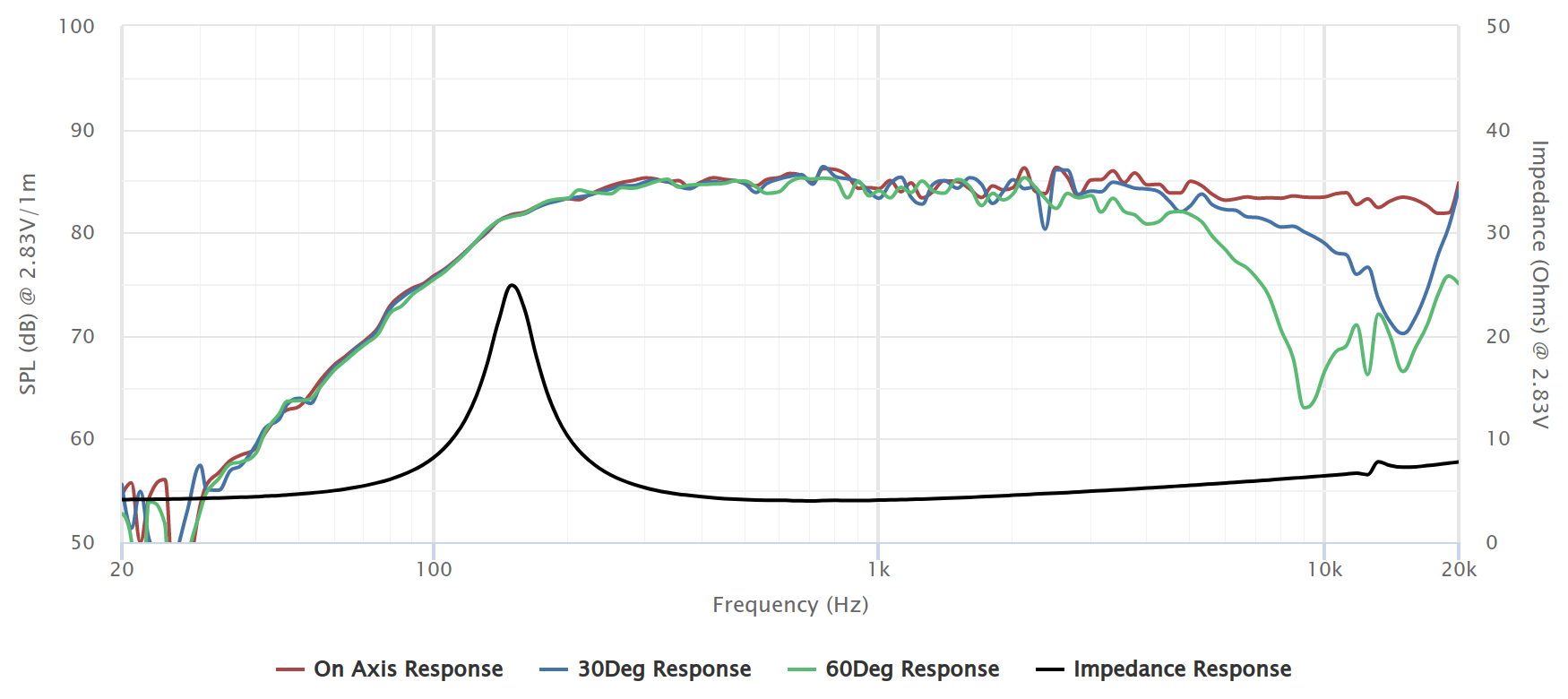

If you take an office chair and position it where you toes just barely touch the baseboard of the wall in front of you with your legs at a semi relaxed angle, now imagine speakers mounted flush in that wall, but with a huge room behind the wall for your enclosure to be built in. That is what I have.
If this build is for just one set of ears, you could mount the speakers directly on your chair.
That would give you an even closer listening distance.
Shorter distance = less demand on the drivers.
If the listening distance goes from 33" to 8", the effective SPL will be 12dB higher.
This means you could scale down from 4" full range to 2" full range.
Going smaller gives a flatter and more extended response (example attached).
Couple those tiny speakers with a compact sub directly behind your head and tactile transducers bolted to the chair, and you'll have a full range system that can sound like an earthquake to you, but is barely audible from outside.
