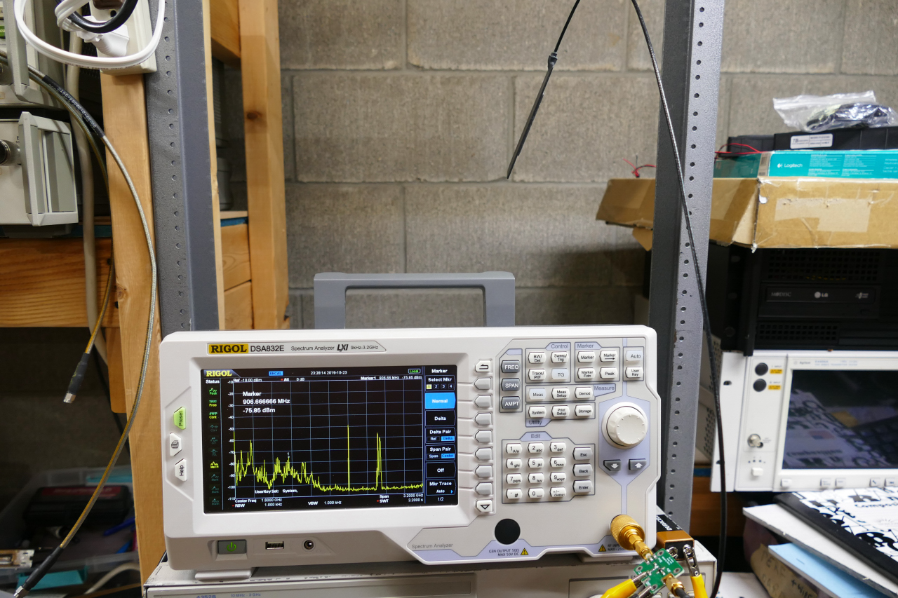

It's easy to sit back and talk....but a picture is worth...I don't know, with inflation, maybe 100 words.
I decided to do a 5 minute simple UNCONTROLLED, and therefore unscientific experiment. I performed similar experiments with far better equipment under more controlled conditions when I had Motorola's lab equipment and budget behind me.
Lesson learned....when you are standing in a field full of farm animals with a pile of test equipment on a cart powered by batteries and an inverter, be careful where you set your notebook. The goats will eat it and you will have to do all of the days testing over.

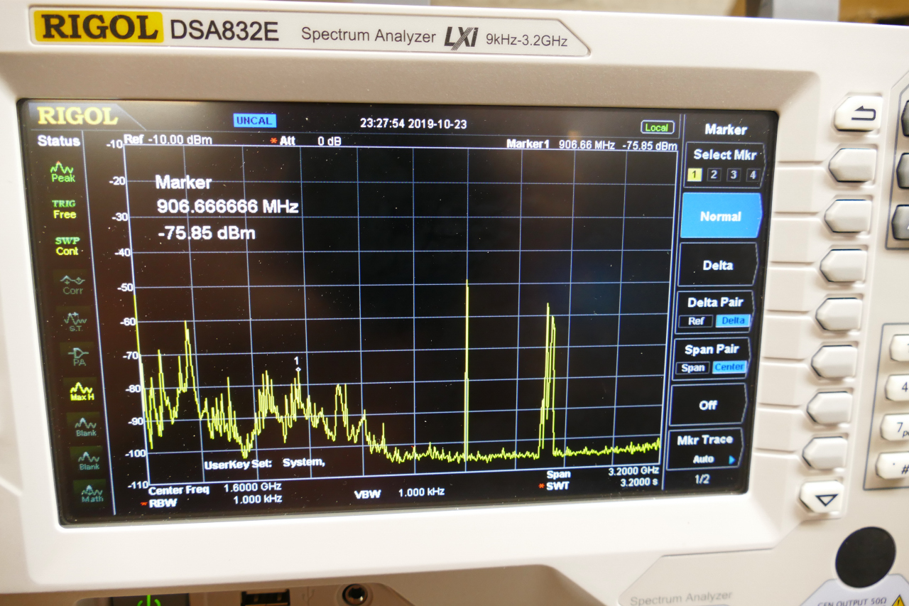

Here I simply fired up my spectrum analyzer, set it to sweep from 10 KHz to 3.2 GHz, and display the peak amplitude of every signal it finds in that frequency range over a 10 minute time period. In this mode a short burst for a few milliseconds will show at its highest value, as will a continuous signal. The continuous signals at lower amplitude will contain more total energy than short bursts at a higher level when both are averaged over time. Such a test can be done even with this analyzer, but it would take several hours. I an also in my basement lab, which is pretty well shielded from the weak signals outside the house. I have done this outdoors in my car, but I was concentrating on cell tower signals, and thus did not photograph any of the oddball RF stuff.
To extend the setup's dynamic range I put a cheap ($10 on Amazon) "30 db" RF amp in front of the analyzer. It does have 30 db of gain below 500 MHz, but it drops slowly to about 15 db of gain at 2 GHz and 5 db of gain at 3.2 GHz. The antenna I used is a flat plate designed for the US cellular bands. It's gain peaks at 800 MHz and at 1.8 GHz, with far less gain at other frequencies, but it was sitting on my workbench.
The test setup and screen picture are included.
The analyzer scans from 10 KHz to 3.2 GHz each division across the bottom of the screen is about 320 MHz.
The strongest signal on the display is at roughly 1.9 GHz. It is the random ping from my wife's iPHONE which is on a table about 20 feet from the antenna. It displays at -50 dbm on the analyzer, but the actual signal is probably about 10 - 20 db weaker due to amp and antenna gain.
The second strongest group of signals are the WiFi router, at 2.4 GHz. The router is about 10 feet from the antenna. My guess is that these signals are actually stronger than the phone pings, but the amp has little gain at this frequency and the antenna should be lossy at this frequency to avoid bluetooth interference.
Note the low frequency crud below about 1.2 GHz. ALL of this originates inside the house with one exception. The marker displays the signal from the smart meter. I have taken a portable spectrum analyzer to the meter to confirm the frequency.
Much of the low frequency stuff is leakage from the cable TV system. It goes away when I disconnect the cable from their distribution amp. Over a year ago I chased down some of the other unintentional radiators, and found that some of the TV sets radiate RF when they are turned OFF! The worst offender is an old Sony that was causing interference with ham radio reception on 146 MHz. There is a strong peak at 272 MHz. This is actually a bunch of single frequency signals scattered from 265 to 290 MHz and comes from the cable system. The antenna is I am using is not designed for these frequencies, but the RF amp has a lot of gain, so the actual signal level is unknown, but all of the crud averaged together over time could be the strongest offender here.

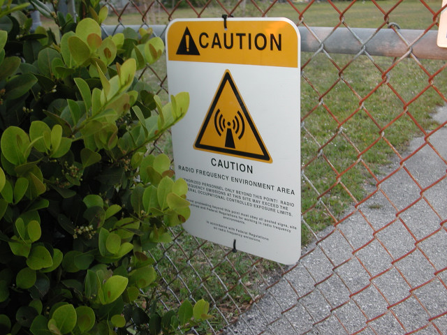

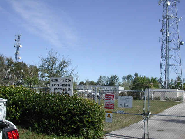

I am including some more pictures taken from the field where the "goats ate my homework." This was a 6 month exercise in chasing down interference caused by cellular systems to police radios. My final report on the matter ran 20 some pages and I had borrowed the title from a popular book / movie for obvious reasons......"The Two Towers." This particular location was the western most cell site in the area which borders on the Everglades swamp. The RF power for the west facing antennas was cranked up to the maximum to cover the 'glades. This was one of the worst interference related sites in the country at the time.

Stick an antenna on an RF spectrum analyzer and take it for a ride. I did this for years in my job at Motorola, usually while chasing down interference between different types of wireless service, often police and cellular, or TV and UHF two way radio. The worst RF environment I found in several years of doing this was at the upper level of the NFL football stadium in Miami Florida. Here you are up in the air and right next to the antenna farm for all of the Miami TV stations. Each TV transmitter has an Effective Radiated Power level from 500 KW to 1 MW, and there were 10 of them at that time. That location became one of our RF torture tests for new UHF radio equipment designs. I had other RF hot spots on the map for each unique combination of radio frequency bands we used.
I have also done it here in rural nowhere while trying to find a cellular signal strong enough to boost and bring into the house. There are far less RF signals here and all of them combined add up to less energy than the WiFi hotspot in the basement.
Other than the power grid, the biggies are the broadcast services, TV, AM and FM radio. In a densely populated area you may find a blanket of constant radio, TV and low level microwave (door openers at 10 GHz) and transient signals from the RF devices we use daily, and yes cell phones are quite strong when close by, but transient since the user is typically moving. Some of the newer cars emit radar in the 33 GHz region as part of the collision avoidance system, and this can be quite strong. Again, a transient signal that is largely reflected by the car you are in.
Standing under a cell or TV tower, you will find weak or no signals, since the waves radiate out perpendicular to the antennas up on the tower. The signal strength on the ground peaks at 1/4 to 5 miles away depending on the height of the tower, and the down tilt of the antennas. I have seen places where there is a cellular antenna on a tower near a tall building such that it is almost outside a window. This WILL provide a strong signal at that window.

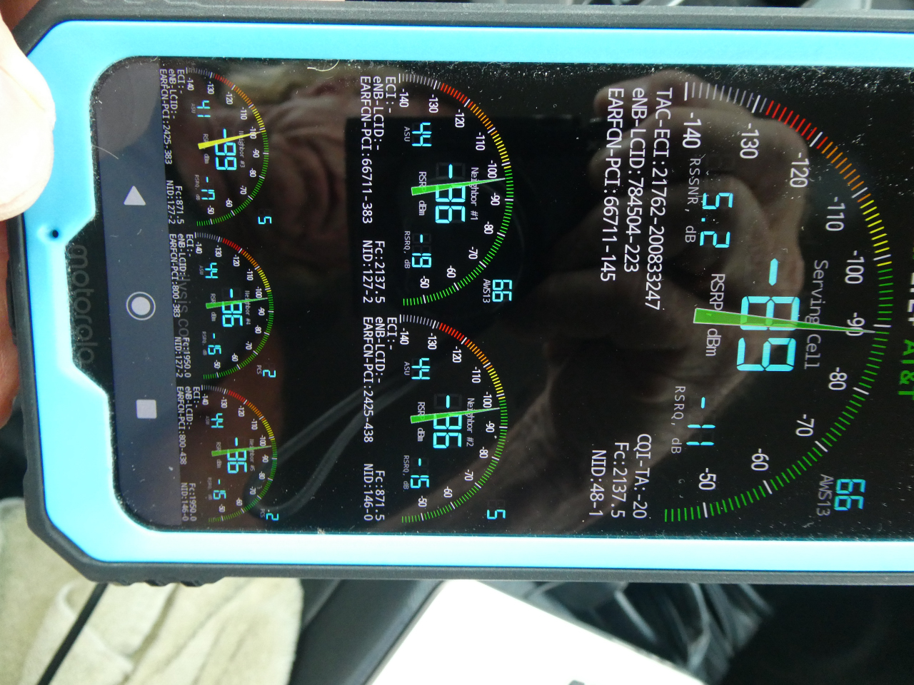

Here is a little more info for those who want to do some simple testing yourself.
Every cell phone back to 2G takes constant signal strength measurements on the cell it is receiving from, AND on several "neighbor cell" which the phone could possibly hand over the call to. Most phones / networks use different cells and frequency bands for phone calls VS data traffic.
You can get an app for your phone that will display this data. I use an app called Network Cell Info which will display the data for phone calls when you are actually in a call, and data traffic when not in a call. Like any app it can only display the data for the network you are actually authorized to use. My phone is on AT&T so it will show me all the AT&T signals that my phone is currently receiving. The spectrum analyzer has told me that AT&T uses band 30 at 2.3 GHz, but my cheap phone does not cover this band so it will not be displayed.
It will measure the signal strength. This is the power delivered from the tower to the phone, and therefore into the human holding the phone. This is displayed on a "speedometer" type scale and updates quickly ar you move through cell coverage, making it easy to find the towers. I have used this to find the two cell sites that serve my rural area. They are cranked up to somewhere near maximum power to serve the hilly country side surrounding the town. The tower site does not reach my house about 2 miles away due to severe blockage. The site on the building does barely on dry days, and in winter when the trees are bare. During the summer, I get no usable signal.
It is measured in dbm which is a log scale exactly the same as audio power. 0 dbm is a strong RF signal at 1 milliwatt of power. Each 10 dbm represents a factor of 10 in power, so that -10 dbm is 100 microwatts, -20 dmb is 10 microwatts, -30dbm is 1 microwatt, -60 dbm is 1 nanowatt, -90 dbm is 1 pico watt, and -120 dbm is 1 femtowatt.
Note that the scale starts (upper limit) at -45 dbm, thus the maximum expected signal from a tower will be less than 60 NANOWATTS.
I have found an AT&T cell site in town. It uses some flat plate antennas mounted on the side of a building approximately 60 feet above the street below. They can be seen in the picture. I drove and walked around the area until I found the strongest signal on the ground. The signal in my car was slightly stronger than the same spot walking. The strongest signal seen from the city site was -63 dbm or 2 NANOWATTS of RF power.
There is a tower on a hill about 300 feet above the city and 400 feet above the OHIO river. I drove nearly every passable road surrounding that tower measuring it's many signals with the spectrum analyzer and phone app. The strongest on ground signal was in the -84 dbm range, about 5 picowatts.

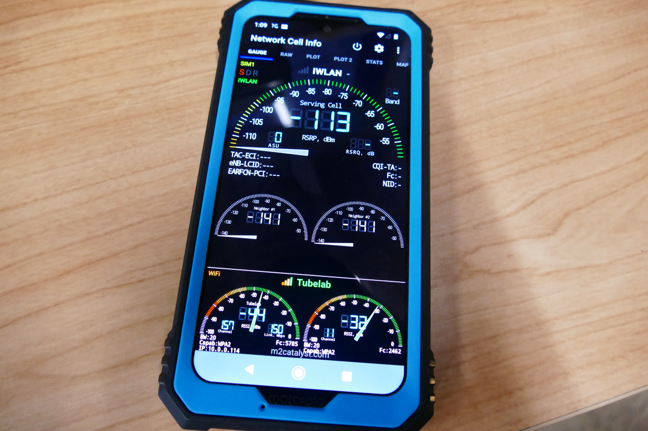

The same app can measure the signal strength of the WiFi signal that your phone receives. This photo shows that there are two WiFi signals here at my computer. The weaker one is the 5.7 GHz WiFi signal at -44 dbm and the
stronger is the 2.46 GHz WiFi signal at -32 dbm (about two microwatts). These signals are about 1000 times stronger than any cellular signal I can find on the ground today.
It has been stated that the signals from the tower to the user for 5G will be on par with, or weaker than the current 4G signals. 5G will operate in spectrum from 4 to 8 GHz. Why should I worry about some future signals which should be 1000 times weaker than what's in my house NOW!
