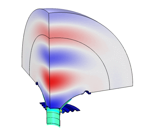

You can’t really compare such speeds I think. And resistive termination, while it helps mitigating effects of break-up, isn’t beneficial for the pistonic movement of the cone. You even could argue the break-up itself is not desirable, as it introduces nonlinearities. Or that the break-up should be damped as much as possible in the cone itself, such as still is unsurpassed in PP cones (what happened to them…).
What we can hear of such non-desirable behavior is of course another discussion.
Not - as you see that the membrane bulge, its in a bending wave mode...
Pistonic means what the name indicates - the membrane is completely stiff and keeps an unaltered shape through the whole motion - like a... piston 🙂
Well, if you think about it, no membrane is truly "pistonic" - that would imply infinite propagation speed for transverse (bending) waves. It's like saying that there's zero delay from one end of a piece of coax to another - it's just that, for low frequencies, in terms of the timescales involved, the delay is in effect zero. But at higher frequencies, you start to notice the delay, because it may present itself as an appreciable difference in phase.
If you read my post it says "this gif sort of illustrates how a non pistonic cone operates." You're saying it is depicting the opposite, a pistonic behavior? Where do you see that?Not - as you see that the membrane bulge, its in a bending wave mode...
For the case where the diaphragm is below its first mode resonance, I believe that force (and thus deflection) propagate through the diaphragm at the speed of sound in the diaphragm.Well, if you think about it, no membrane is truly "pistonic" - that would imply infinite propagation speed for transverse (bending) waves.

OK - my bad - sorry!If you read my post it says "this gif sort of illustrates how a non pistonic cone operates." You're saying it is depicting the opposite, a pistonic behavior? Where do you see that?
